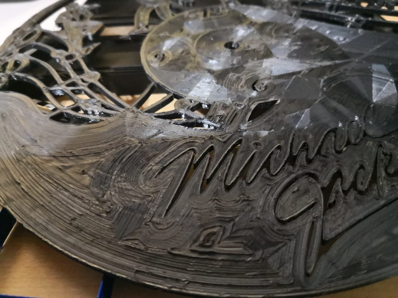

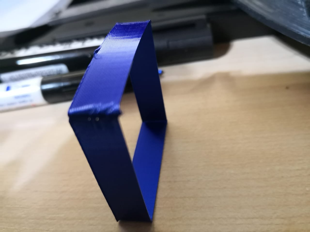

-The main issue is : at one moment during each print, the filament gets stuck in the nozzle, resulting in a quick underextrusion then no extrusion at all (pic n°1). When I remove the filament from the extruder, I can see it is gnawed by the filament feeder (pic n°2).

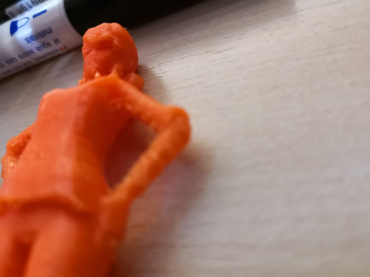

The two biggest problems are that the filament, especially the SILK, after a few minutes clog the nozzle.
What I could notice is that on the side of the wheel the filament is bitten and on the side of the nozzle it is thickened as if it had a drop (the filament is 1.75mm, it is the only option that they had in my country). In large pieces it is very rare that I can finish without being covered which is very annoying, since if I was waiting for 7 or 8 hours … then throw everything because the nozzle plug is exasperating.

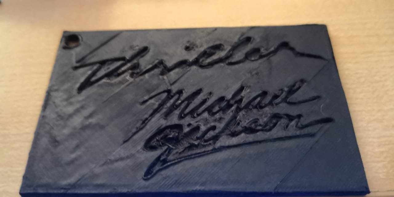

The second problem is that the surface has problems, the vertical angles are ill-defined, for a moment it is shrunken, for moment they drip outwards, also the upper layer has a very bad termination, there are lines below and above the expected surface lvl.
Typer, with your config, but with 20mm/s and 2mm for retraction (i have 1.75 filament) calibration cube prints ok. Good definition, good size… but then ill try to print a bigger model. And clog again 5 times… in total print of 4hs… i stay at side of machine, and didnt figure whats happening… I also read a post that you use DX setup in S3d… do you change any value to make it work? or simpy change x y z parameters?
