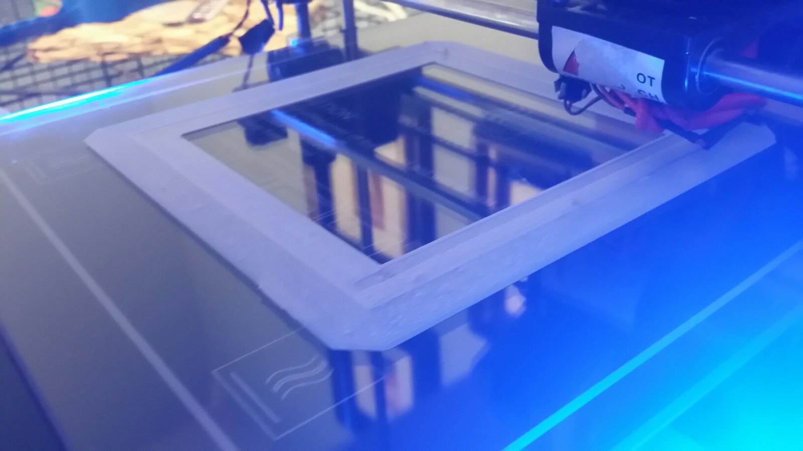

I’ve spent a lot of time dialing in my z offset and when I get just under the sweet spot I start to see this. Bells went off though because its only in one corner of the part. I have a Robo3dR1 printer with auto bed calibration and I have tried it across several different beds/substrates so I dont think it is a buildplate flatness issue.
From the picture, to me, it looks like the extruder is getting too close to the bed in that area and pushing the plastic out and up as it prints. I should also clarify. The corner closest to the camera has the issue. The other 3 corners are perfectly smooth and ideal for bed adhesion.

Hello Hilttech The picture is not so clear to me. It looks if you’re filament isn’t extruded very well in this corner. Maybe the filament is bent to much in this corner so the friction is getting to high. Try to extrude by hand and look if you feel a difference. Bert
Even though the picture is a bit blurry, it kinda of looks like the nozzle is too close to the build plate OR your trying to extrude too much materials. Both these situations can cause the plastic to “squish” out around the nozzle instead of laying down a uniform bead
I think thats true. My confusion though is that it is only in the +x/-y corner, all other corners come out correctly. This is true across multiple build plates so it cant be any non-conformance in the bed. Which just leaves the z axis threaded rods machanical defect (either in setup or material), z axis control (from slicer or arduino), or the auto calibration as the culprit.

It is definitely too close to the building plate in that corner but I can guaranty it is not an overflow of material.
Perform multiple bed calibration, note all the values and compare Them.
If your +x/+y corner average value is always the highest and the -x/-y, the lowest. Bed calibration might not be able to compensated for both.
What worked for me was to remove the bed and adjust the bed support. Solved my issue. Never came back.
Nick

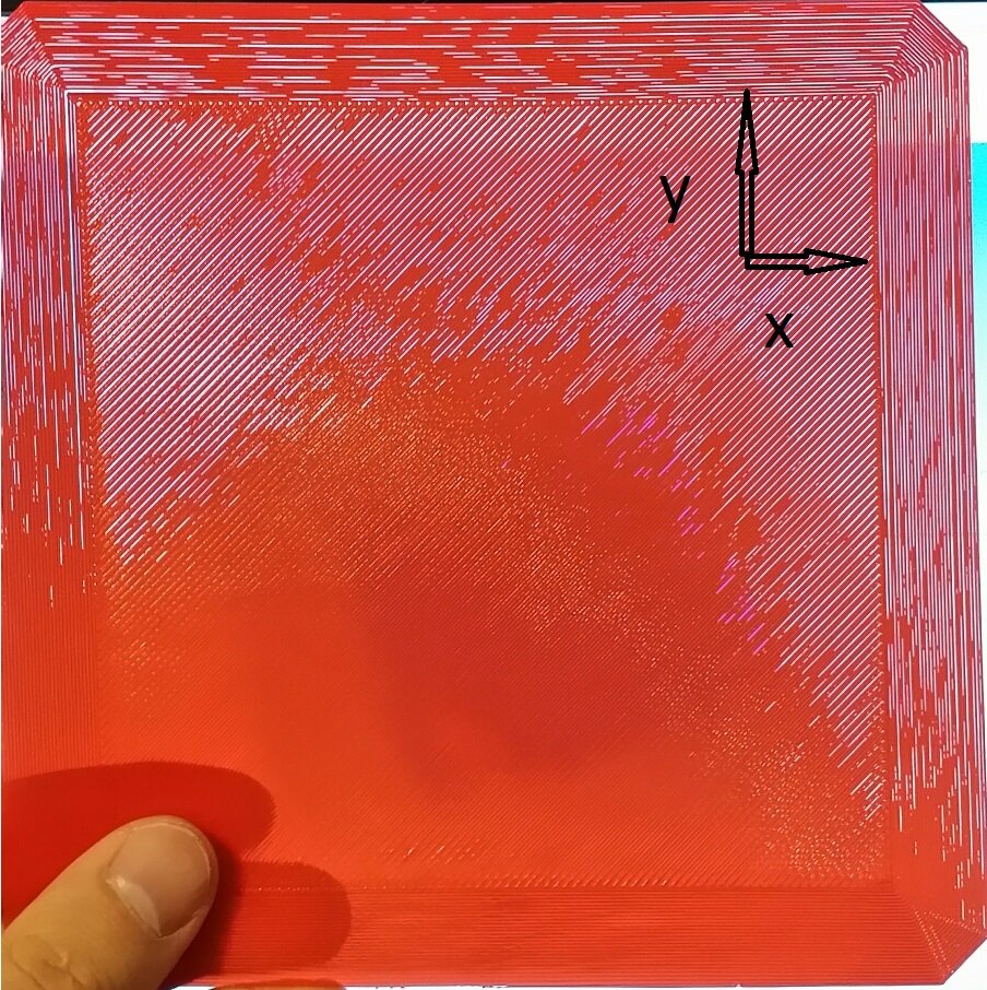

I printed a plate shown in the image below 5"x5"x0.3mm (1 layer) shown attached to this post. Clearly my y axis is off. I’ll try the paper shim technique listed in previous posts.
Also for reference:
Plate thickness
-y edge: 0.41 mm (0.11 mm oversized)
+x edge: 0.46 mm (0.16 mm oversized)
+y edge: 0.43 mm (0.13 mm oversized)
-x edge: 0.41 mm (0.11 mm oversized)
Yup! That’s exactly what mine was doing only towards the right front of the print bed! Your numbers look very odd, however. Seems like your print bed is warping upward in the middle, and dipping slightly lower on the left side compared to the right. Then somewhat leveling off on the back corners, while still remaining warped upward the the middle. Not sure what is going on here! I would start by adding paper shims to the front corners and see how the numbers change. Hopefully your bed isn’t warped too much that it is not correctable. The object is to bring all your numbers as close to zero as possible, and hope that the auto level does the rest. Did you do your first run fine tuning paper calibration cycle yet? If you have not done this it might help your auto-bed leveling to do this first! Are you using MatterControl?

I did the paper test to calibrate the x axis before the picture shown above. This is why its relatively symmetrical across the x.
I agree my numbers imply a convex bed plate but it says the same thing for the actual bed and the sitall bed I clip ontop of it. It seems odd that both would have the same warped geometry
