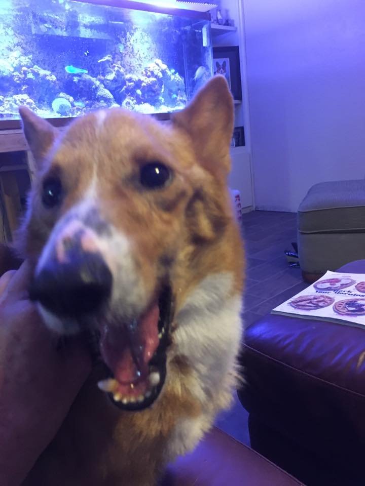

I am new to this and I might not even be in the right area, so if I’m not will someone please direct me to the right spot, please? I have a friend who runs a non-profit corgi rescue (Celtic Corgi Rescue) in Oklahoma. She recently had a young corgi brought to her who had a severe jaw problem. They assumed it was broken but found out after getting him to the vet that the problem was due to permanent nerve damage, and that surgery was not an option. He looks like he is constantly yawning and he cannot close his mouth; it is heartbreaking to see. He has lived over half his life like this so he is underweight but he has learned to eat and drink by flipping his head upside down. It’s obviously not working and the rescue is needing to find a permanent solution for him in order to give him a fighting chance at finding a forever home. This is where this group comes in… someone suggested a jaw prosthetic being made by a 3-D printer. He is a corgi so he’s not a big dog but he needs to be able to have a good quality of life. He’s not quite three years old yet but he is full grown and needs to be able to eat unassisted. We have no idea how to come up with template requirements for what the jaw prosthetic would look like. How do we even get started with something like this? Better yet, is there someone in this group that would be willing to help us put the template together and create the prosthetic? I am open to any and all suggestions. Thank you for listening and please let me know what you have!

To make a prosthetic work they have to nerves and muscles to actuate the prosthesis. We could make a replacement lower jaw but with the paralysis and nothing in the head area to actuate it with it would not be any more effective than his current situation. Let me think about this but I think it would be very difficult to design something a pet could eat with. We might be able to design something to support the jaw to limit how far it drops. This might help with eating but I think the dog is going to be limited to soft food softened with water. I think a jaw support and not a prosthesis would be the best approach.
I can design and print it but with that type of injury I think that is the best you are going to be able to do.
