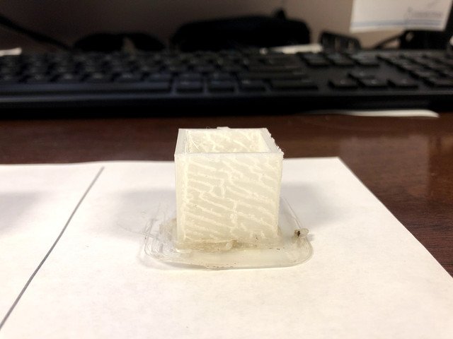

I have made several tests with several different settings, all the prints come out with varying differences of the same issue. Using PLA
Issues: (see photos)
  • on each print I get a blobbing or zebra striping only on the back side and left side of the print. - Opposite but consistently, The Brim gets chewed up or does not stick on the front and right side.
  • I also get webbing occurring from right to left.

Take a look at the photos - and please help where you can.
