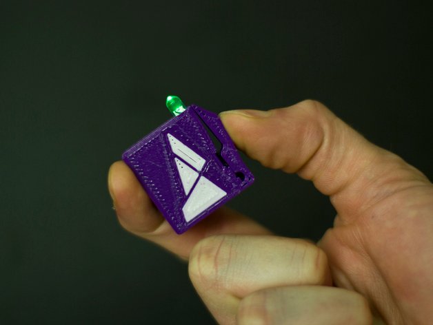

Conductive printing is possible. A dual extruder printer can print conductive material inside a plastic enclosure, such as this flashlight.
However, right now, this is in its infancy. The resistance is so high on the conductive filament that it is difficult to get too clever with your expectations of 3d printing electronic models.
