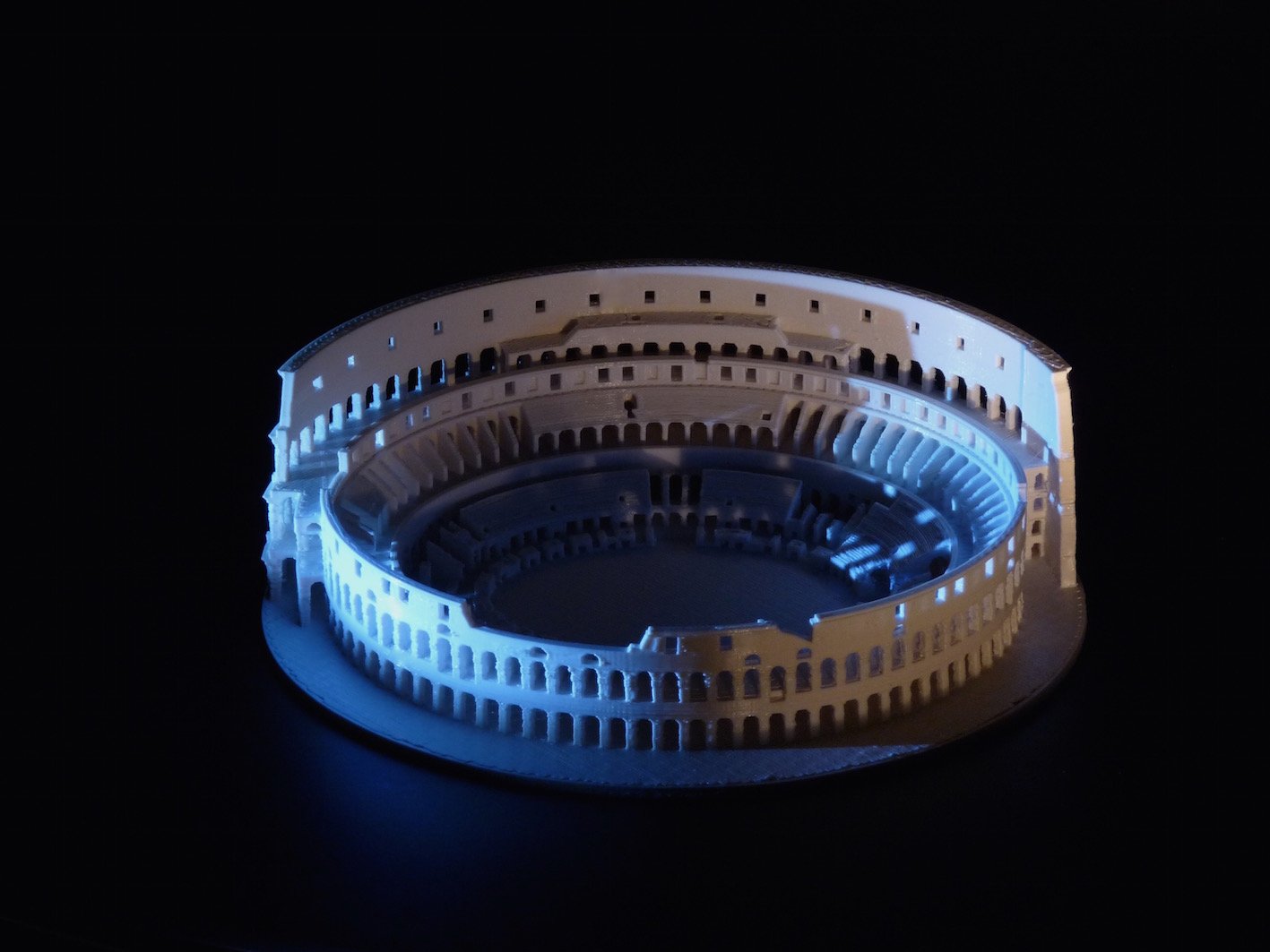

Printed the Colosseum with PLA polar white. 6.08 h, 93 grams, 207 layers. The filament got stuck twice, so the Robox paused and I manualy had to continue the printing. First attempt. To give you an idea of the printsize; plateau aprox 15cm, height 4cm

Admittedly, I’ve never seen the Colosseum looking this good :slight_smile: Awesome job, @DeGrazendeSlak!

Did your filament get stuck on the reel due to poor winding or was it another issue? Either way, you should open a support ticket if you continue to have the issues. Good job with the print!
Yes, it got stuck on the reel. Same problem with another print, the cactus vase (Thingiverse - Digital Designs for Physical Objects). It does leave a mark. I will open a support ticket, thx.
What filament are you using? i danced with the devil and tried some cheap stuff (NuNus and PrimaValue off Amazon) and they kept stopping, needing a push to get going again. Having now switched to ColorFabb and RigidInks I am having no problems (yet!). I note that the better filaments have a diameter tolerance of 0.03mm rather than a quoted 0.05mm with the others - although I think the cheap ones aren’t even as good as they claim.
I am still a bit puzzled by the Robox filament pricing though as they said they were only going to charge a small premium for using their EEPROM reels, but it is a similar price to the other European suppliers for 700g instead of 1Kg, which I make a 43% price premium. Otherwise I would be using theirs all the time, if for no other reason that how neat the machine looks with the reel inside it rather than on some ugly spool extension thingy.
CelRobox PLA polar white on smart reel. The filament itself is not the problem, it gets stuck on the reel.
With the next attempt I will reduce the print speed.
definitely do leave a support ticket.
the cel-robox support people are very helpful.
