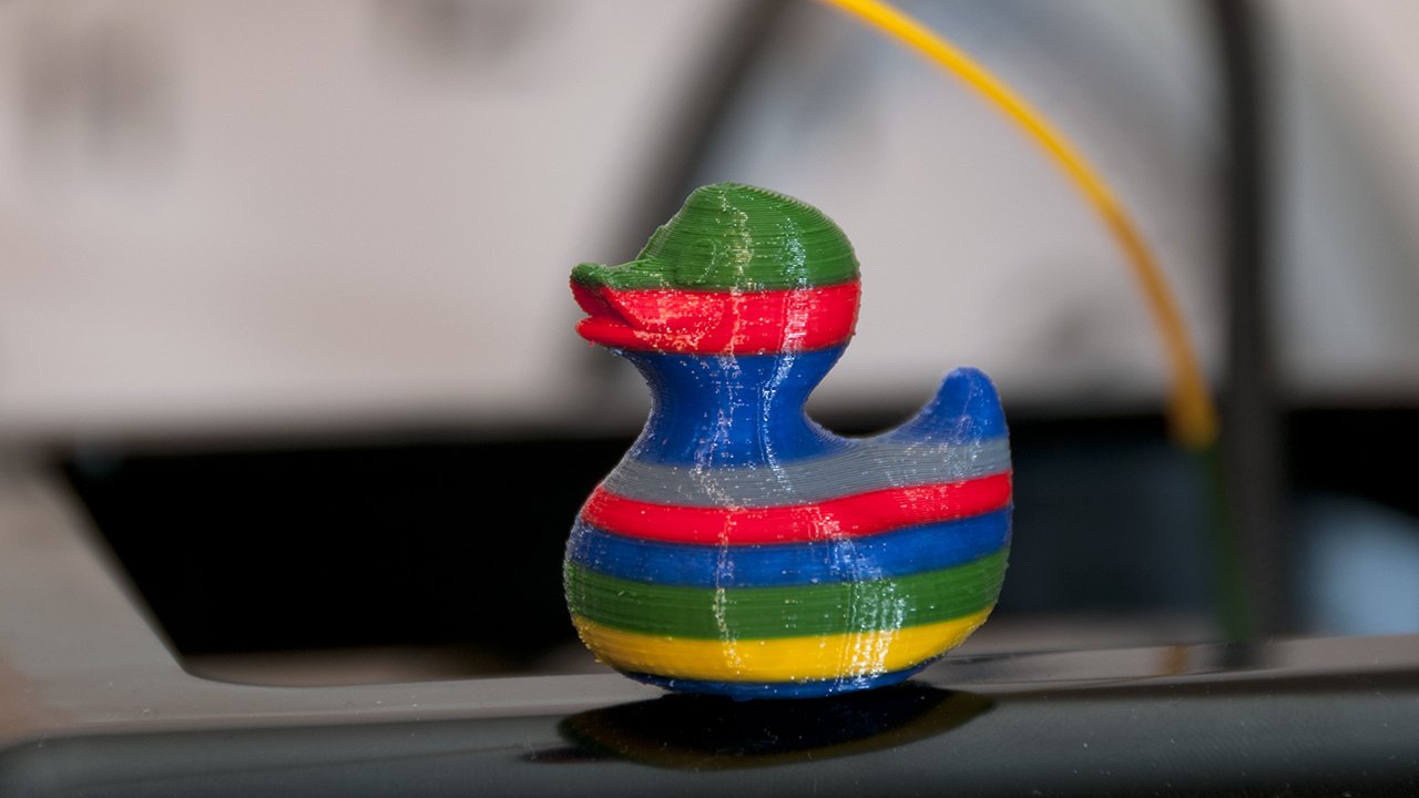

Hi – yes, it prints fine on the Micro in my experience. I can’t remember what temperature I used but it was something around 200C - 210C. Here’s a stripy duck I did a while ago on my Micro (by welding together lengths of Colorfabb samples using a soldering iron and a length of PTFE tubing :slight_smile:
Colorfabb prints on the Micro look really good – the colours are somehow very satisfying.
