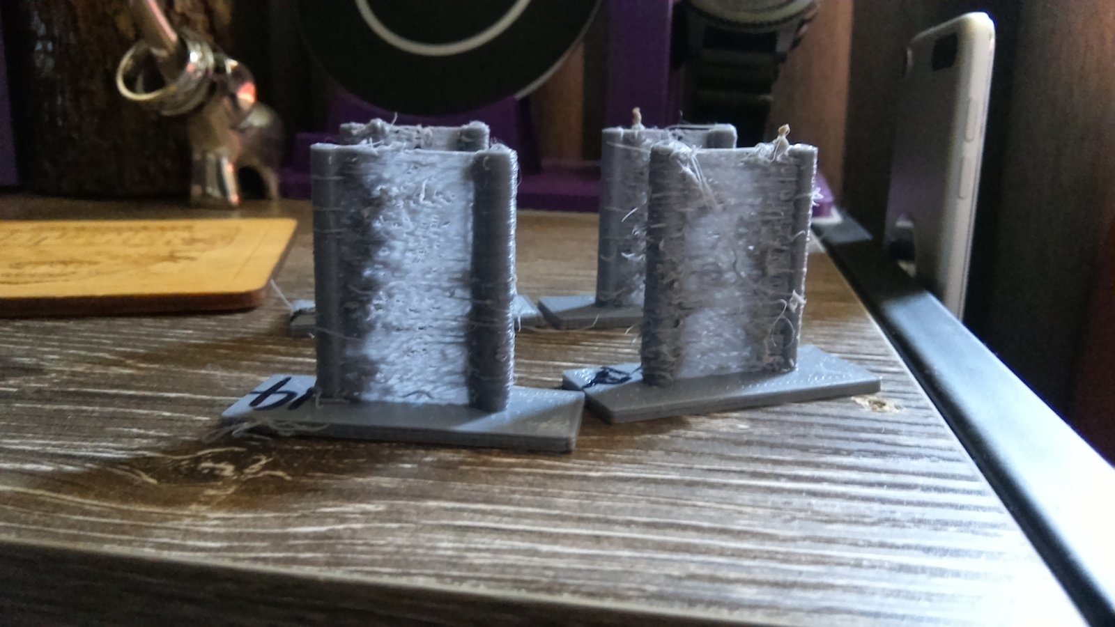

So I updated to the ADVI3++ firmware now i am having no end of trouble with stringing. I have done 18 retraction tests and they all seem to come out the same no matter what changes i have made in CURA.
Using PLA not that old, .4mm nozzle settings are .2mm, 100% infill
retraction ranges from .5mm to 7mm, retraction speed ranges from 5mm/s to 70mm/s, travel speed 100mm/s to 170mm/s. have readjusted the cooling fan, tried coasting, adjusted accelaration and jerk setting, PID tuned, steps calibrated.
should i just go back to stock firmware? Any advice would be greatly appreciated.

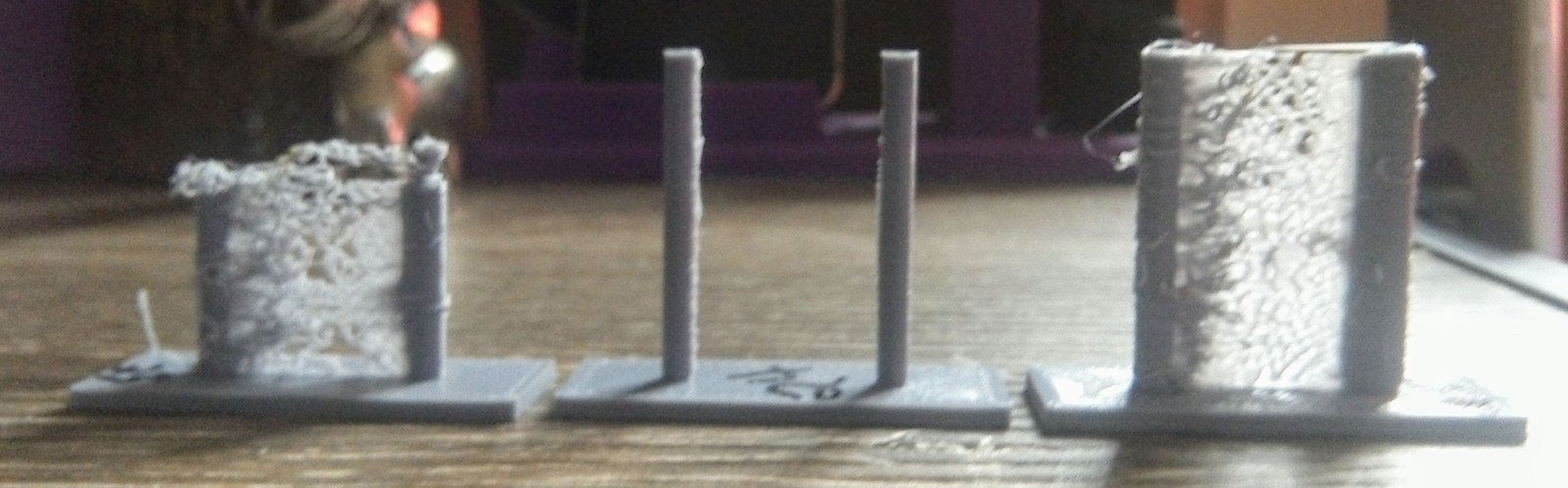

Ok so I tried a few different test and no changes until no filament. I sat and watch closely and thought that i didn’t notice anynretractions at all, so I sliced with slic3r minimal editing and perfect so i uninstalled cura and reinstalled and started feom scratch used the settings i used in slic3r and no change.
Looks like i am going to use slic3r from now on.
left pic cura 3.6.0, middle slic3r, right reinstalled cura 3.6.0.
really strange!

Cura just wasnt retracting for some reason.
hmm, I still am running on Cura 3.2 or something, but my pc has 3.6 as well, so maybe the fault is in 3.6. When I get home from work; i’ll search for the cura I am using on my laptop since that works like a charm maybe you can try that.
If that works we can submit a bug to ultimaker
