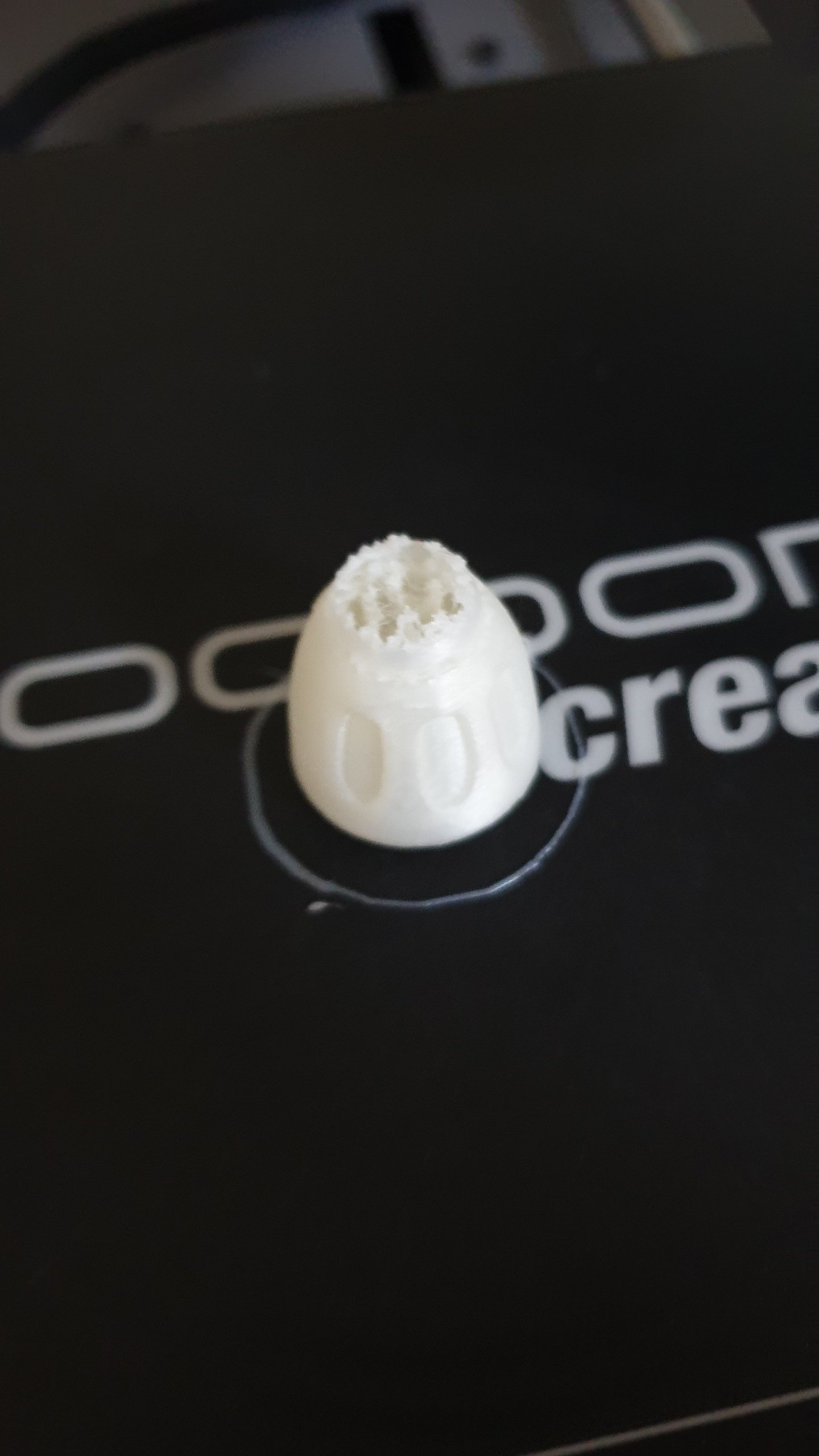

I currently use a cocoon create 3d touch and sometimes the printer won’t fill the first layer’s surface at all. My prints start out fine with the outline but then it stops extruding filament while still moving around when printing the center parts. Please Help!!! :frowning:

Tried 215. I still have the same issue. It feels like at some point the filament doesnt go al the way in, so it doesnt supply the extruder with enough filament. Cause filament usually starts to go out at around 200 but after failed print nothing goes out and I have to manually push the filament in so it starts to come out
