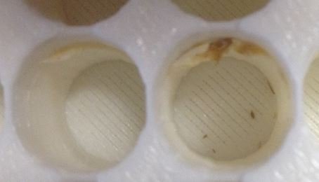

You can see the material that came off in the picture I provided. The “chunks” that fall off are somewhat dark, probably because being on that hotend for that amount of time.

Thanks for the extra information!
I THINK this is overextrusion. The extruder is extruding too much plastic. When your extruder drags over the previous layer, it is dragging through it, instead of printing on it…
Likely, it gets a good lump, then deposits that lump.
Print a solid cube. IF the cube is humped, you are overextruding.
