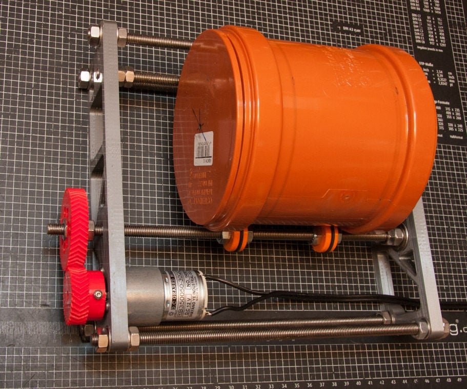

why not printing one (almost)?

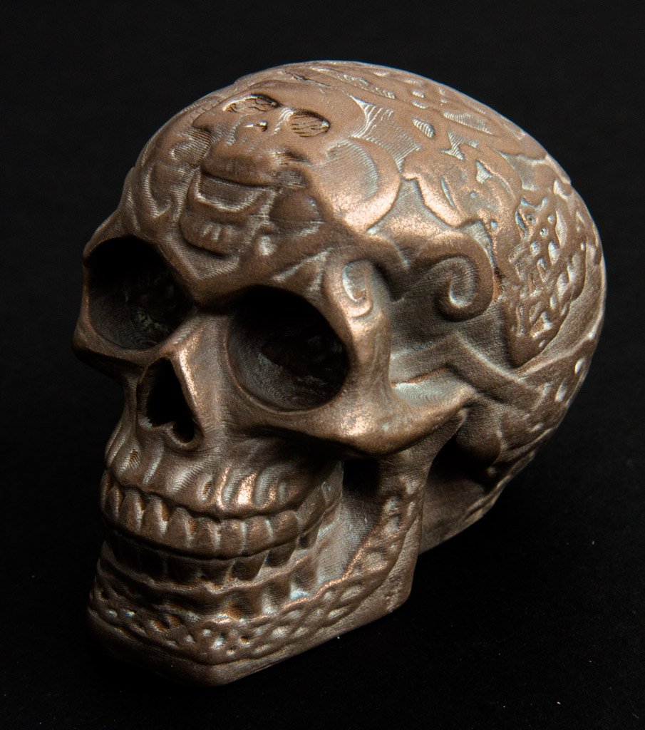

Here is my self designed rock tumbler which performs pretty well. After tumbling I finish all items with a buff wheel + sometimes a piece of cotton cloth for the final finish:

Ah… @Joerg_4… I just remind your Instructable I read a few months ago and you convinced me to order the parts… The only thing I did not order yet is the PVC container. Which size is yours? Where did you find it?

  • was it a problem to put those little Marvins in that big PVC pipe? (more polishing material needed?)
  • do you use only brass screws?
  • how much is it noisy?
  • is the filaflex part needed? for which purpose (noise? quality?)?
  • how thick are your shells?
  • and so more to come…
Thanks a lot for your help
well, here in Germany every hardware store sells these PVC pipes in different sizes.
My container is 150mm in diameter, but the frame design allows to use smaller or even bigger containers
here are my answers to your questions:
  • do you have any other photo of your polished prints?
    yes, but only one: https://3dhubs.s3-eu-west-1.amazonaws.com/s3fs-public/IMG_2262.jpg
  • was it a problem to put those little Marvins in that big PVC pipe? (more polishing material needed?)’
    no problem, just add more polishing stuff. It would have been wiser to use a smaller drum, but I’m lazy :wink:
    no, I also used stainless steel balls, ceramic pyramids and walnut shells, but brass screws performed best.
    loud :slight_smile: you don’t want this machine near your living room.
    yes, without it doesn’t work, because this makes sure that everything is mixed well. Nevertheless it can be made of regular PLA, it’s just a little bit louder compareed to flex PLA
    0.8mm
    I’m prepared :wink:
@Joerg_4, thanks A LOT… It really helps!
