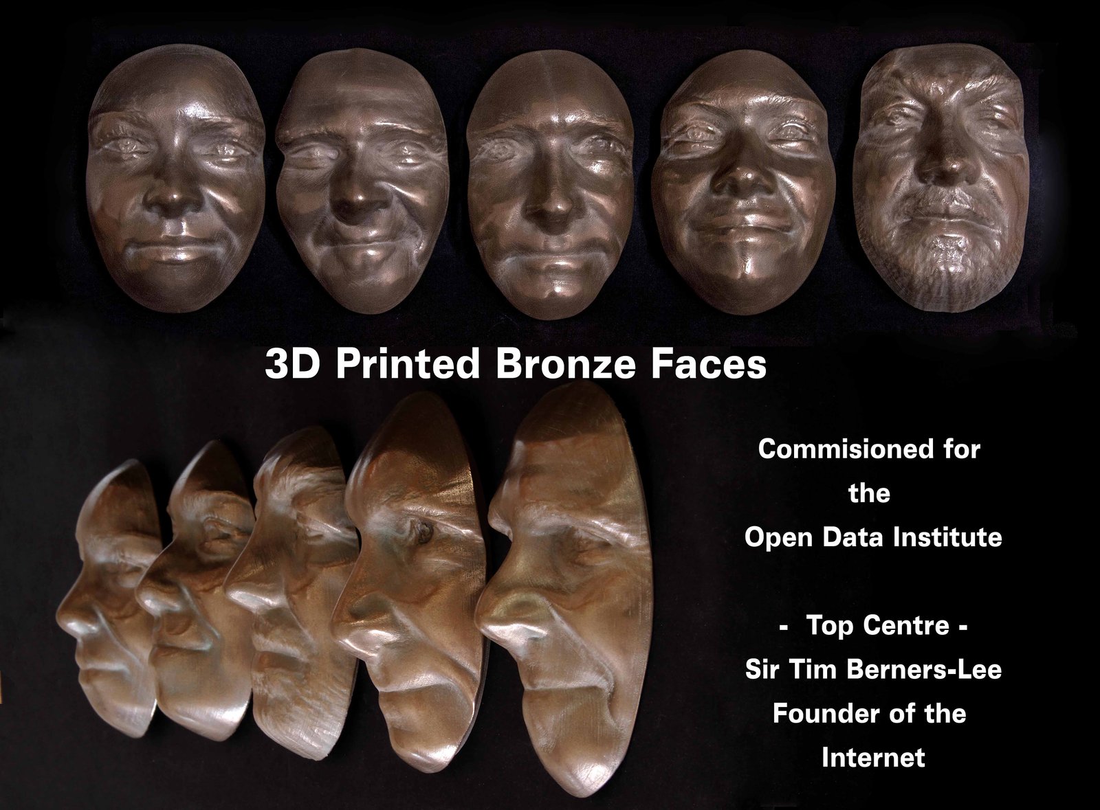

In November I was asked by Fuel 3D and Ultimaker to print out five facial scans taken at an event in London, one of which happened to be Sir Tim Berners-Lee the founder of the internet (which was an honour in itself). These were each about 12cm tall, printed in Colorfabb bronzeFill and then polished. They all came out really well (see below) and led to what follows.

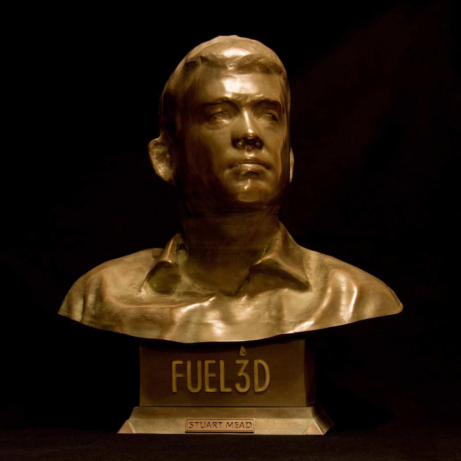

Those who know me will testify that my philosophy is that while I believe 3D printing is a great technology it’s one for which we need to keep finding new applications, and one where we need to keep pushing at the boundaries. The proposal by Fuel 3D was to print out a life-size bronze bust and stand with Stuart Mead their CEO as the subject, and as such it met both criteria.
The technique used was similar to that for the Royal Institution print - a facial scan taken by Andrew Smith with the new Fuel 3D Scanify, and a more general head and shoulders scan taken with a Structure Sensor scanner to keep the overall file size down. The scans were then meshed together, and a stand added, by Stephen Atkinson at Fuel 3D before the file came to me for printing in early December.

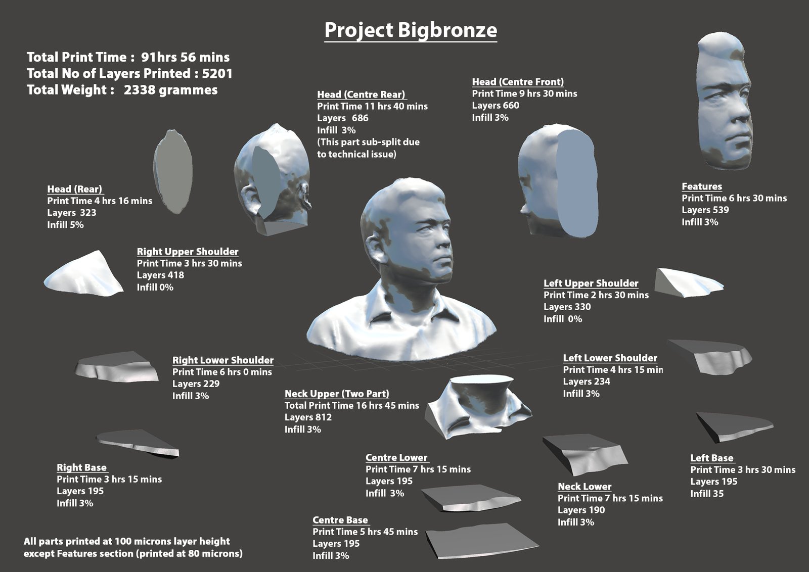

Due to the size of the final printed model it required a lot of splitting for printing on my Ultimaker 2. The head and shoulders were ultimately printed in 16 separate sections and took almost 92 hours of print time in total. Everything was printed at 100 microns layer height except the front facial part, which was printed at 80 microns for slightly better definition.
The stand was also printed in bronzeFill, but only as a 0.8mm thick shell which was then reinforced by two solid wood blocks inside to bear the weight of the 2.3kg print sitting on top of it. This still probably consumed around another 14 hours of printing time though.

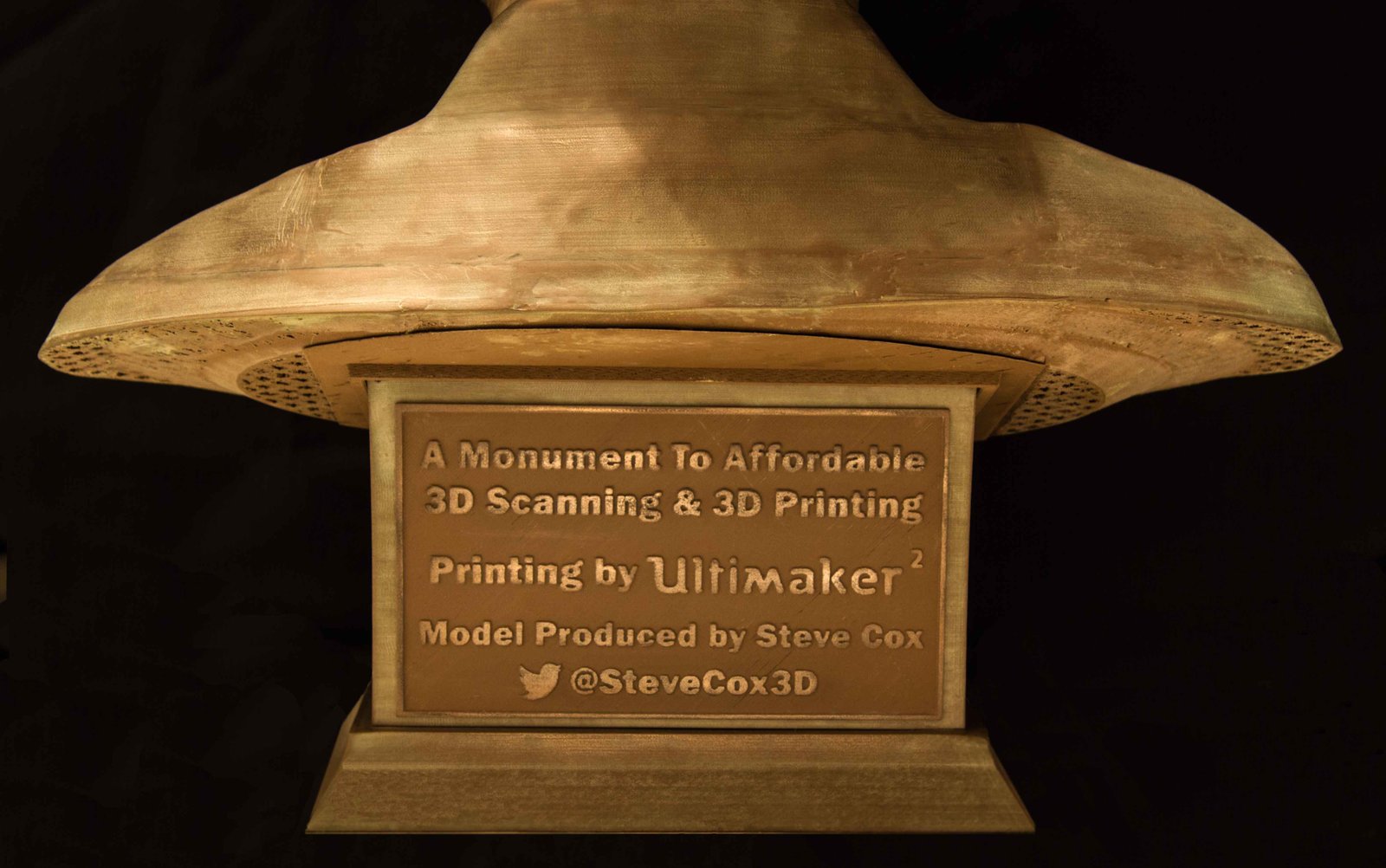

The stand was finally enhanced with the Fuel 3D logo, a Stuart Mead nameplate, and an inscription on the back, all of which were 3D printed in bronzeFill and then polished. These were all made off JPEGs (which is one of the really cool features of Cura, the ward-winning open source slicing software developed by Ultimaker).
In addition to the printing there were hours of file preparation to split the model for slicing and printing in the most efficient way, not to mention the time spent assembling the parts and dressing the joints. The final model split is shown here.

Now I’m curious. How did the splitting work exactly, is that manual work? I would be interested because it allows for making large prints in general.
Thanks again for all this Steve!
It’s fairly easy.
I used Autodesk Meshmixer (which is one of their great free downloads). In this programme you can import an .STL file and then use the “Plane Cut” command in the “Edit” menu to cut the model into sections. You can flick between which side of the model you want to keep, and by saving, then stepping back and selecting the other side of the plane and saving again you end up with two exactly matched sections. For complex, large models like this one this is the best way I’ve found so far.
Meshmixer is also great for digitally “re-touching” a model to eliminate difficult to print areas (like overhangs) where it’s not critical to the overall finished piece. For the facial prints it’s definitely the 3D equivalent to Photoshop (you could take out wrinkles for instance).
For simple cuts (where maybe the model is simply too tall for the build plate) you can section models inside Cura by going to the Advanced tab and using the “Cut Off Object Bottom” command. This sinks the model into the buildplate by an amount you determine, and you can print the top section of the model. Then re-set the model and print the bottom section using the “Pause At Height” plug-in to stop the printer at the layer that would be the one that would be just underneath the top section that was printed.
Again, you get two perfectly matched pieces which can be joined together. I’ve also used this on smaller models where I’d rather print in sections, with no support material and have a virtually invisible joint, rather than wasting loads of material on support material (and the time and mess in removing it). I’ve just used this technique on the Minecraft Raspberry Pi case that’s my first Hub order - it was a really difficult print because it’s full of overhangs, so I split it in to three pieces.

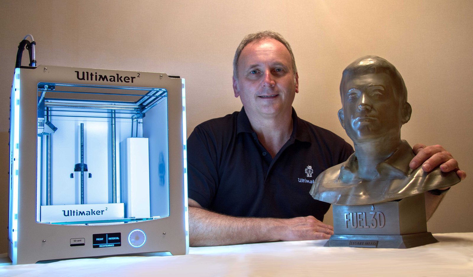

It was amazing to show the Big Bronze Project at CES last week. The feedback was amazing with most people not initially understanding it was 3D printed and then not thinking it was printed on the Ultimaker 2 (that included the founder of Ultimaker who visited the stand)! It was great to watch people walking past and stopping to touch the bust just to check what it was made from and then reading your explanation cards regarding what you did to make the model. We had loads of questions from visitors to the booth about Big Bronze many of them people who worked in metal and were impressed with the end result due to the quality of the finish. Really looking forward to bringing Big Bronze to the BETT (Education Technology) show in London next wee so you get to see peoples responses to what is possible with great collaboration.
