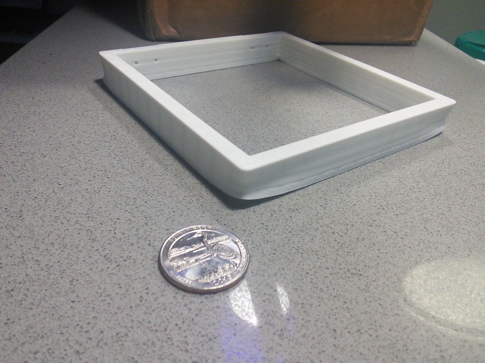

Hi community! This is my first post here, so I hope I’m within the spirit of these forums :slight_smile:
I’ve got a part I’ve been trying to 3D print on my Rostock Max V2 for weeks now, and no matter what i do, I can’t seem to stop it from warping at the corners. I’ve tried increasing the heated bed temperature, using a brim, hair spray, a raft, it always seems to warp, although always by different amounts at the different corners, and some prints come out less warped than others. I’ve also tried a higher infill percentage. At this point I’m out of ideas. What might you guys and gals suggest? I’ve been printing in PLA with a printer temp of around 195 C, and a heated bed at 60 or sometimes 70 C. Should I post an STL or gcode file along with the question?

Considering the shape of the 3D print in the picture this probably won’t be a problem for the print quality.

So, I was finally able to get my part to stop warping! It turns out, my problem was not that the print was cooling too quickly, but that it wasn’t cooling quickly enough! Once I lowered the heated bed temperature, things started to print straight. Essentially, what I think was happening was that the bottom layers that were in contact with the heated bed weren’t sufficiently cool by the time the middle layers were cooling. So, as the middle layers were cooling, they wanted to contract, and since the bottom layers were still fairly warm and malleable, they easily went with the contraction. By lowering the heated bed temperature, those bottom layers solidify more quickly and are less malleable and can better resist the tendency to warp. Chalk up another one for counter-intuitive solutions!
