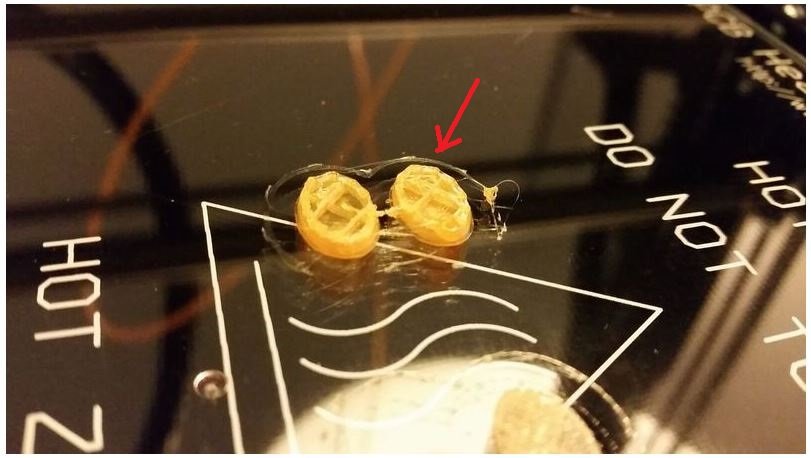

I need some help please! I finished building my HelloBee Prusa recently and started making some printing tests, but no success so far! (I was counting on that :stuck_out_tongue: )
Well, I have tried many approaches but maybe it would be better to ask for some advice in order to save some time to achieve a first print with success.
I’m printing PLA with the bed heated at 70ÂșC and the extruder at 210ÂșC at a 40mm/s speed. I calibrated the bed a few times.
I’m using Cura and Pronterface as recommended by the manufacturers. I attached a photo to enlighten my problem. It seems that I have lack of filament feed, and sometimes the filament gets stuck middle print. I lubricated it and now seems ok. Regarding the retraction speed or any other configurations can you guys give me some piece of advice?
Many thanks in advance. Best Regards! :slight_smile:

Hi Diogo,
Is that exterior line in the picture a skirt? If so, it seems you have the bed too close to the nozzle. At Marvin’s feet seems to exist the so called “Elephant foot”, which happens when the first layer is too squished against the bed.
About the underextrusion, have you already tried to print with the retractions off?
I haven’t my HelloBEEPrusa assembled yet, but acording to the definitions BeeVeryCreative has on their website for using Cura with BeeTheFirst, the retraction could be about 0,75mm at 125mm/s ( both printers have direct extrusion).
I guess the best thing to do is change those definitions gradually, since they may be very different from machine to machine. (Big Builder, which also has direct extrusion has better results with 3mm at 20mm/s.
Also, make sure you have set the right filament diameter in Cura. If set to a larger diameter, the filament feed will be less.
Hope this helps! :slight_smile:

Hello everyone! I finally got it!
My main issues were:
1. Bed calibration
2. Filament lubrication - it gets stuck at the beginning of the printing. Increasing the number of skirts helped me to realize if it was stuck or not before going to the object being printed.
3. Z axis rod lubrication
4. Tension of the feeder bearing with the extruder stepper motor
5. PLA printing temperature! At first I was printing at 210ÂșC and the PLA didn’t came of the nozzle smoothly
 It had not a constant feeding rate
 By decreasing the temperature to 190ÂșC it was completely different. :smiley:
I know that the printing is not perfect yet, specially regarding the base, since I was tuning the printing process, but I’m happy with the overall result.
There’s an attachment with the result! Thank you all for your help! This community is AWESOME! :smiley:
