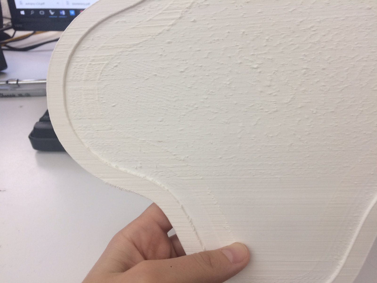

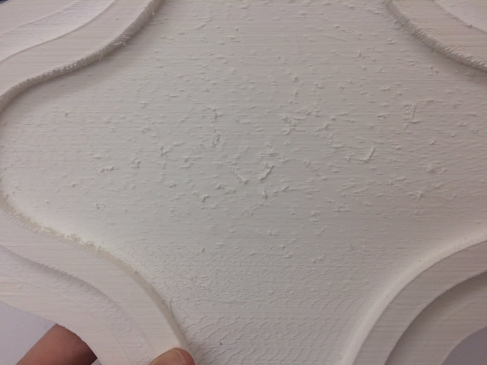

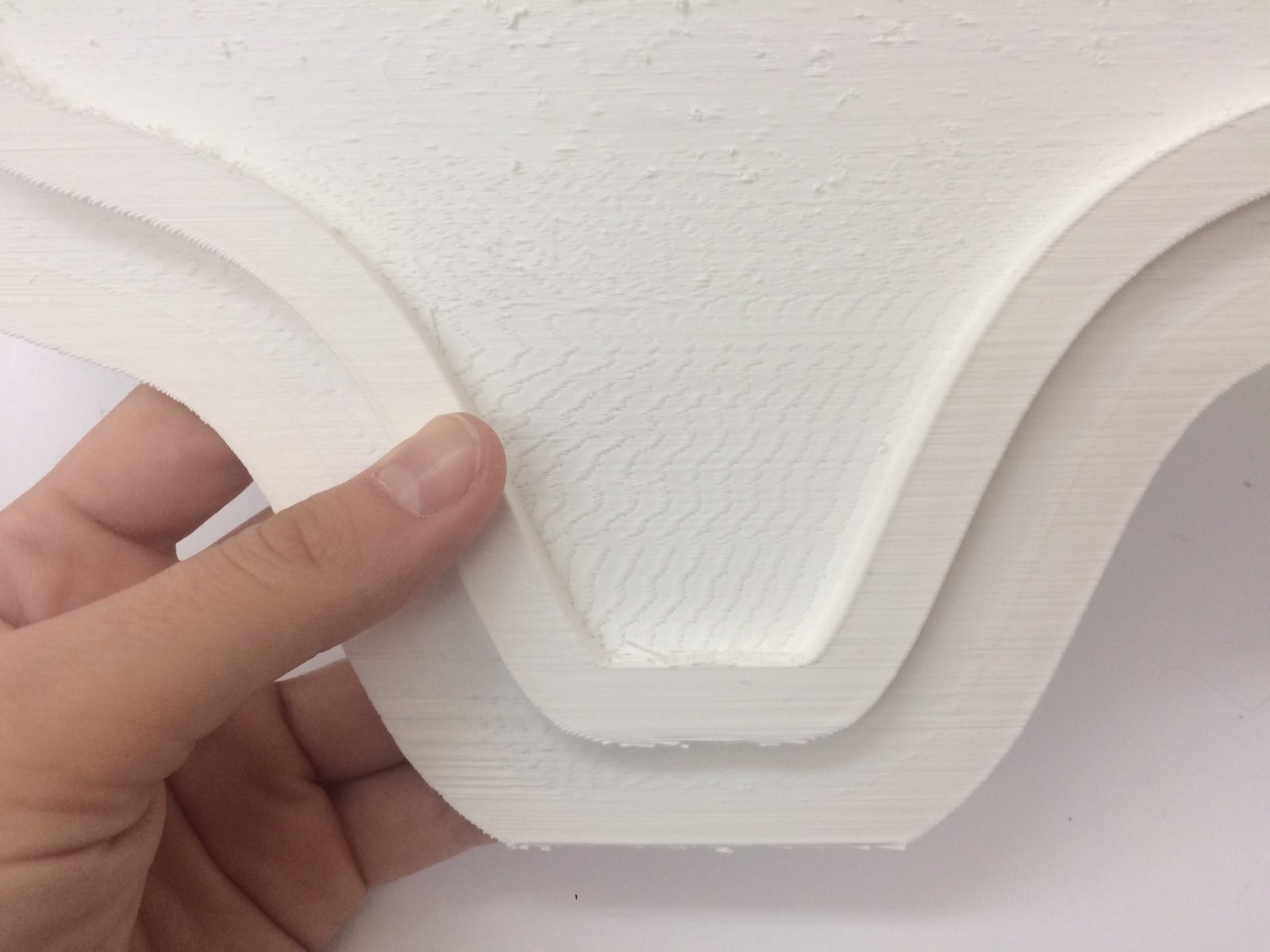

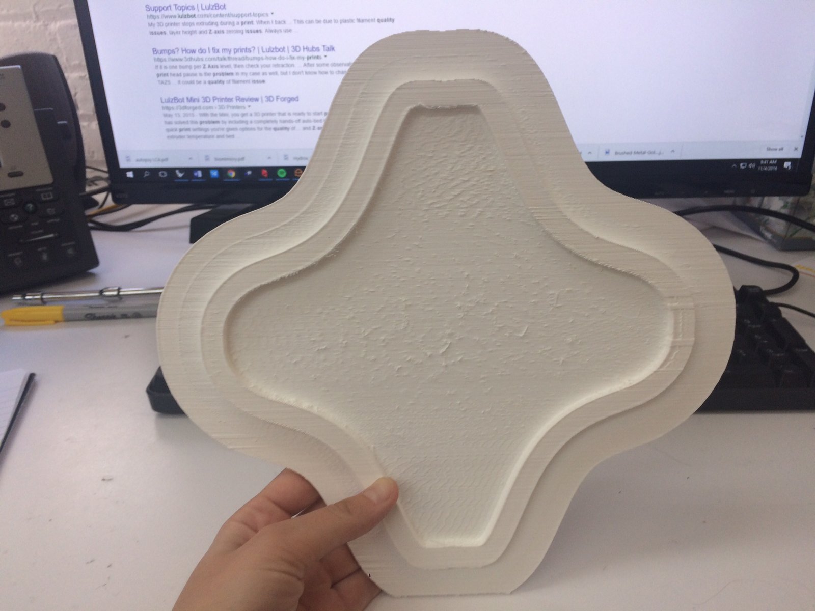

I did a 12 hour print overnight last night on my LulzBot TAZ 6 that came out with a really bumpy, odd print quality. Not sure what to change to keep this from happening. I am printing with the object upright to get nicer print quality in the Z axis. The piece is 1mm thick at its thinnest point and I am using a 0.5mm nozzle in PLA.

Looks to me like there is a bit of over extrusion going on. Have you tried printing a calibration cube with this material?
What infill do you have set, and how many top layers? In addition to overextrusion, it’s possible your infill is too sparse and/or you don’t have enough top layers. The printer can’t print well over large gaps (which happens when the infill is too low) so you end up with clump scattered across the top from sections of the top layers not adhering to anything and curling up. The printer will print over these spots, but will leave behind a rough surface, like what you have here.
What slicer?
@keebie81 Simplify3D. I’m trying the print again at 210C instead of 205 and it working better but there are still some little spots where it’s not perfect. Thinking I might have to thicken the file up.
