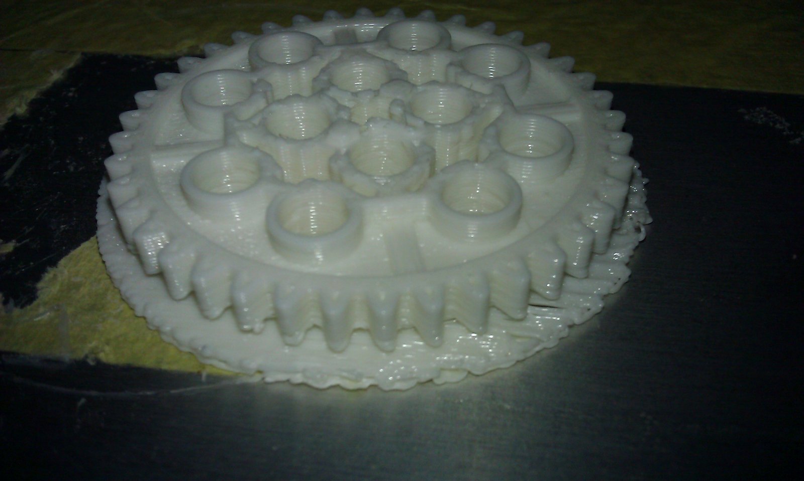

I’ve recently started getting these bumbs on my prints. Seems to be happening the most on non overhanging top surfaces.
I am using a lulzbot Taz 5
Print bed at 110C
Nozzle temp at 235C
50mms print speeds.
40C enclosure
IC3D filament
Am I extruding to cold? Seems to be slightly (only slightly) better when I put the nozzle temp up to 240C. Bad filament?
I Should also note that it seems to be worse on long passes. In other words, small parts being printed that only extrude a little bit here and there dont seem to be showing signs of this. However when I print something like the imperial star destroyer at 10" and the nozzle literally extrudes in a straight line for 10 inches… this issues shows up.
Thanks for any help.
It looks like over extrusion. Check the diameter of your filament, 3mm filament should measure about 2.85. There is a setting in your slicer to set the actual filament diameter. I’m guessing that your filament is actually a little wider on average so you are over extruding. You will need to check the diameter in several spaces.
Another option would be your retraction amount is too much, causing the extruder to sit in one place for a moment to retract the filament.
If it is one bump per Z Axis level, then check your retraction. If it is random, check your filament diameter.
Happy printing fellow Taz user.

It’s hard to be 100 percent certain but it does seem like it’s one bump per level. I have just been using the standard 1 mm retract at a speed of 10 mm/s with good results up untill now. I did slow down travel speed on a recent print and it made the bumps worse (i was hoping it might make them better) These bumps aren’t present on vertical walls. Is just when I do angled roofs/walls that they start to get bad. Maybe the oozing from the retracts just isn’t as visible on a vertical wall? I don’t get strings so I never assumed oozing as a problem. Although I do get marks on the top of my print. I tried upping the Z hop with little effect. So it must be oozing… Bad filament could always be a problem… I do normally hear popping noises on occasion, especially at the start of a print. However this latest print was a bag opened from factory sealed merely hours before. Had the same problems. There is always the option IC3D has crap filament. I went with them because they seemed to have the best reviews. I’m new enough that I haven’t tried anything else. Not sure about over extrusion. My measurements of the filament diameter are anywhere from 2.88 to 3.1 so I have tried to average them around 2.95… I guess I could try upping it to 3.0 diameter on cura.
Thanks for sharing. That is an excellent visual guide!
I have confirmed what the problem is. It looks like my nozzle is over extruding slightly when it starts a new line and when it ends the line. This is seen more on the round objects I try and print where it starts a perimeter then loops around and finishes the perimeter where it started, it then drags the nozzle inward to infill. When the nozzle goes in to infill it does not retract (why would it?) and yet more filament is deposited in that area.
I’ve tried playing around with my retract settings and it doesnt seem to make a difference.
I’ve lowered my extrusion and again it does not seem to help much. I’m clearly under extruding but it doesnt change the fact that a tiny bit of extra filament is deposited at the start and end of the line. It also doesnt help when the nozzle goes to infill, is there even a setting that would allow me to tell the printer to retract before moving inward to infill? I’m currently using cura.
Currently I’m printing a test print with only a shell (a thick one). The blobs are lining up in the same spot vertically because that is where each line begins and ends when there is no infill.
Any ideas or solutions? Maybe its time to switch to Slic3r?
In Cura there is a check box for “Perimeters before Infill”. This causes it to print the outside, then move inside to print the infill. You can clear the check box and it will do it in reverse order. It will print all the infill, then move to print the exterior before retracting and moving up a level.
You may want to give that a try.

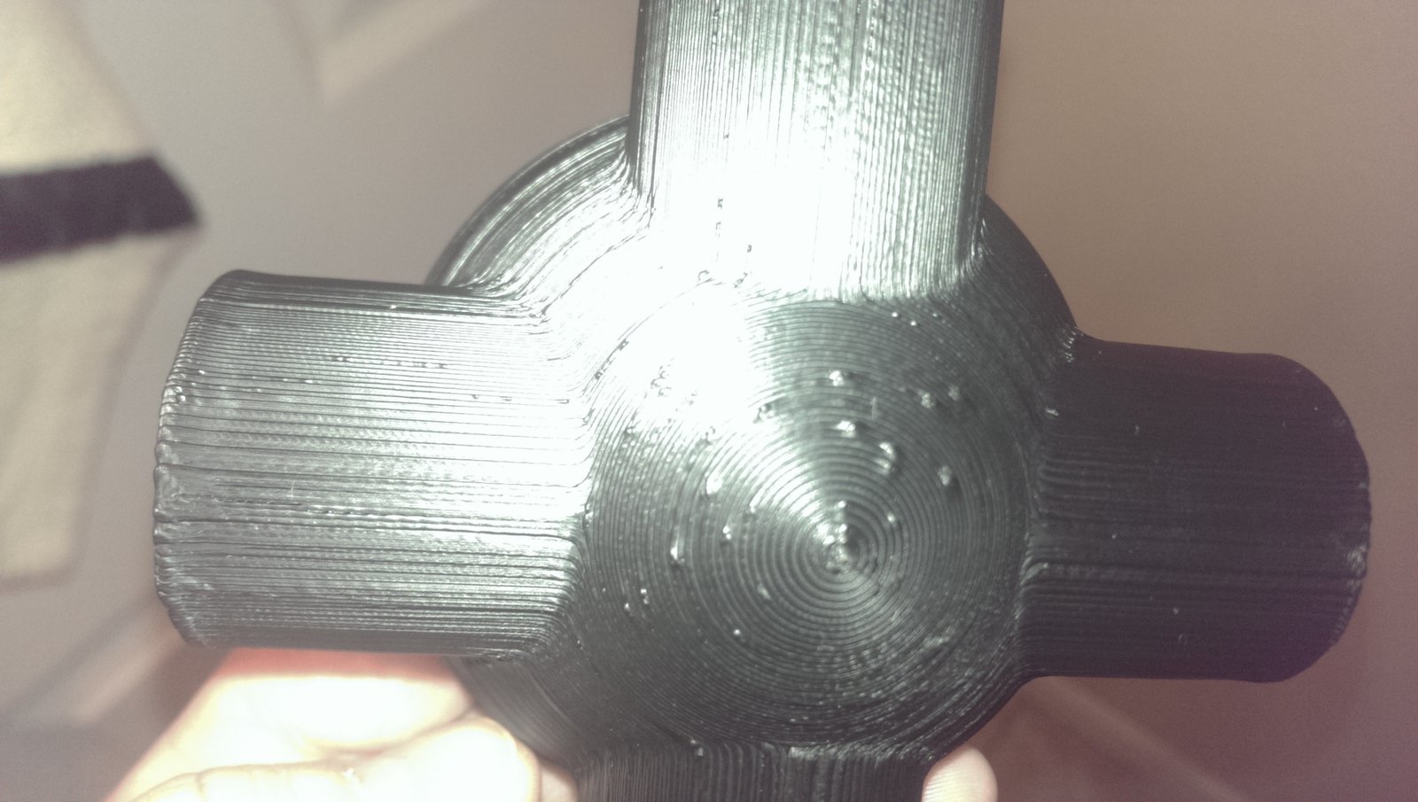

Your problem sounds very similar to mine: bumps showing during circular cross sections only of print using black filament. Ive attached a cropped photo of the problem. It seems like it’s on nearly every layer, but never in the same spot. After some observation I think that a print head pause is the problem in my case as well, but I don’t know how to change that! Have you found a solution?
(I’m curious to try the same print in another color, because after hearing a Schnaab’s comment on the black filament I realized that I don’t remember seeing this problem outside of my black filament)
please let me know, Thanks!
Lulzbot TAZ5
Print temp: 240C
Print speed: 35-45mm/s
Material: Village Plastics ABS
