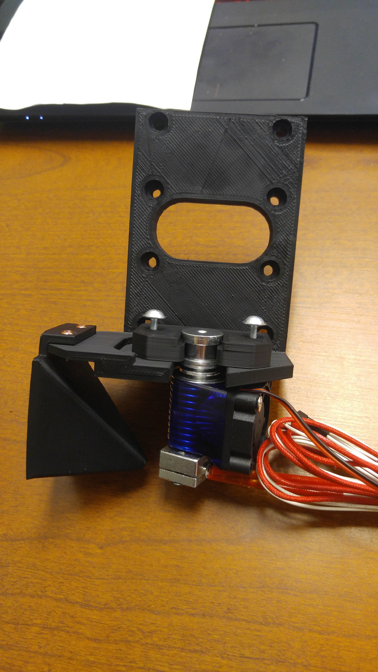

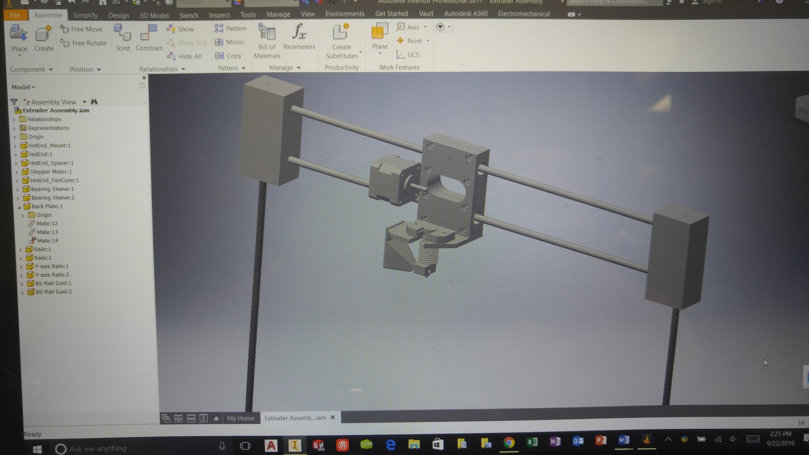

I have finally started the design process… The parts on the Y-axis attaching to the printer head rails are temporary, just put them there for visual representation. Sill working on the rest of the extruder. Just figured I’d give you guys an update and hear your thoughts.
