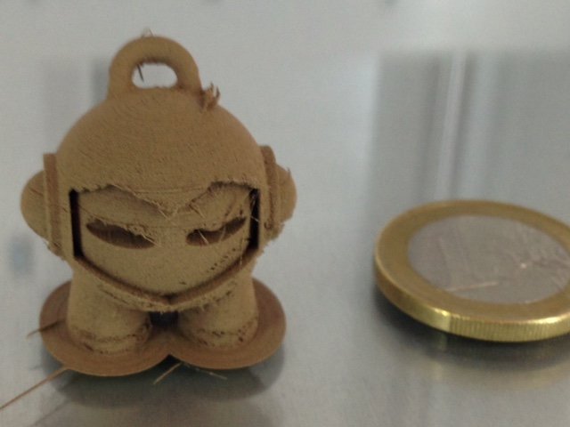

The issue with this filament is that it has “tighter” envelopes with regards to speed, temperature.
I had to print it 3 times to make it nice:
After first print I had to reduce resolution from 0.06 to 0.1mm
layer height. Also had a temperature drop in the beginning (Check Legs!),
due to FANS full 100% , and not gradually. Avoid that!
Then the ring on top looked completely melted,
Second print lower temp: 205.
Then it fused so badly so the ring broke off for nothing in post processing.

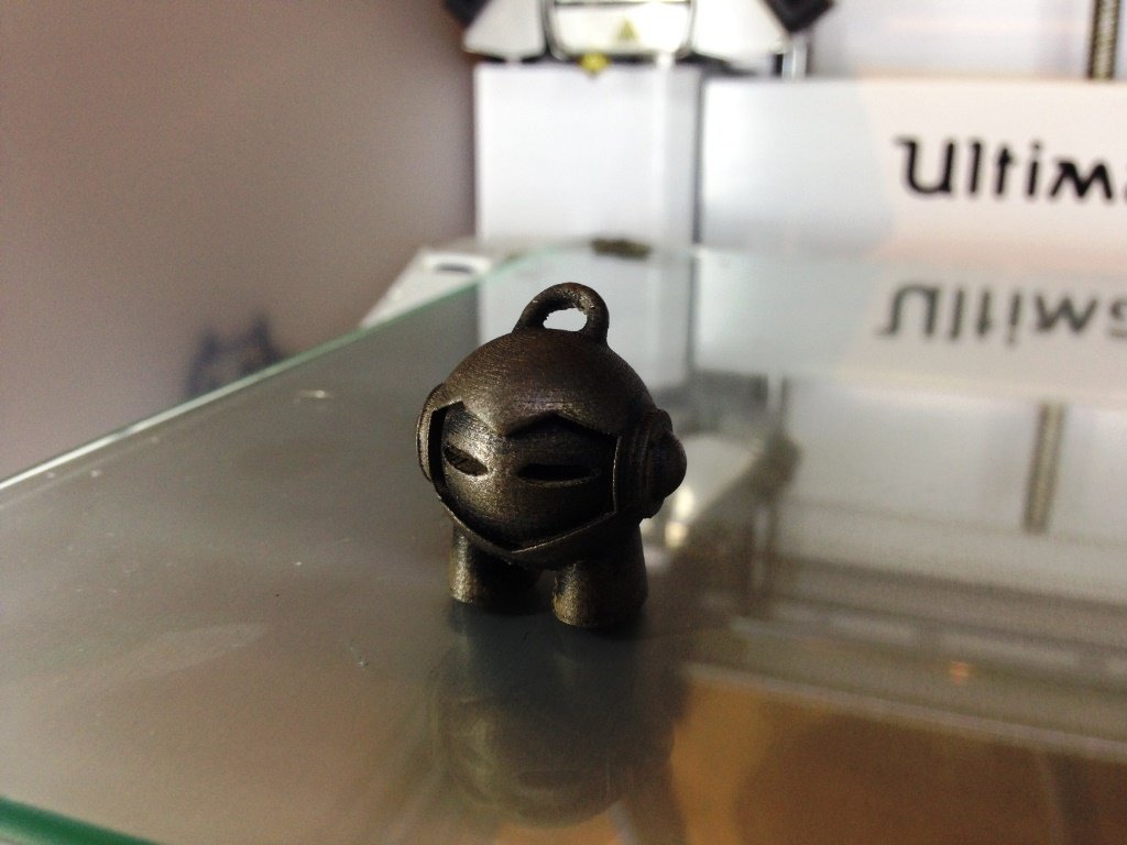

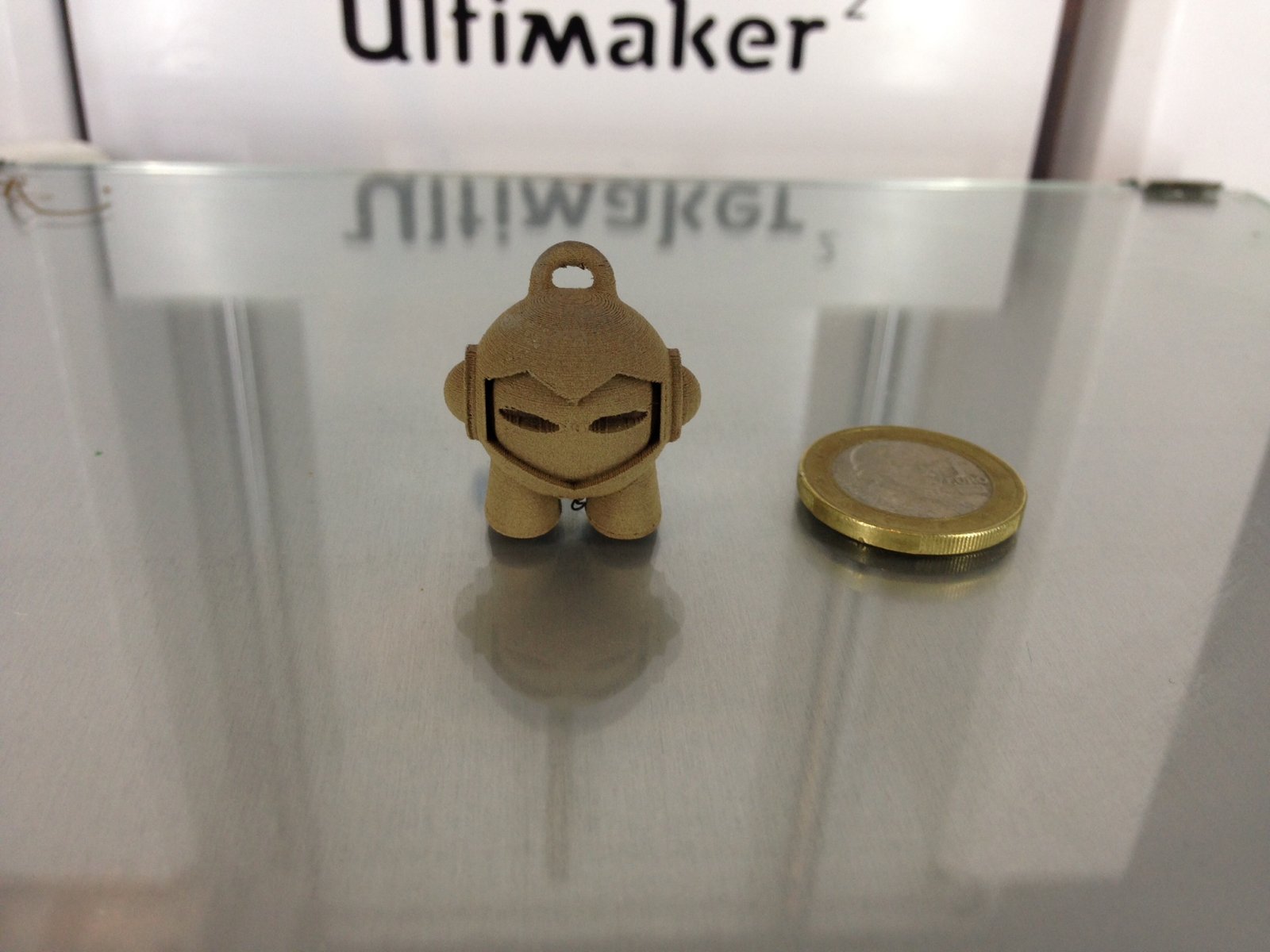

Successful attempt:
Printer: UM2, with 0.25mm nozzle and custom heater block upgrade.
Bed: 60, no tape or glue but clean glass.
Layer: 0.1mm.
Initial print temp: 225 (sticks much better)
After few layers temp: 215 (!)
Fan: FULL after first few layers.
Fill: 30%
Filament: colorfabb Bronzefill
Speed: 30mm/S (Cura at 50 default, and UM2 at 60% = 30mm/s)
Layer: 0.06mm
Final print, No Processing

Impressive print! Is your nozzle really only 0.25mm wide? I already experience cluttering whilst printing with the regular 0.4mm nozzle on the UM2. I’m definitely going to try your settings. Thanks!
Yes! The nozzle is 0.25.
I have installed a Custom heater block in the UM2, and can use nozzle
“any” size…
Thank you!

The one I printed at 60 micron in the photo, I have not post processed.
The good one I processed 5 minutes already!

I find it clutters ( like in my posted, failed print in the picture )
when setting to high resolution!
I find 0.1mm lh to be perfect.
All this changes with nozzle size, material, speed, temperature.
