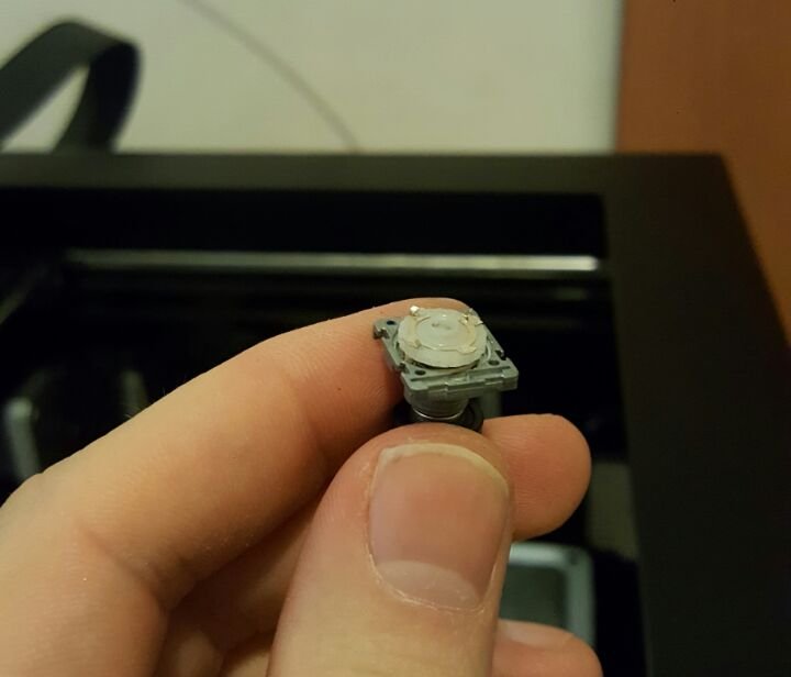

Hey guys,
Our lovely 3d-printer now has a broken knob. We can’t navigate between the menu items and our workflow stopped completely. Is there anyone who
* hacked the knob and made it work without the knob or
* has an extra knob or
* knows how to find a knob?
New Zortrax m200 Display Set costs $65 whereas what we need is only the knob. Any suggestions?
Sincere thanks in advance,
Kadir
The part your looking for is a rotary encoder, if the pads on the PCB haven’t been ripped off along with the encoder you should be able to either solder it back on or get a replacement pretty cheaply and solder it back.

You can buy a new knob from China , Aliexpress:
https://www.aliexpress.com/wholesale?catId=0&initiative\_id=AS\_20170320035940&SearchText=rotary+encoder
You can just buy the encoder knobs if you are able to solder.
