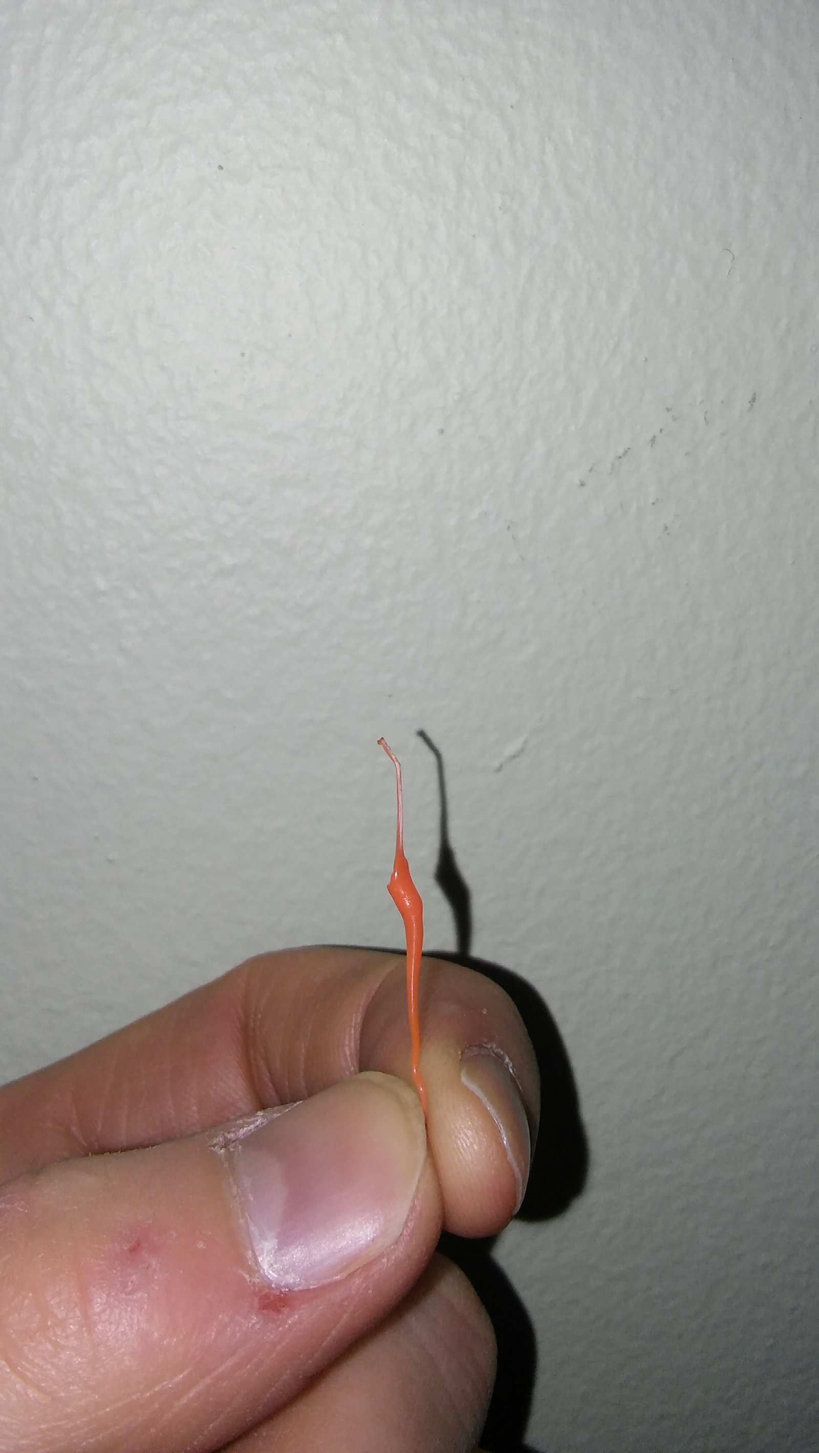

Found our culprit!! Took out the screws in the fan and found a little piece of the orange filament stuck in the tube. Yanked it out and now we’re sorted :smiley: Printing the pre-loaded OK hand and it’s working like a dream. I’ve said it already but thanks for the advice and quick response to my problem. I think I’m gonna enjoy my time in the 3D printing community :smiley:
