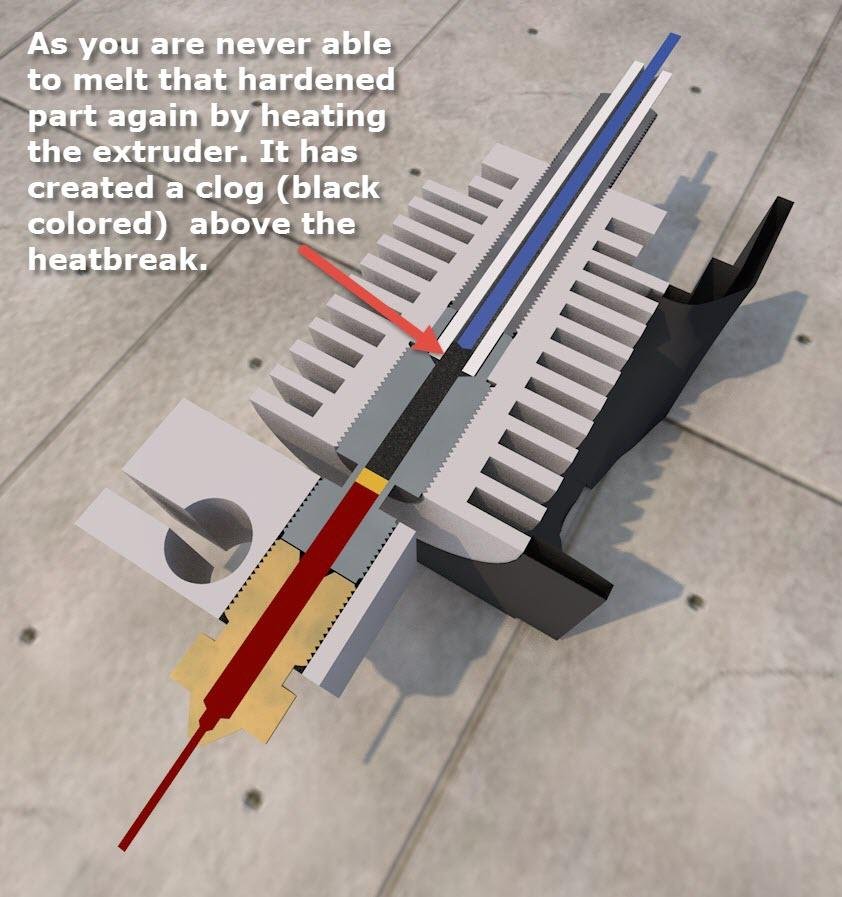

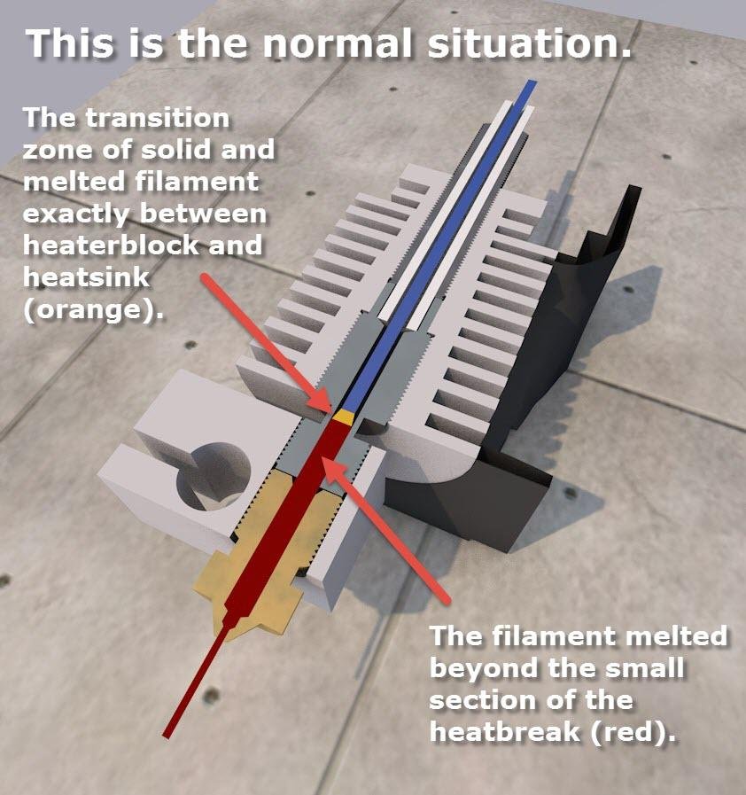

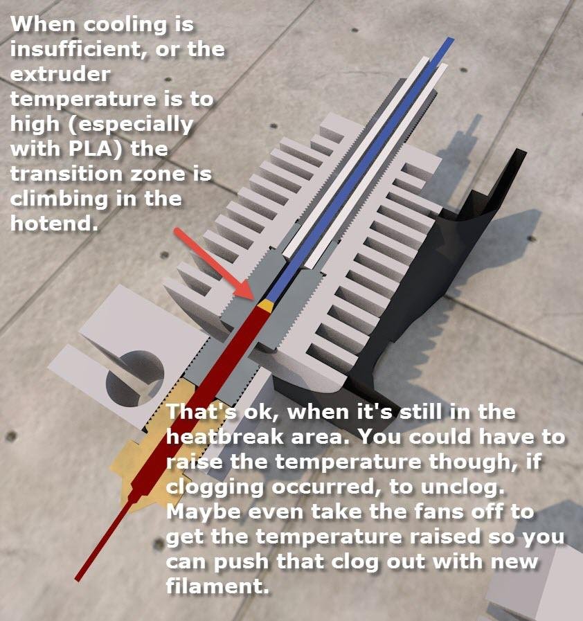

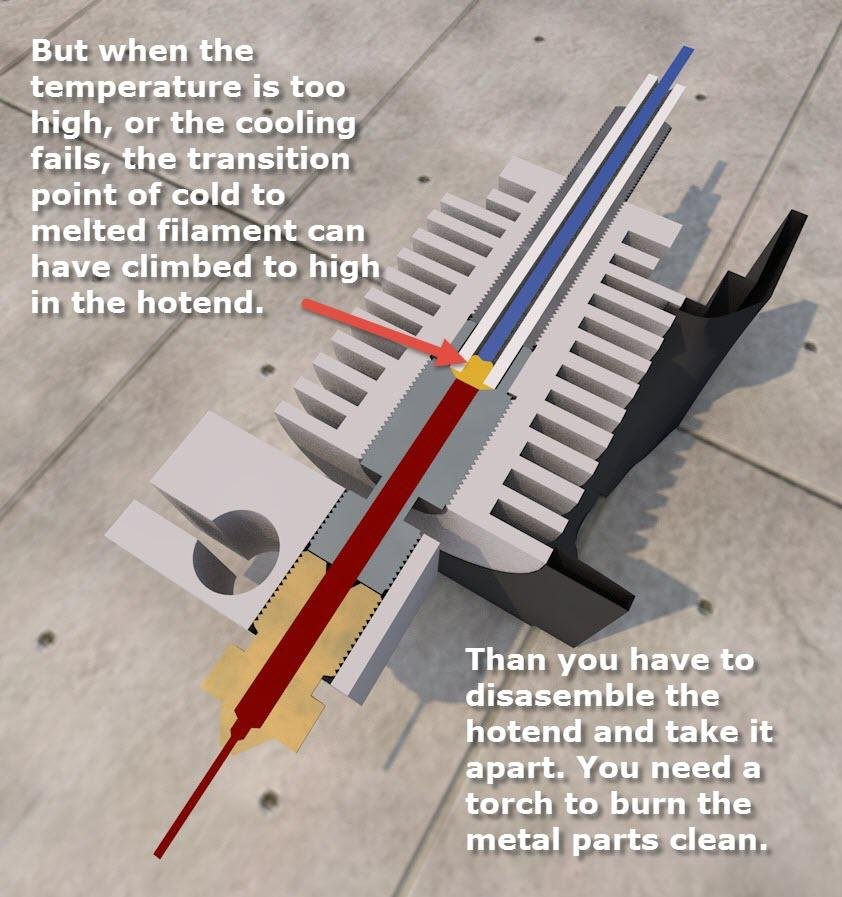

Love the diagrams, explains it perfectly… What should happen… this is exactly what is not happening me.
The PLA is clogging in the blue zone… because the fans are not working…
