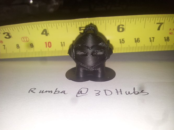

I just finished the verification print of marvin, but the print isn’t the best. As seen in the attachment, overhangs seem to be an issue.

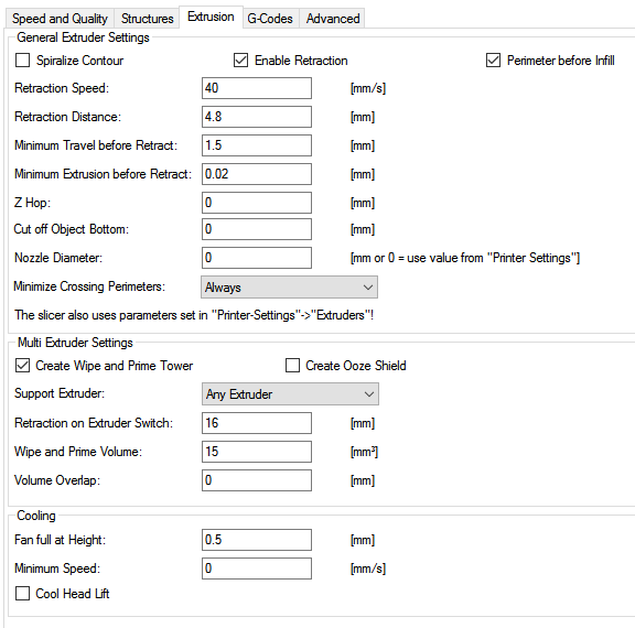

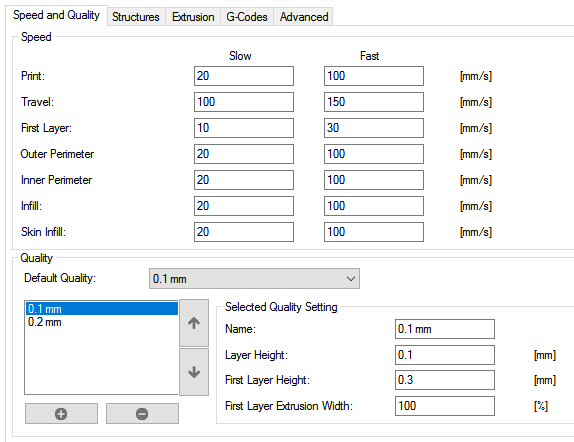

I used 30mm/s speed with 220.C on the hotend, using an E3D V6 with ABS. I have a bowden, with the retration set to 4.8mm (As the bowden tube is over 600mm long).
I use the repetier host and firmware on the 3D printer, and use Cura to slice.
Any ideas?
Try lowering temperature a bit, and print two marvins at the time to give print a time to cooldown…
Agree on printing multiple Marvin’s but you are already a bit low for ABS at 220.
I don’t use a Bowden so I’m no help there!
I printed him at about 1000mm/Min I think and did ok.
Looks like you are close, overall he is not so bad!!
Check your extrusion rate, maybe a little high?
What layer thickness are you using?
I would make small changes one at a time and watch the results. Your almost there!!

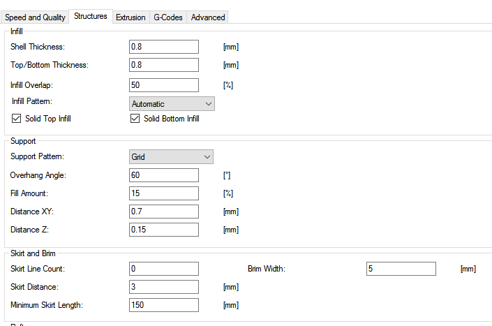

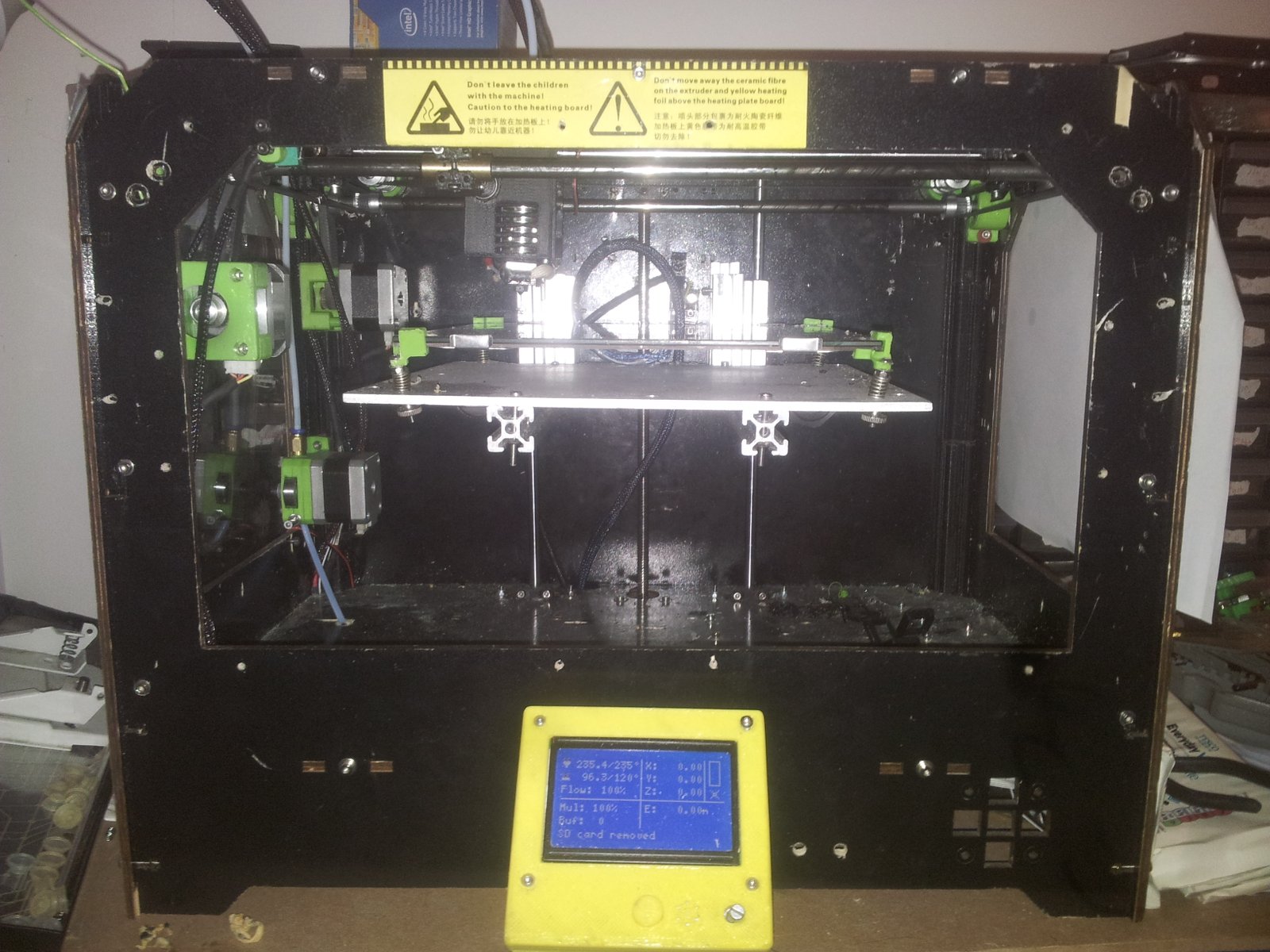

Review wouldv’e failed. my 3D printer needs quite a bit of tweeking, so I’l describe my machine,
3d printed ultimaker gantry
3D printed E3D V6 mount
Was a CTC Replicator duel.

You need to up the fan speed.
