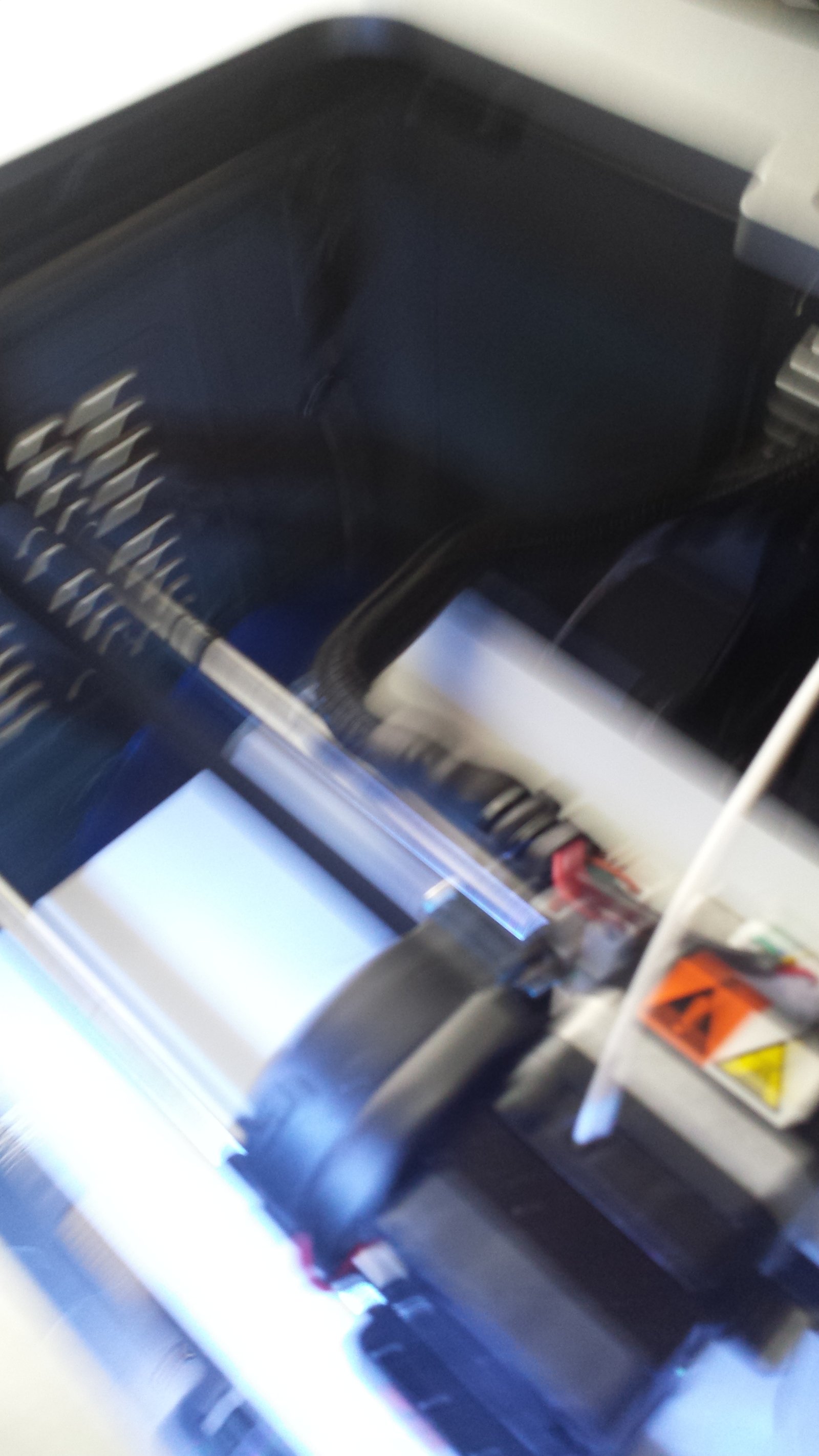

A picture with the head over to the one side. I do find that the filament can cause issues when printing at the back pf the build surface (by the dremel logo). I try to keep my prints forward a bit or if I am printing near the back center I watch the print a bit more closely.

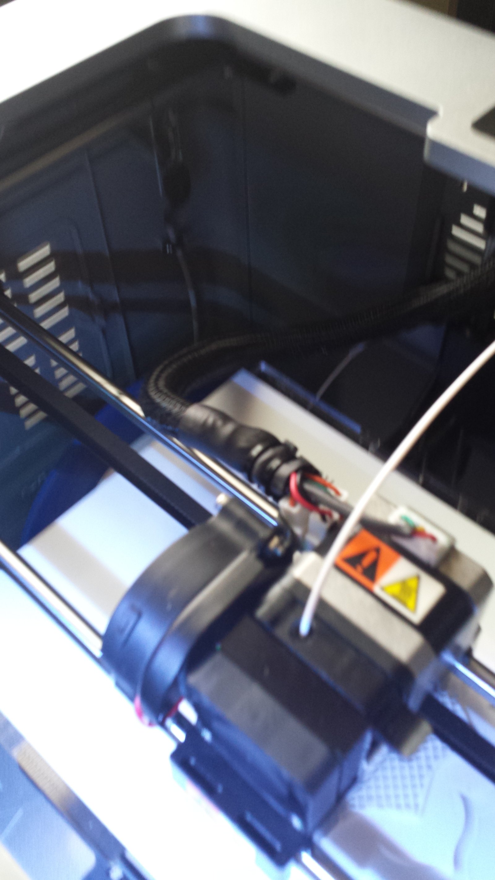

Here’s a pic I’m printing something right now

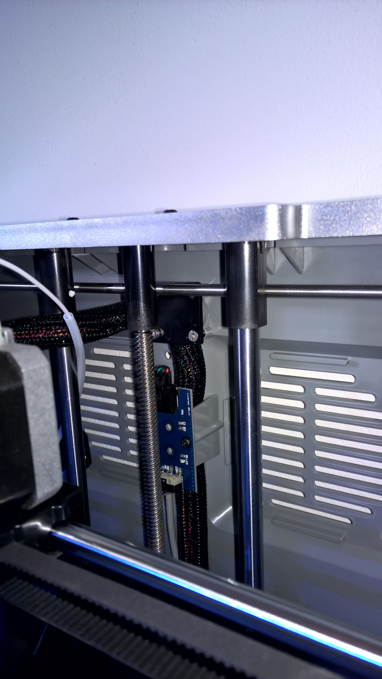

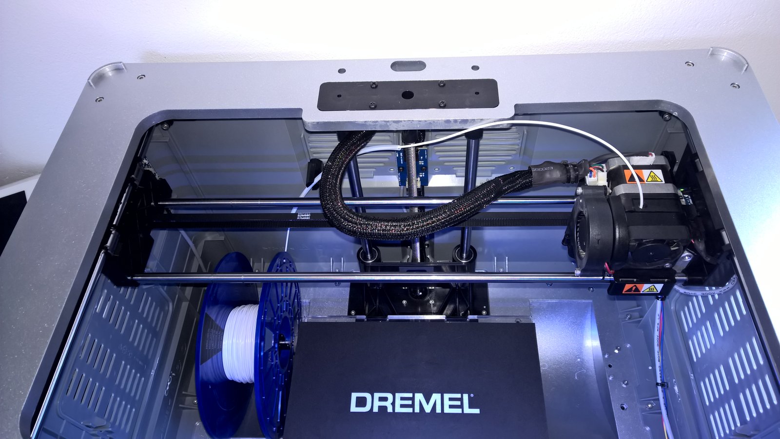

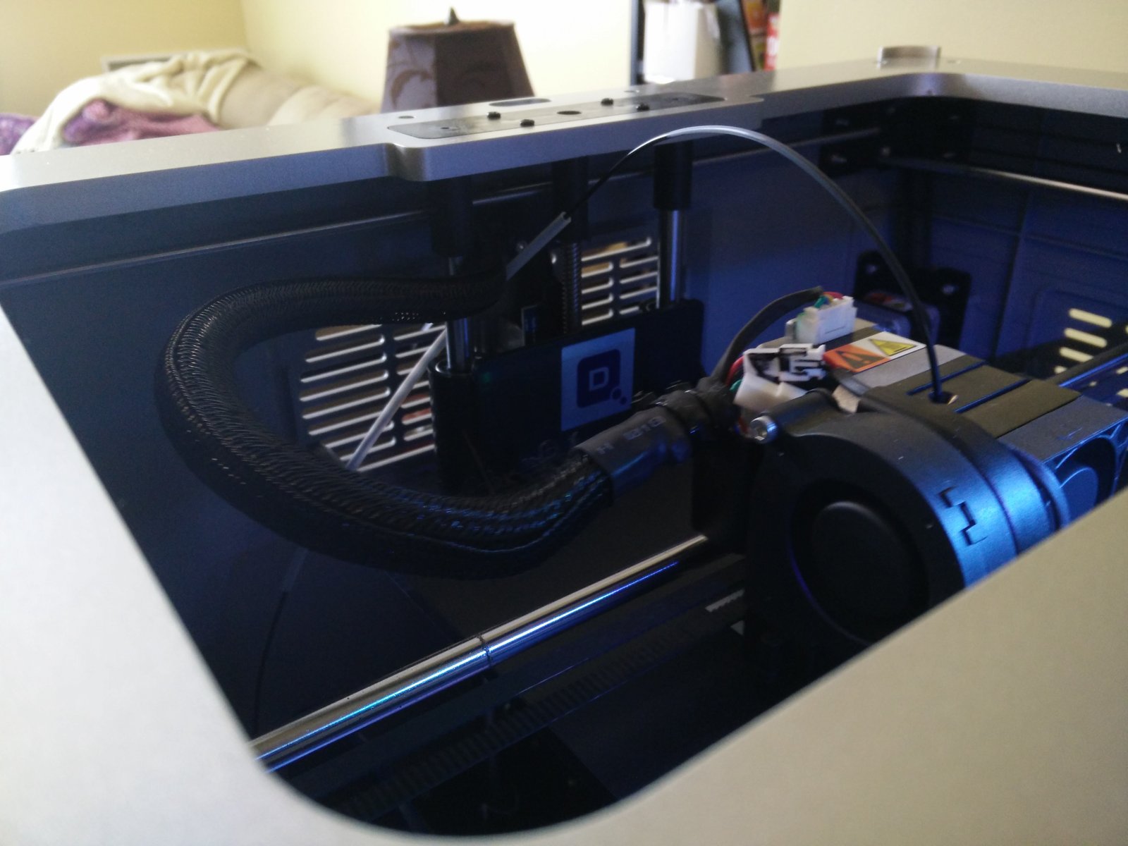

In the post right below this Stephan included some pictures of what the back of the printer should look like. It looks to me like your cable bundle might not be properly secured at the back. If you don’t have the black plate in his print use a zip-tie or tape to get it out of the way and see if that helps.
You might also have too much of this bundle past the mounting plate. With your printer off move the head to the extreme corners and see how much play you have. Loosen the back and pull the cables down to shorten it up and try again.
