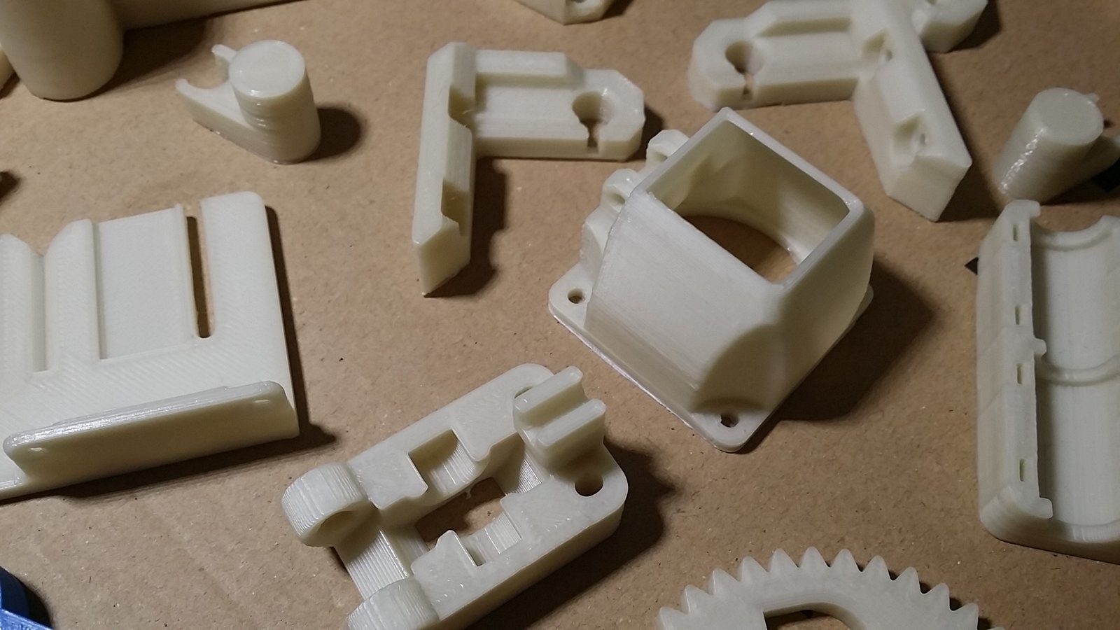

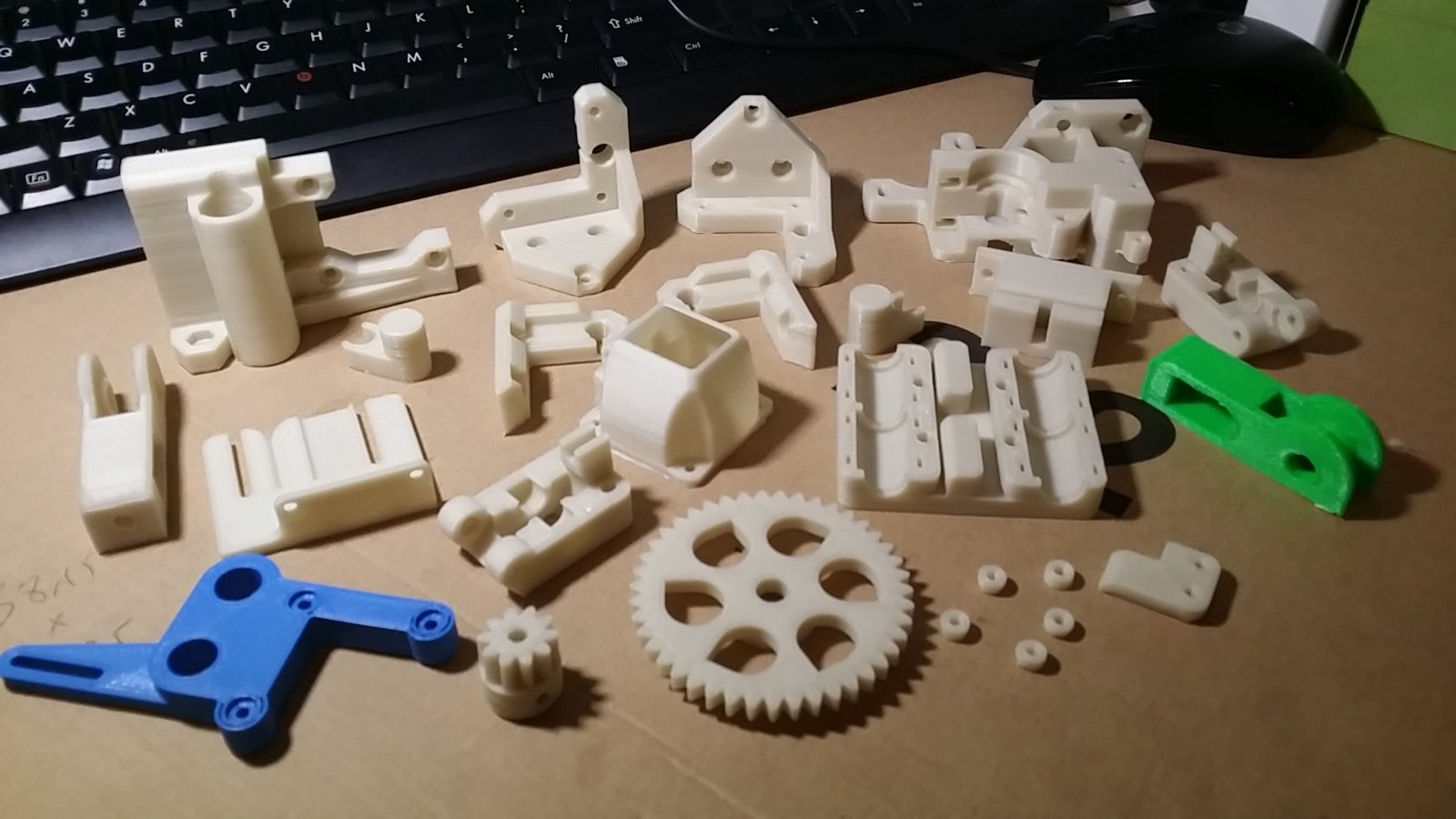

I print with a prusa i3 et direct drive MK8 extruder 0,4mm nozzle.
210 for extruder, bed at 65, speed between 60 and 130 mms, flow 105 %, fan 50 to 75 %
Blue tape with hairspray on heatbed.
That’S works fine for me
