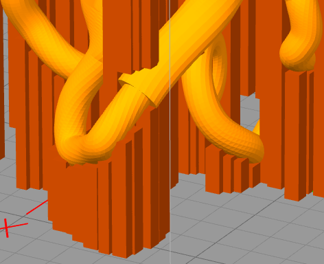

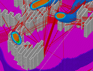

Hi Daniel, thanks for joining the discussion. PLA at 200, PVA at 190, bed at 40. Does T-PVA not have the same clogging problems at temperatures over 200? Do you have to print at very low speeds? Can you use partially filled support structures or do you have to make them solid for the PLA to be deposited on top. We are interested in printing proteins (see below) and if we could use hollow support that would go a long way in reducing material cost.
protein ribbon yellow w support red.png protein ribbon hollow Simplify support (only works w PLA currently).png
