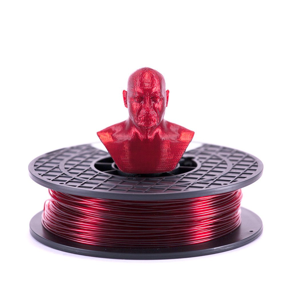

Heya, we’re loading up our spool of MadeSolid PET+ and was wondering if anybody could share their settings to make this go smoothly? It was awhile ago, but my last experience with PET did not go so well with the high temps required, although I think the extruder and heating tape were very worn at that point. Any help would be appreciated!
