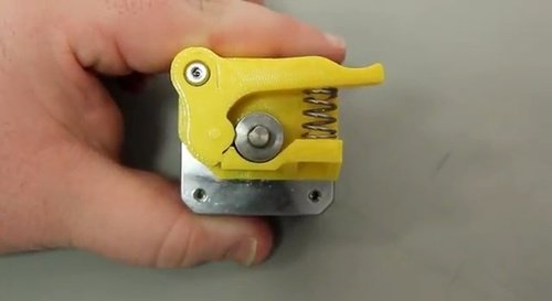

Spring Load Replicator 2 Block
The most popular hack is the spring loaded drive block for the Replicator 2. This block squeezes the filament in between the drive gear and bearing with a constant amount of pressure, resulting in a much smoother flow of filament. This hack was created by the Makerbot community and has been verified and adopted by Makerbot itself.

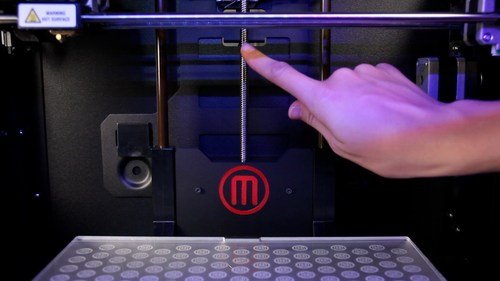

Gantry Realignment
This is more of a maintenance operation than an actual hack, but is a problem encountered by many Makerbot Replicator owners. If your stepstruder (moving print block with fans and nozzle) is not hitting the endstop, your gantry (the rods and belts that support your stepstruder) could be misaligned, preventing your printer from working normally. This video will walk you through the entire process of realigning it again.

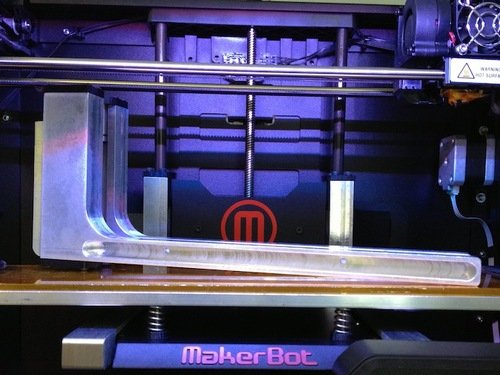

Metal Arm Upgrade
This upgrade replaces the standard plastic arms supporting the build platform. The standard arms are more likely to bend over time and can wobble during prints. This metal version will drastically improve your platform’s stability.

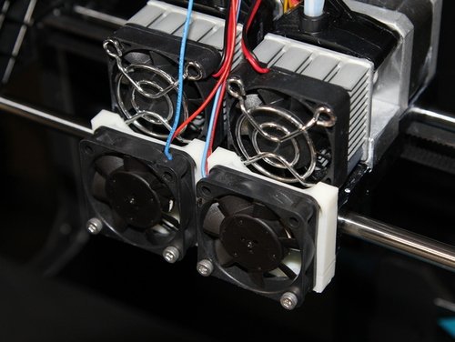

Makerbot Replicator 2X PLA Hack
Unfortunately, the Replicator 2X can only print ABS out of the box, however this pretty cool (and expert) hack will cool your build platform, making it suitable for PLA prints.

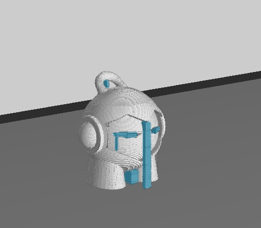

Support
Makerware offers one option for support. This should be used in cases of extreme overhang (over 45 degrees), but is dependent on the shape as well. When crossing a gap between two objects, the overhang can in some case be more than 45 degrees without any need for support.

Also for the Rep 2 gantry alignment problem: Someone who is trying to get the gantry to stay where it is supposed to be might find this helpful someday. If you are unable to get it to stay, try this:
After I kept fussing with set screws and it seemed like the pressure of the whole system was off. The left side was not following the right side properly and it would occasionally ‘slip’ causing major aliment issues in the print. This showed up after about 400 hours of printing.
I ended up cutting the belt on the left and installing it with a bit more tension. I used a pair of pliers to pull it tight. This fixed the issue while I ordered a new belt. While doing this I also re-lubricated the rods and together the tighter belt and smoother rods fixed the slipping issue. Whatever you do, DONT push down on the rods because they look a little bent. The whole gantry will pop out and be shooting / dropping parts in a circle around you!!

This is a good video for the actual gantry assembly. It does not show the Y-idler pulley set up so I had to figure that out myself. If you need to get the Y-idler back on let me know and I can give you some tips
https://www.youtube.com/watch?v=HeNgEfbdjsY&feature=youtu.be

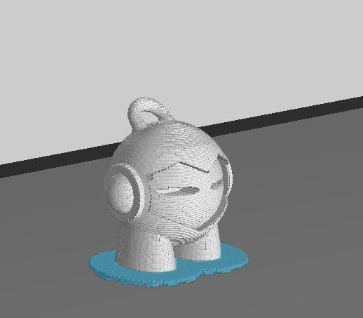

I don´t have replicator 2 o 2x, I have a Replicator Z18 with the “Smart struder”.
I try print “Marvin” with many settings, varying speeds (extrude and travel), quality (layer high in .04 to .09 mm range), and with last firmware and Makerbot desktop versions, temperature, accord with Makerbot and some blogs recomendations. Quality of print change, but I do not obtain high quality print.
I use diferent finishing methods (acetone steems treatement, epoxic resin, etc.) that improve quality, but I expected that printer print a true high quality objects. ¡¡¡I very frusted ¡¡¡¡. May be it is imposible with Z18.
I continue with this challenge until I obtain real high quality.
