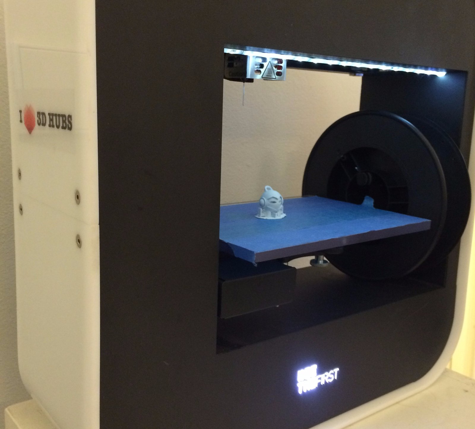

BeeTheFirst is a great printer if you want to print something easily without much effort and still get a decent result. We’ve been trying this printer out for a while now. Most of the time I’ve been printing Marvins, because it’s just perfect for them! I’d like to share some of my observations with you guys, so let’s start!

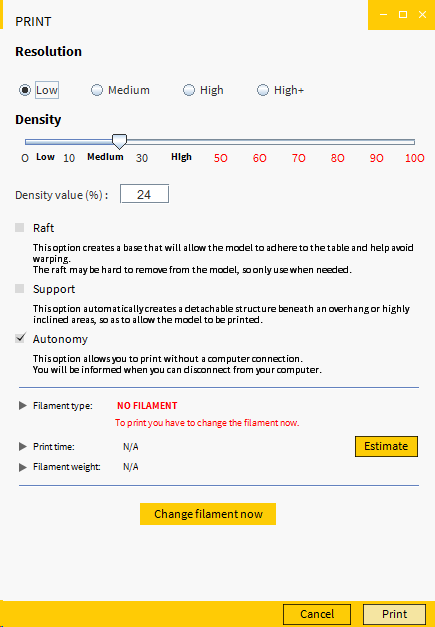

This is what you can alter:
  • Resolution
  • Density
  • Support/Raft/Autonomy
P.S. Some extra tips: If you see this “No Filament” message even if you’ve done everything correctly , simply restart the software. Restarting always helps if something goes wrong with it.

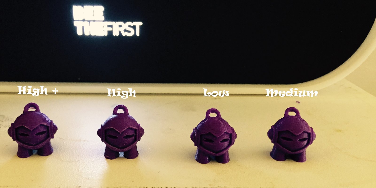

Resolution
Low: This is only if you want the print to be made quick and it looks good only if you print big, flat parts e.g. “Letters”. You want to use this when you print something huge or just want to test out some model quick.

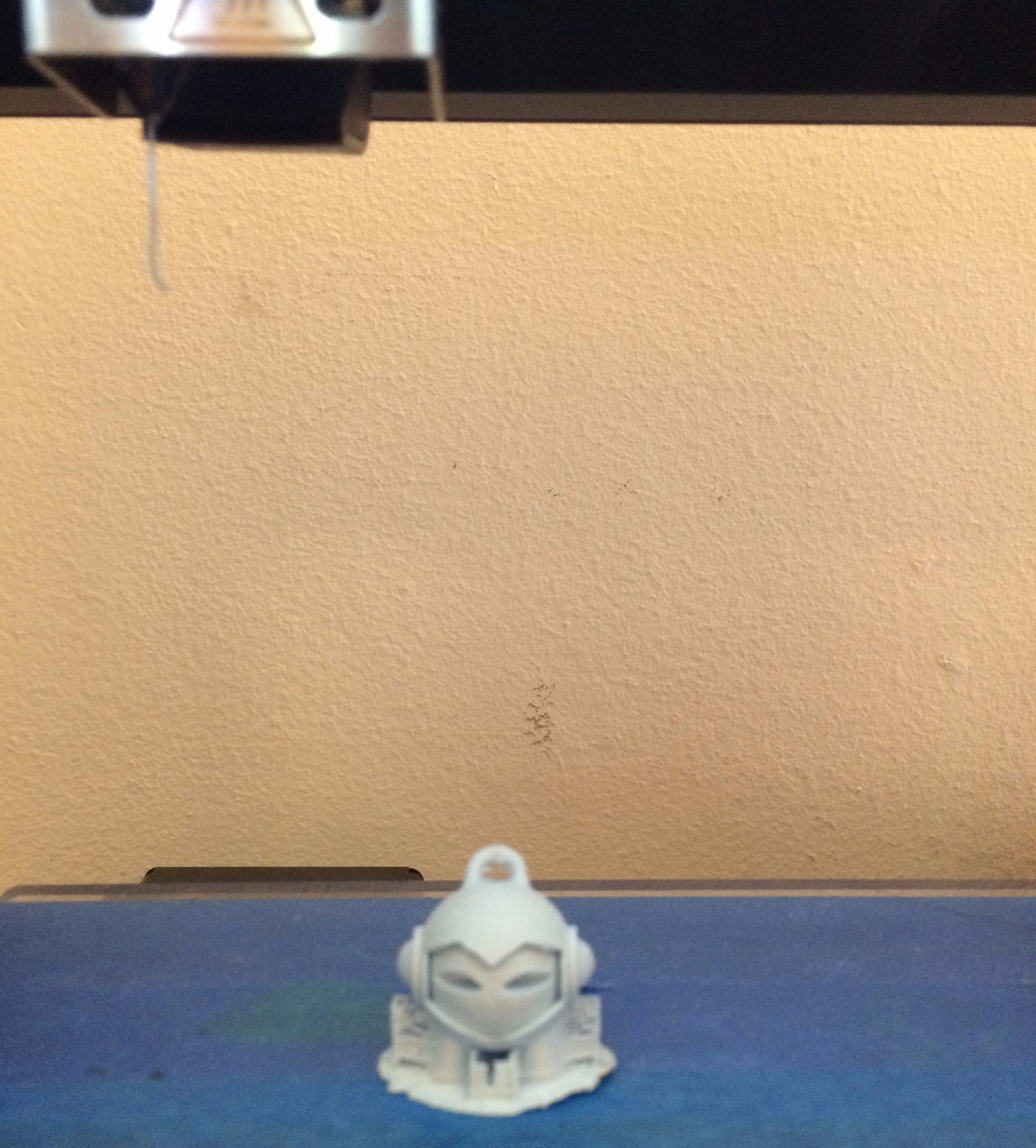

Medium: In my experience , the best Marvins turn out in this resolution setting (it all still depends on the Material used) While the layers are still visible the shell of the print looks fairly smooth . If you’re not sure which resolution to select this is your choice as the first test.
High: and High+: In my tests it was always fairly difficult to tell the difference between these two, however both provide smooth prints and when printing more detail required big prints it is the best option.
Density
As with many other printers, having 15%-20% Infill has proven to be the best setting to balance out the strength of the model, material used and printing time.
Support & Raft:
These are working as intended: if the 3D model has an overhang of more than 45 degrees, use support. Since you can only print PLA with this printer, the Raft serves the purpose of stabilizing the model with small footprints by creating a strong foundation for your print.
Autonomy
This is automatically selected and I it is very handy. Unless you have your printer right next to the computer this is a life-saver , because as soon as it loads the model you’re free to unplug your computer from the printer.

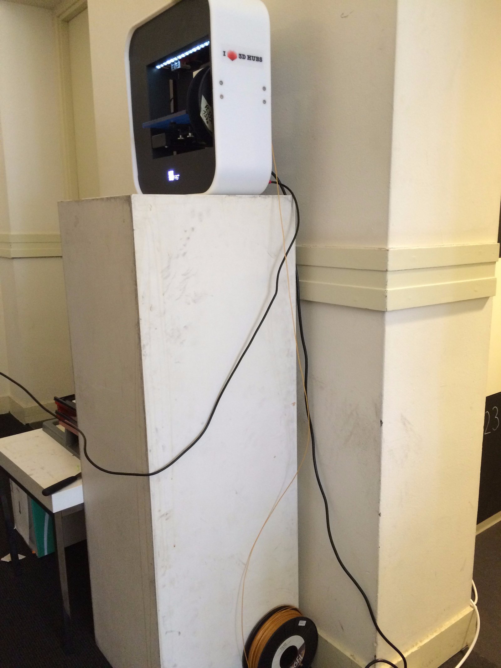

Not to mention, sine the spool-holder is quite small you’ll have a hard time placing the bigger spools somewhere next to the printer. My advice is to print the stand itself like shown here.
Otherwise, you’ll have a similar problem :

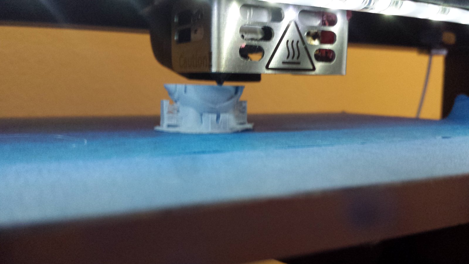

Could it be possible that temperature on BTF is not stable throughout the print? What seems odd to me is that it does a good job at first, meaning it is perfectly capable of processing the plastic. Maybe the temperature drops down at some point during the print?
I think the temperature at the extruder is stable, but the temperature of its surroundings is not.The area around the extruder can get hotter during the print and the temperature affects the PLA, and this could jam the extruder. You can also try to take off the top white cover of the printer in order to cool down a little bit the extruder area. :slight_smile:
Good one! Or isolate the printer somehow to keep the temperature higher in case you need that
Hi Sergius!
I took off the cover and it did a little better, it almost finished the job! but then it stopped again :frowning:
Without the cover I noticed the extruder wasn’t exactly “jammed”, it was more like it cooled down and the filament wasn’t melting anymore. Next step is find a way to keep the temperature higher, as suggested by @derKarsten, hope it works!
