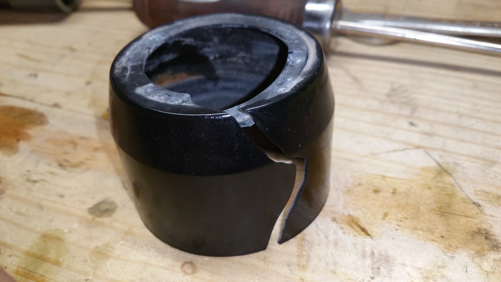

I am currently rebuilding an old motorcycle and am needing to come up with a way to make some new shock shrouds.
They were made using injection mold and I am not sure of their makeup but I think ABS would be the best bet. My only worry is that the parts are smooth and glossy and my idea of a 3D printed part is far from that.
I am new to this entire process however have created a 3D drawing of the part. I have looked online at other places for quotes but with so many different materials and techniques im lost when it comes to picking the right material and techniques to get what I am wanting without having to cut off an arm and a leg.

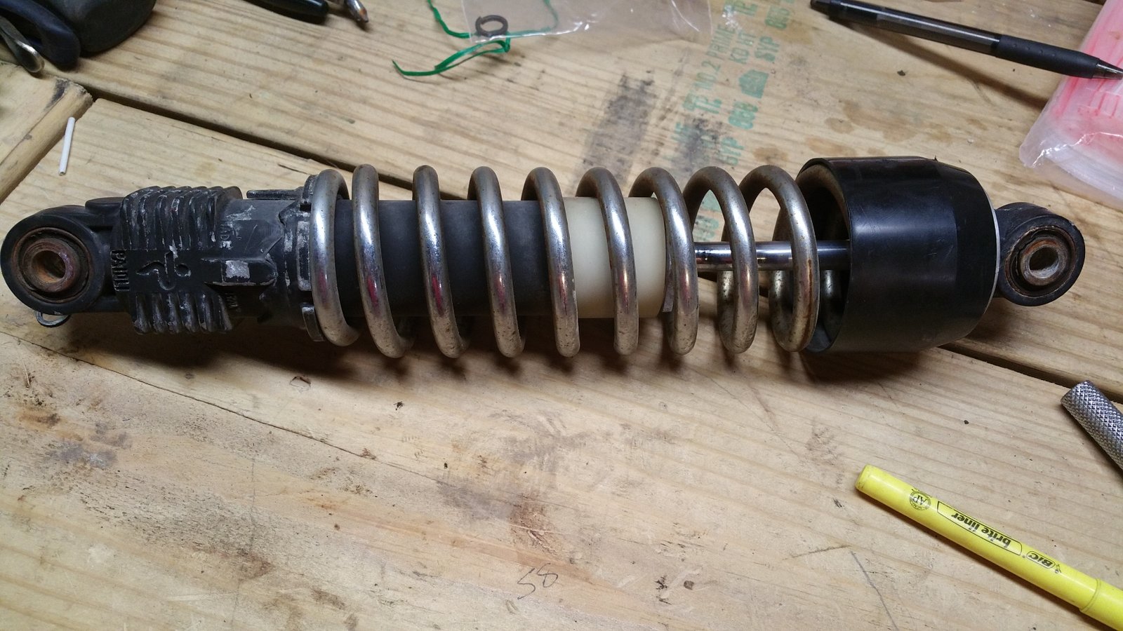

All of that being said, where does this part sit on the bike? It looks like a spring from a soft-tail. How much distance is there from the exhaust/other hot bits once this is mounted on the bike? I am a little concerned about heat and the abs becoming soft but that all depends on where it is mounted while the bike is being operated. There are other material options available such as PC filament and even some reflective paints you would try but heat is definitely something to consider while deciding on material.

The part is non functional and sits pretty high above the exhaust.
The bike is a 1983 Triumph TSX and Ive not been able to find the shrouds anywhere (others with this bike have also been looking for years).
The attachment isn’t my bike but the same model which shows you a little better where the part sits.
If you want to have an exact replica, and have a undamaged one, you can make a solicone mould from the undamaged one,
then you can make multiple of copies, in a strong polyurethane black pigmented resin.
that would only work if it’s just a cover and not a functional part :slight_smile:
The part will have the same color and exact gloss/matt finished as the original, and the polyurethane is just as good as ABS.
I have done this a few times with really good results and the copy is undistinguishable from the original part.
Oh yeah, an ABS material would be fine for that, how thick is the wall of the part? If you want I could quote it for you, or you could find pretty much any hub on here with the capability to print ABS.
Molding it would give you almost an exact replica but its pretty labor intensive (read expensive) and that level of detail capture is rarely necessary.
