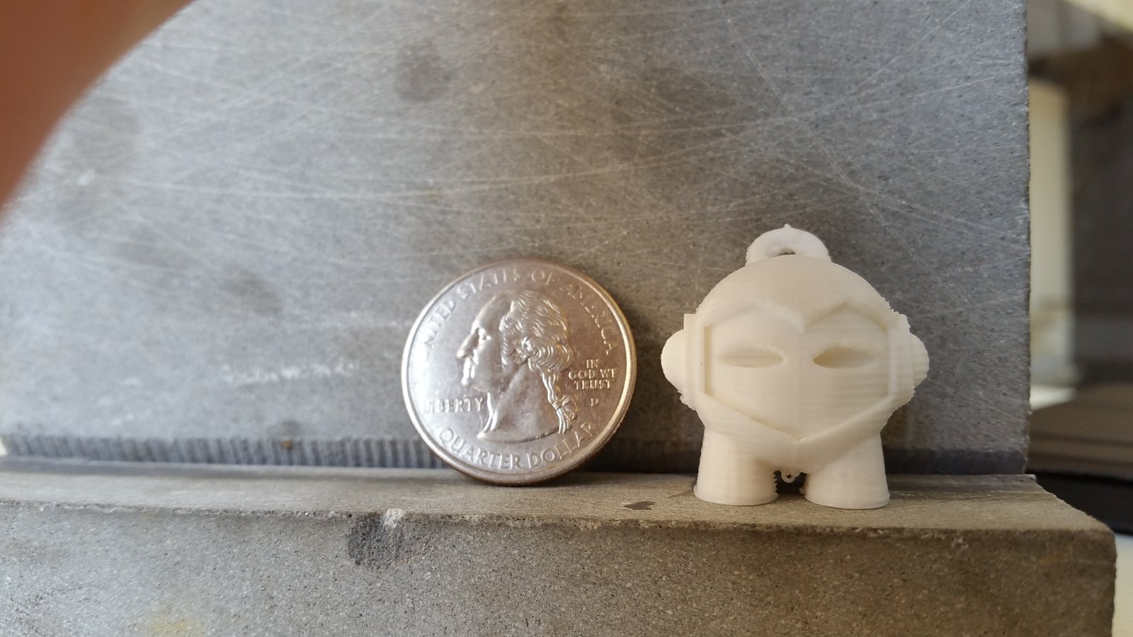

Hey guys, if you have any prints to show off the Hatchbox filaments, go ahead and share them! Nothing like a shown’n’tell to see the the quality of the filament. I’m sure many people are curious to see them!
White pla hatchbox on M3D
I use Hatchbox and it works well, but I don’t have experience with any other filaments, yet.
hmm I actually has been using it with temp around 195 or 200. above this temp I find it too stringy…

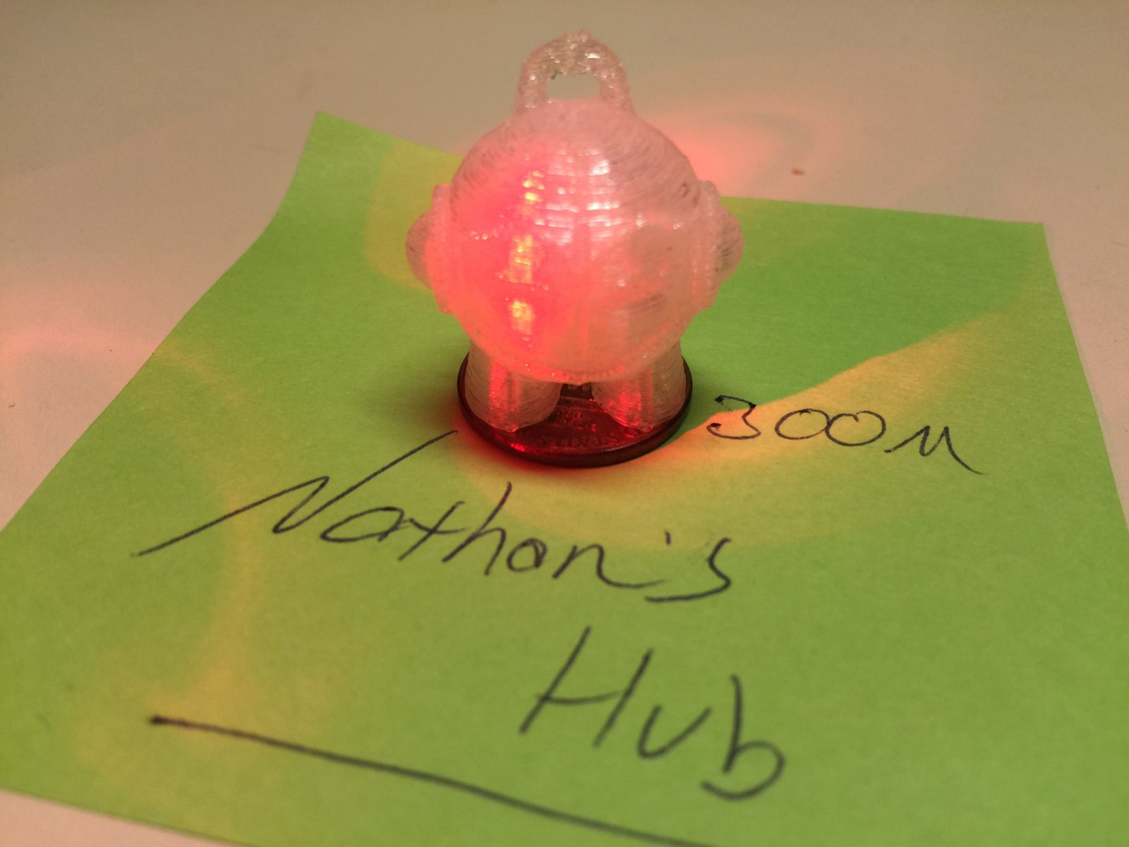

Nice print! I’ve been using some clear PLA from Makergeeks with decent results.
