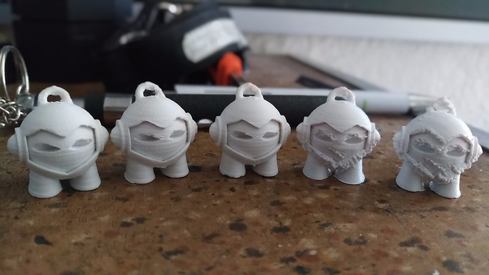

the one on the left looks good, the one on the right is really bad. were they printed one after the other or all at once ? Were they printed at different resolutions. The devil is in the detail, we need to know the detail.

All printed with varied settings…
Further most left (260 nozzle, 110 bed, 50% speed, 60% fans)
further most right (230 nozzle, 90 bed, 100% speed, fans off)
The ones on between with varying mixed settings.
Always at 0.1 line height.
I think that’s everything…

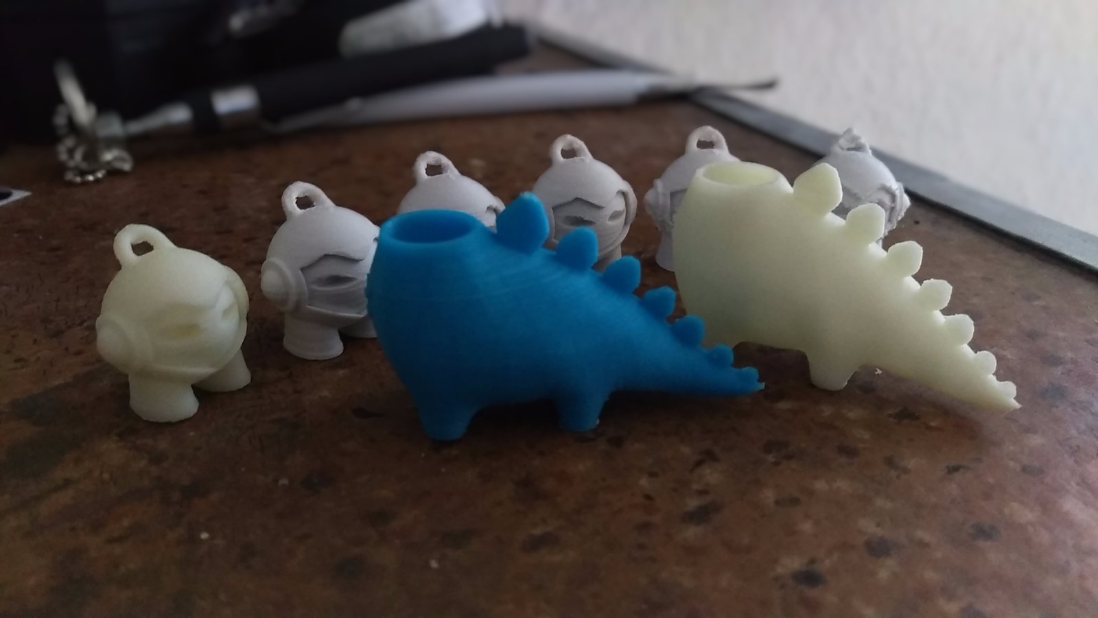

Thought I would add, I had some really nice results with some glow ABS i bought (manufacturer unknown) printed with settings: (260 nozzle, 110 bed, 50% speed, 60% fans)
