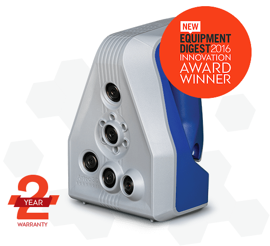

From my research into this and with a fairly unlimited budget as it would be for my employer, I’ve found that the Artec Space Spider gave really nice results and it was fairly fast and picked up fairly small details with good accuracy. Granted, it’s still a $30K+ machine, but it did the job really well. Creaform and Nikkon also have some nice machines, but you’re looking at even more money. For the cheaper scanners, such as around $3K, a LOT of the scan detail is based on the software that is used thru post-processing. The NextEngine machine doesn’t have the highest res scans out there, but it uses pretty clever software. The Fuel3D scanner just got a software update to help get better depth with the scans and it’s not terrible for the money. The David3D SLS-2 which is a structured light scanner and can be calibrated for very small or very large objects an the software is quite solid and is about $3k
Consumer 3D scanning is still very much in it’s infancy and is well behind where even 3D printing is on the consumer level. 3D scanning with a consumer grade scanner (under $30k), can’t be utilized in much of any engineering aspect. Most handheld scanners in the $3K range are more for hobbyists and best used with organic shapes. When scanning perfectly flat surfaces, the scan data will nearly always produce noise or anomalies making a perfectly flat surface, less than perfectly flat. Some scanners do a better implementation of hardware technology and advanced software algorithms to do a significantly better job with both data capturing, in different environments, as well as stitching scan data to one another to create a water-tight mesh.
For those looking for 3D scanning to do QC measurement verification, working with engineering parts, or would even like to easily manipulate and modify your 3D scanned objects, then a high end professional scanner is definitely required at this time. Creaform or an equivalent system utilizing Geomagic software from 3DSystems is one of the best options for this type of workflow since you can scan, take measurement, see flat sides as flat and can even export in a way that you can edit the scan data as if it were designed in CAD software.

Since you are talking about small toy object I would recommend looking at the Artec Spider or the Artec Eva scanners. Prices from about $20K to $30K
The Artec scanners produce scans at up to .05mm accuracy.
