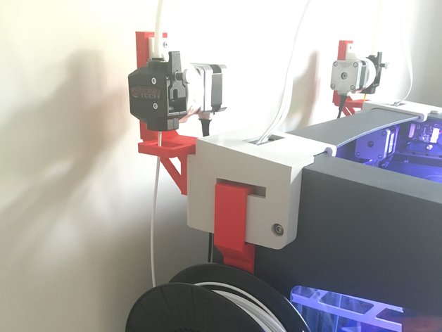

I also got something wich is a complete alternative if it is just not working.
of course you need a pirnter first to print this but u said one extruder is working so there should be no problem.
Hope this you get it working with the standard feeders but if not… there is a way to get it fixed. not pretty but a way.
Hope i Could help.
Eddie.
