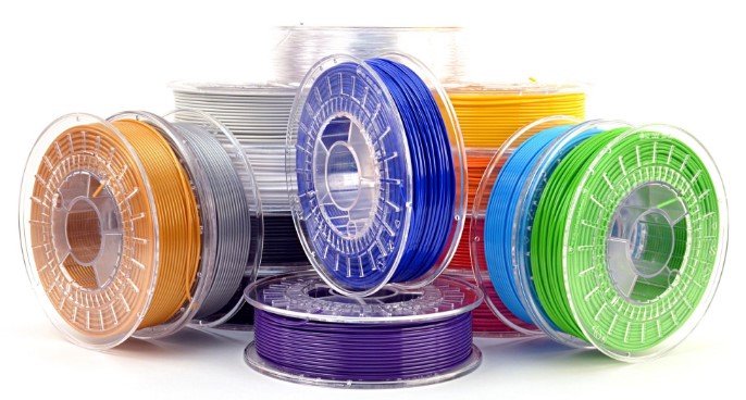

After receiving the sample pack of @ColorFabb filaments, I wanted to test out the BambooFill first on my Printrbot Simple Metal. I’ve run into some issues that I cannot quite figure out how to fix and I am sadly out of my sample to continue testing (will buy more in the future).
