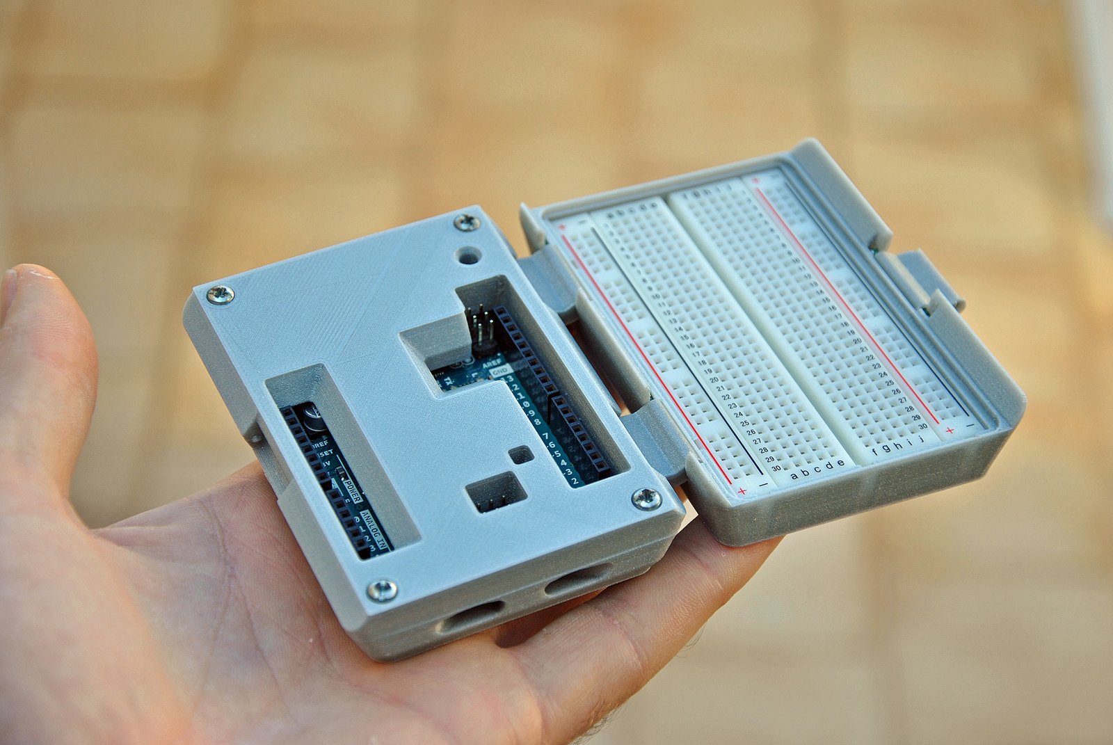

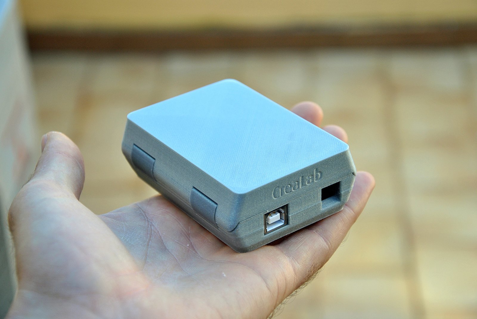

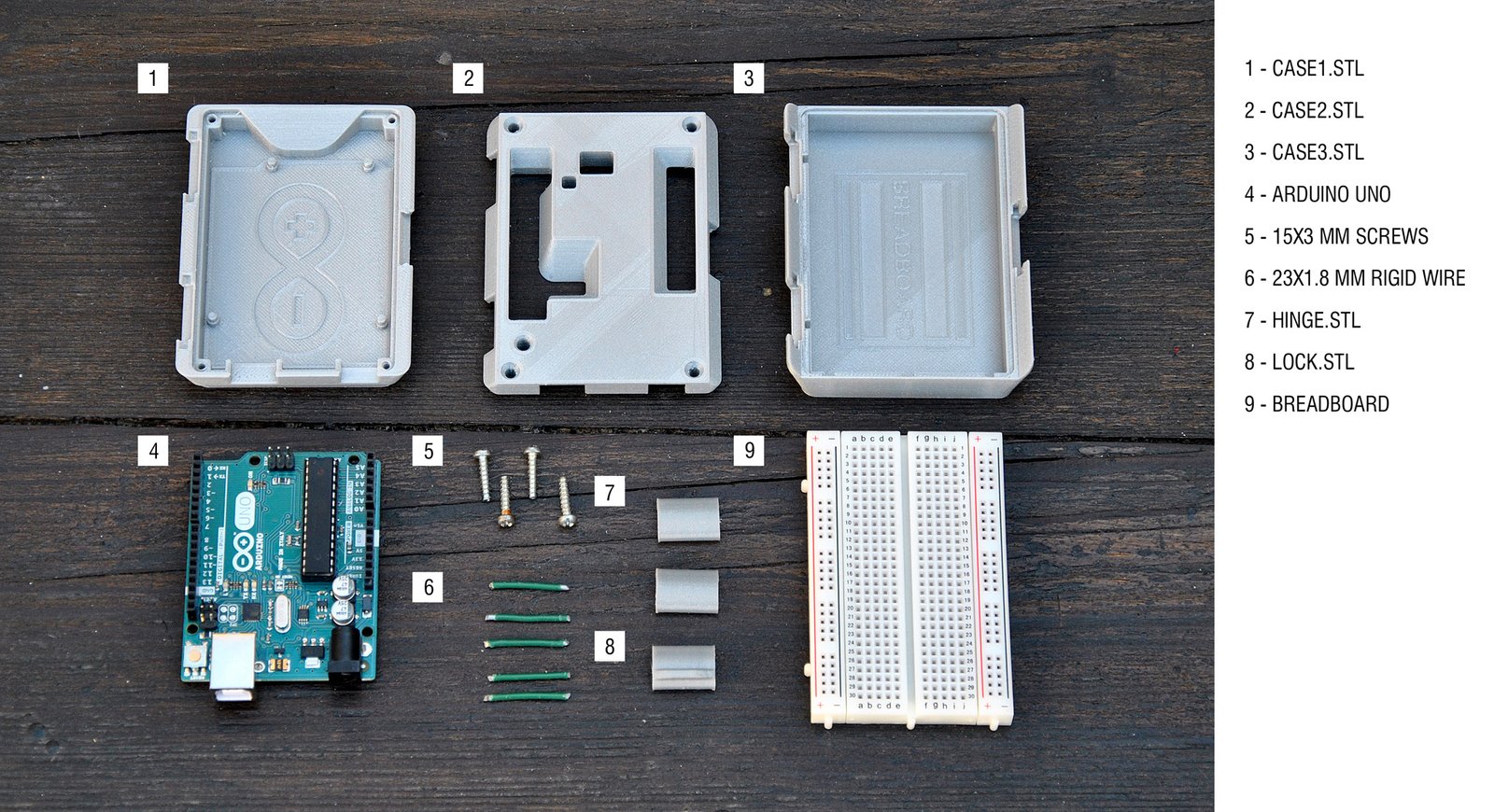

I would like to show you my last creation. It’s a Arduino UNO Portable Lab Case.

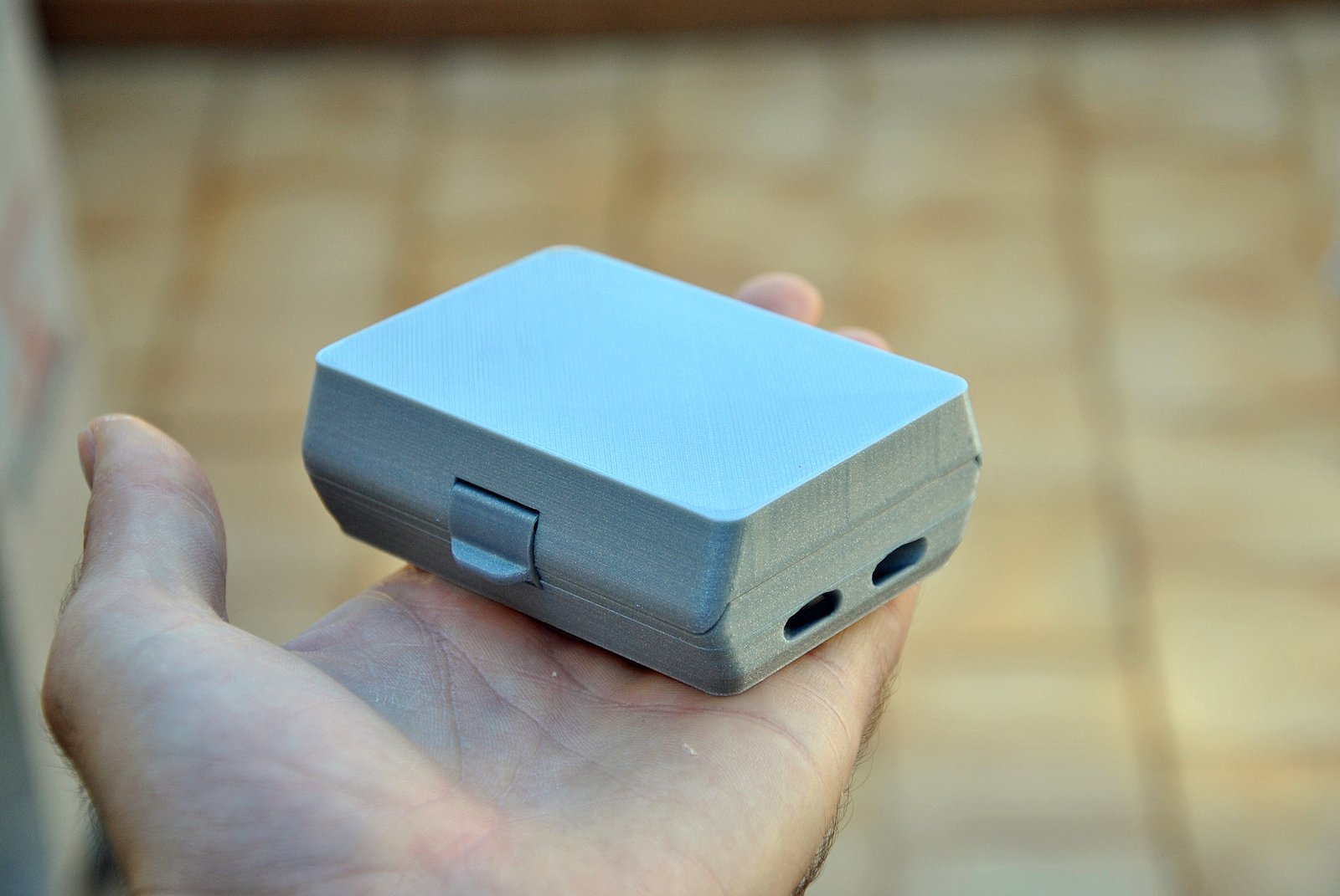

Since I bought my Arduino Starter Kit, I always wanted to design a portable ARDUINO case with an integrated Breadboard. A portable Arduino Lab that i can put in the bag and take it with me. It is a very stylish case, with a solid hinge and lock mechanism. It has two side holes to insert a wrist strap.
Printer: Ultimaker 2
Supports: No
Print Speed: 45 mm/s
Outer Shell Speed: 35 mm/s
Infill: 25%
Layer Height: 150 Micron (0.15 mm)
Shell Thickness: 0.8 mm
Bottom/Top Thickness: 0.8 mm
Available for download here: STL file ARDUINO UNO PORTABLE LAB CASE・Model to download and 3D print・Cults

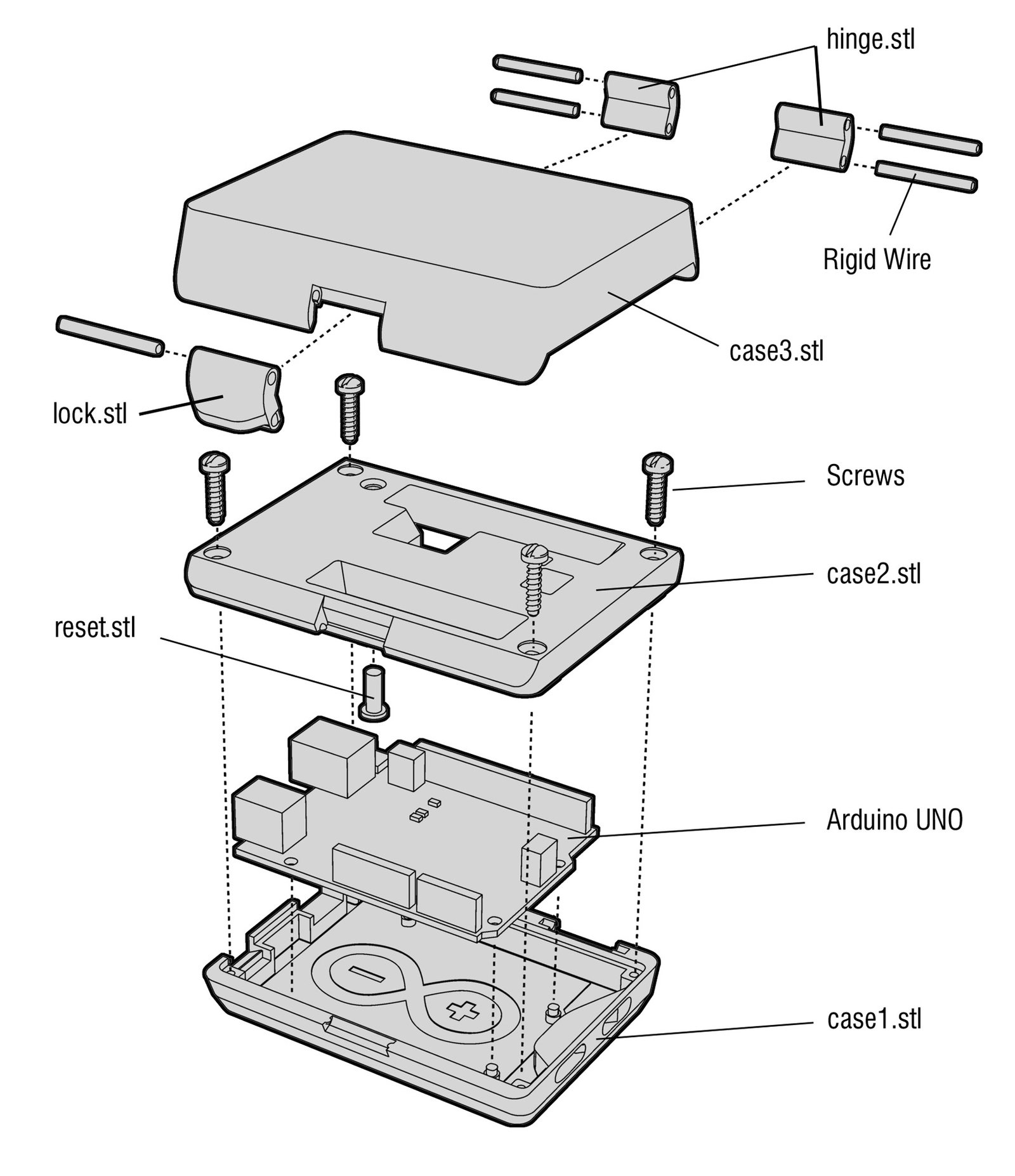

Great work. Just a question; how did you rendered that exploded view?

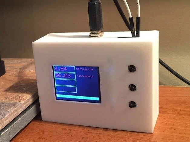

That is a cool case. On a similar line, though not as eloquent a design, I have an experiments platform that revolves around an Arduino Nano and a 1.8" TFT/LCD. The case is built around a custom circuit board that exposes all the pins of the Nano and also allows for six of them to be led through the case.
