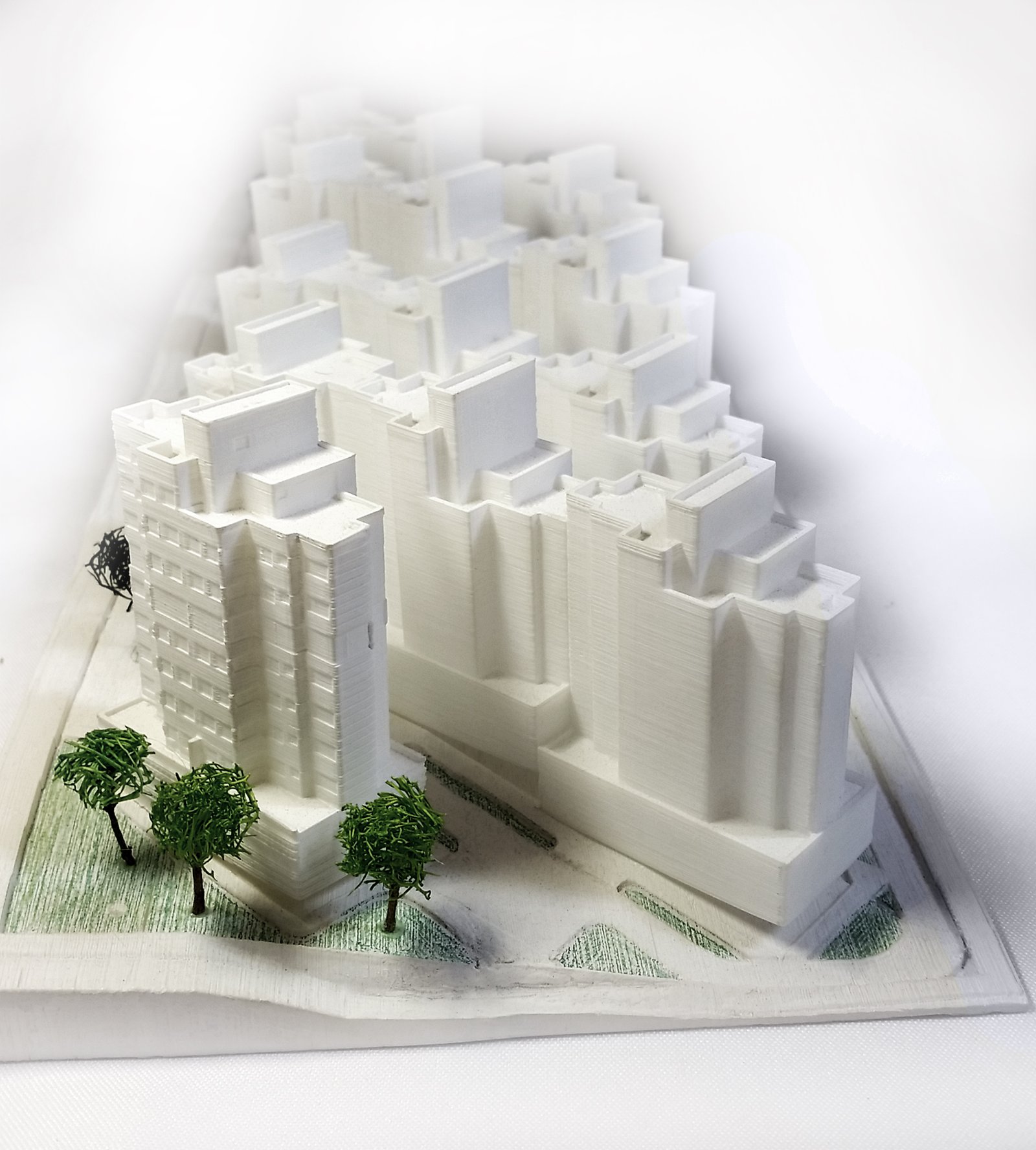

Look some print that i did. this is compost about 9 parts for base and more 9 building. one have more details.
You can print in PLA, this is more easy to print and give better joints if you need to cut your model.
Remember in your modeling respect the minimum detail size, is about 0,6 to 1,0 mm depends what print you will use. of course this is for FDM printers.
An other thing you need to think is about overhangs, if the model need to create some support to print some part, you will have to remove after and some slicer program create a lot of support for some parts an when you remove you damage your model. So if you could separate some detail to print an join after is the best.
For buildings for more than one color or you create separated parts, print and glue together, some printers FDM could print in 2 colors, or have an option to print in SLA printers. Is able to print in lot of colors, but your model need to have this colors predetermined.
