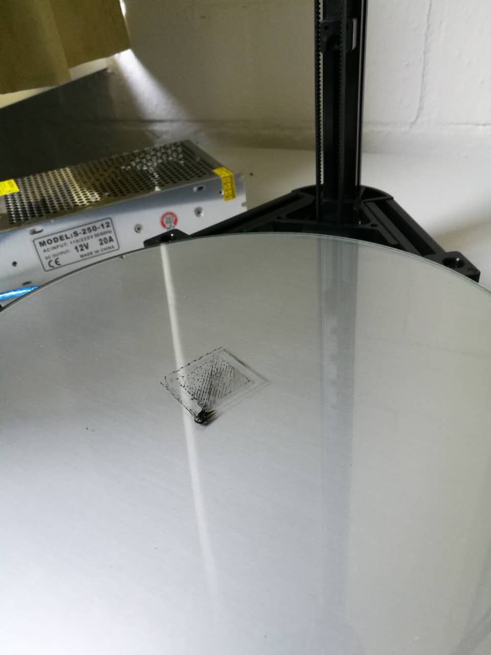

Thank’s for the reply. I check the nozzle with manually extrude the Filament by using Pronterface. The Extrusion worked just fine. There are a little Filament coming out of the nozzle. But it just doesn’t work for test printing. In test Printing(20X20X10) the nozzle seems to move correctly and the two cooling fan work also. But the extrusion motor doesn’t work at all. Only the Filament that I manually feed before was used(picture).
