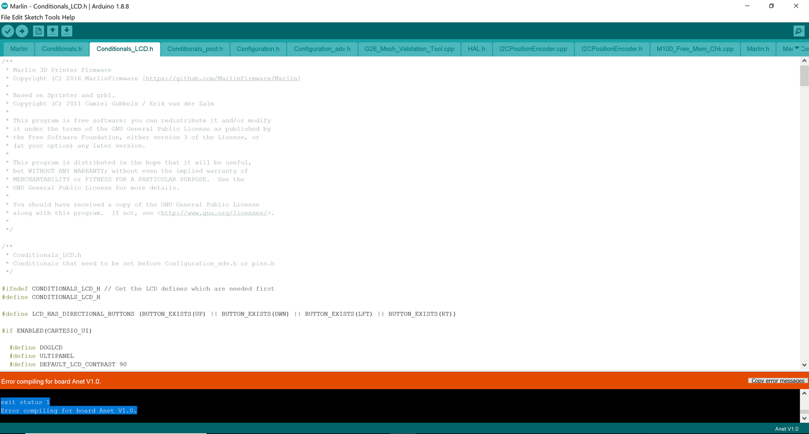

i dont know have to do update firmware Please, can you tell me

Check out this site. Anet A8 [3DPrint.Wiki].
that now that i got
