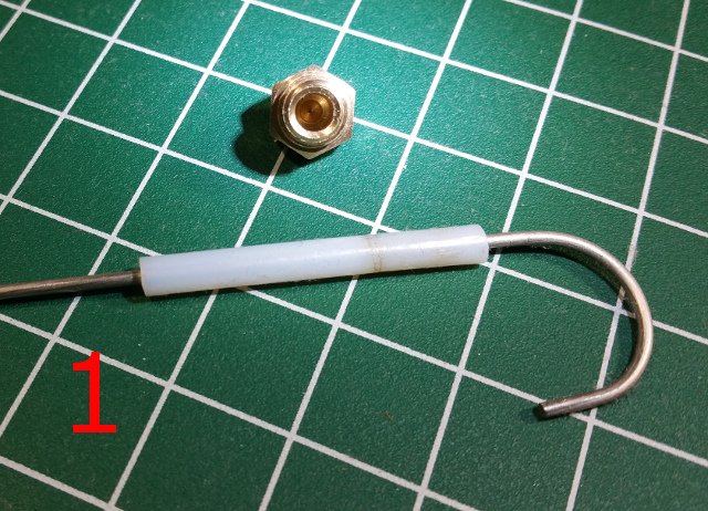

I bought some new nozzles and tried the following (each number corresponds to a picture):
  1. Brand spanking new nozzle. The old plastic throat thing, but clear of obstructions.

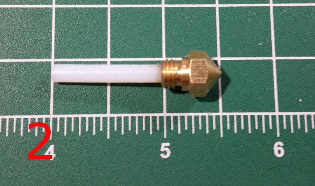

  2. Insert the plastic throat thing into the nozzle all the way.

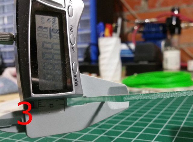

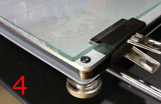

  3. Cut a sheet of 1/8" thick glass to fit. Just plain old glass that used to be in my buddy’s window before the baseball incident. Cleaned it with rubbing alcohol until it squeaked.
  4. Put in on the nicely cleaned aluminum bed with clips (I had previously tried thermal silicone, but it didn’t keep the glass immobile). I adjusted the clips after this pic to ensure they didn’t get in the way of the print head during levelling.

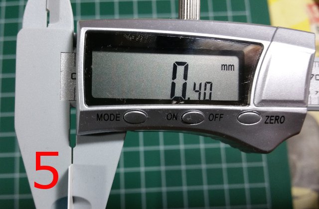

  5. Preheated to ABS temps, then using a 0.40 mm thick business card, I leveled the bed with the built-in auto-leveller. Then I leveled it again. Did this until I went through the auto-level steps without making an adjustment. The way I did it is to place the card where the nozzle will go before the nozzle moved. Then I moved the card back and forth, narrowing the gap until the nozzle stopped the card. Then widened the gap until I could just feel the nozzle against the card as I moved it back and forth. Repeat for each of the five stops the nozzle makes.

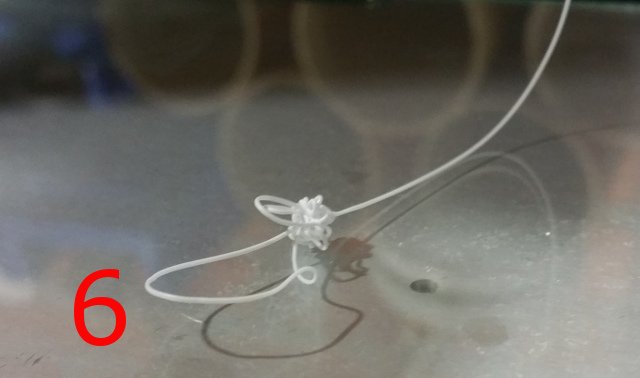

  6. Then I loaded the filament using the “Load filament” button. The filament came out in loops at first, then eventually started coming out straight. I didn’t catch it with the camera in time. You seen in this picture the loops that used to be bunched up directly under the nozzle - now at the end of a long filament. When this happens it’s as if the filament defies gravity. “I’m going down? Nope, lemme just turn around and go back up.”

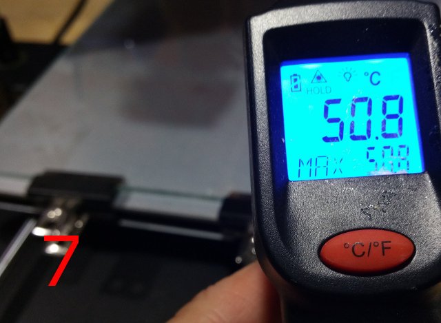

  7. Before trying a print, I checked the bed temperature. I’ve heard the glass makes it not warm up as much. With the LCD telling me the bed temp is 54°C, my thermometer tells me the glass is just under 51°. I’ve checked at different temperatures and the bed is consistently 3-4° cooler than the LCD thinks it is. I think this is okay.

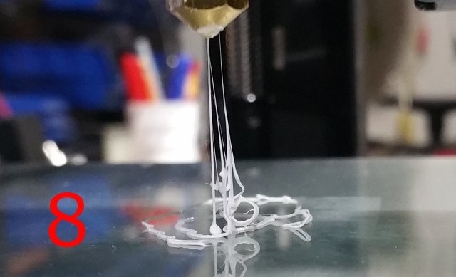

  8. Started a print, and blammo - happened again. The filament loops a bit, giving something to catch on until very quickly I get something like this picture.

In my experience, most filaments will not stick to a clean glass plate, I use 3DLac on mine, but there are other things you can use, such as PVA and some types of hairspray. Regarding clearance, 0.1mm works best for me. For PLA I set the bed temperature to 50C and for ABS I use 100C…
When I’ve encounters issues like this it has been down to the temperature gradient between extruder and bed, and or the extruder temp not been high enough for the material been used (I’ve found this can vary by brand) try hoping the extruder temp by 10-15C and the bed temp by 5-10C.
Have you tried reducing first layer print speed? I don’t have a i3 Plus, just a v2 and v2.1, but when I troubleshoot, I like to turn down print speed much lower just so I can watch what’s happening easier. If you’re printing directly to glass without something like hairspray or glue, it can sometimes be hard for material to stick when printing quickly.
I can’t tell from the video, but I assume the fan is off for the first layer, otherwise that would cause issue as well. As far as the filament curling out the nozzle, that’s normal for all my printers, just one side will naturally cool faster and give it a curved look.
Anyways, try going as far down as 10% print speed just to see what happens and even raising the extrusion temperature a bit to see if it grips the glass better. Just my two cents.
Simple - use an adhesive on the build plate (in theory clean glass should work but I’ve never had a lot of success). Pritt Stick or even better 3D Lac . ABS has a tendancy to warp especially if in an unenclosed build space (like yours). Try PLA or even better PETG (so called ABS substitute without all the grief of ABS). Pardon the puin but stick with it - your doing nothing wrong.
use blue tape, kapton tape, hair spray, glue stick, 3DLac,
PET tape, PEI sheet (my favorite, very durable nothing else required for adhesion), check your levels you seems to be leveled ok but just redo it. Get a feeler gauge like https://www.google.com/aclk?sa=l&ai=DChcSEwjN4fDU6YXUAhWZSg0KHYf3COMYABABGgJxYg&sig=AOD64\_28oMhdf3w5jisRfMpwz5SkQ2ayag&ctype=5&q=&ved=0ahUKEwidq-7U6YXUAhUDKCYKHYWMBywQwzwIBA&adurl= if you need a little help. other wise clear your nozzle out, maybe an oiler to help with clogging (I wouldn’t use it now a days, I do however use a dust collector for my filament). turn your heat up on your print bed to 70c. My i3 is usually form 60-70c with PEI sheet for adhesion. Everything else looks fine to me… oo and I would slow down the first layer to about half of your other layers.

BTW some of your issues with the nozzle may have been a clog from when you had misleveled it and it scraped up material into the nozzle end.

I honestly think the default print surface is way better than glass or tape or pretty much anything apart from maybe PEI.

Print adhesion requires you to play around with some simple stuff. First make sure it’s a good surface for adhesion. There are a million ideas on what that means. I still use the stick on surface that came with mine. Second experiment with temps. Hot bed temp and nozzle temp adjustments make a huge difference for surface adhesion play around ±10C layer.

For the nozzle yours should be ok as far the video shows but the best ones out there are Micro Swiss Mk10 All M​etal Hotend Upgrade Kit
That doesn’t need PTFE tubing at all and also makes it easier to insert filaments. I the stock one was the worst.
Also did you took the buildtak surface on your bed?

I thought I had damaged the original buildtak surface. It was certainly after I gouged it the problems started. I first replaced it with the spare that came with the printer (way easier to remove and clean than I’ve read). When that didn’t solve the problem I switched to glass.
I should have been clearer in my post: I’m using PLA. The picture I took was after pressing the preheat button for PLA - it got up to 54°C and my thermometer read 50.8°. I tried at various temps and found the thermometer read 3-4° lower than what the printer’s LCD tells me. That was the point I was trying to make. The actual gcodes heated higher (I’ll have to look them up)

I will probably try hairspray first. The skirt definitely looks like it should help (I said “brim” in my OP, but I meant “skirt”). As you see in my first vid, it didn’t work (not to say I will stop doing that! it still is a good idea)
