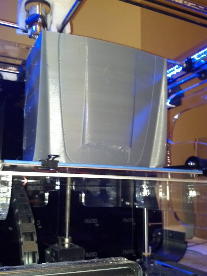

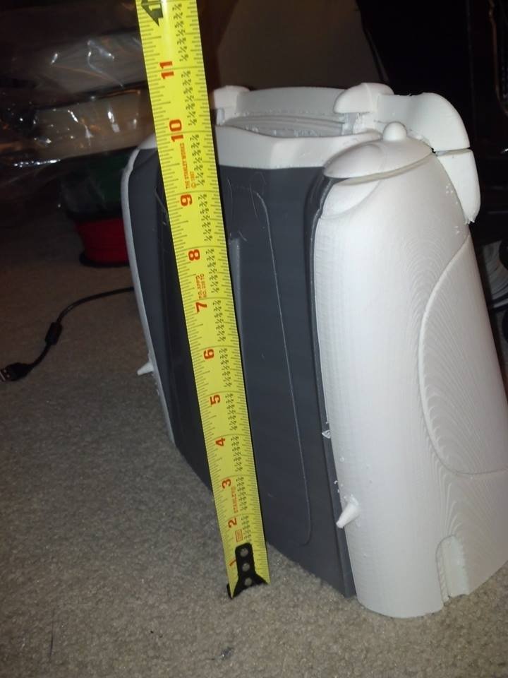

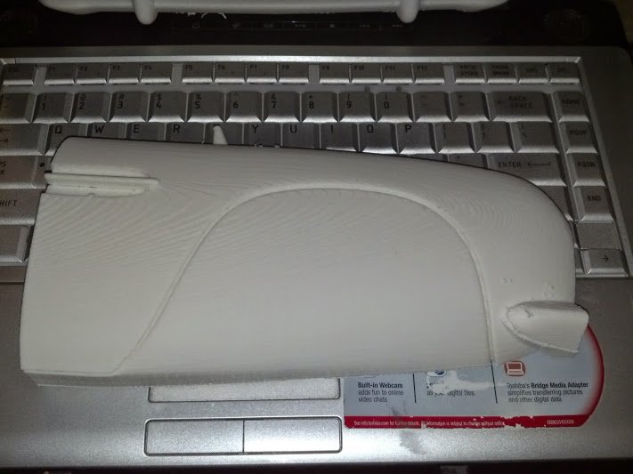

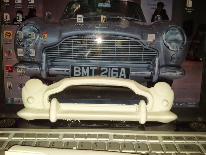

Hi I’m experiencing the same issues with clogging on my Airwolf HDX using only 2.85 mm platinum ABS filament purchased from Airwolf mid January 2015. I seem to be getting 3 to 4 decent large prints (11.6 inches wide 1 inche high in Z height) using Cura, and then I tried a taller and faster print and it clogged. I even experienced a clogged nozzle trying to print one of the vases off the company provided SD chip. So my printer does not work well on the fast print settings but prints decent on the normal or fine .15 to 0.06mm. After doing research, I found a printing group on youtube https://www.youtube.com/watch?v=Kihip31Ari8
and they had some good suggestions when printing ABS and PLA. and here are some of my useful suggestions:
1. For ABS: Print the first layer at 260C and then change the remainder of the print at 240C. (from the youtube group)
2. Heat the bed first and the Extruder 2nd and print minutes after.
3. After printing, retract the filament about 10 mm
4. Check the feeding assembly for dirty flakes of filament before printing your next print
5. Have an extra nozzle on hand in case you get another clog
So my question is IF we all are getting clogs with 0.5 mm nozzles, wouldn’t it make sense to make a 0.75 mm nozzle or even a 1 mm diameter nozzle for really large parts? Attached are some successful parts (Aston Martin Model parts)…
