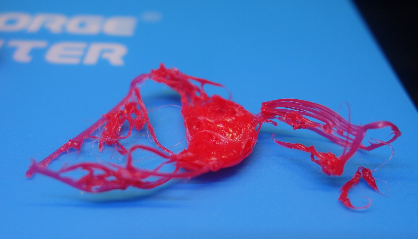

First, I couldn’t get PLA to stick to the blue bed causing an ugly pile up.

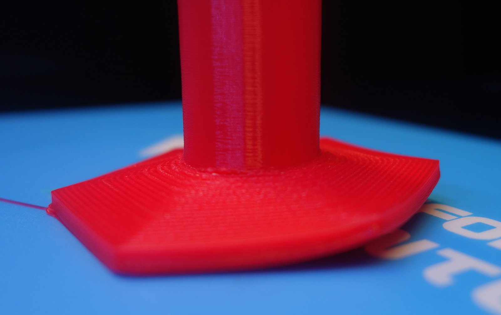

Still, the 1st layer is a little shaky. It does stick in most places but often has irregularities and later on during the print the whole base warps upwards (see bottom right below).

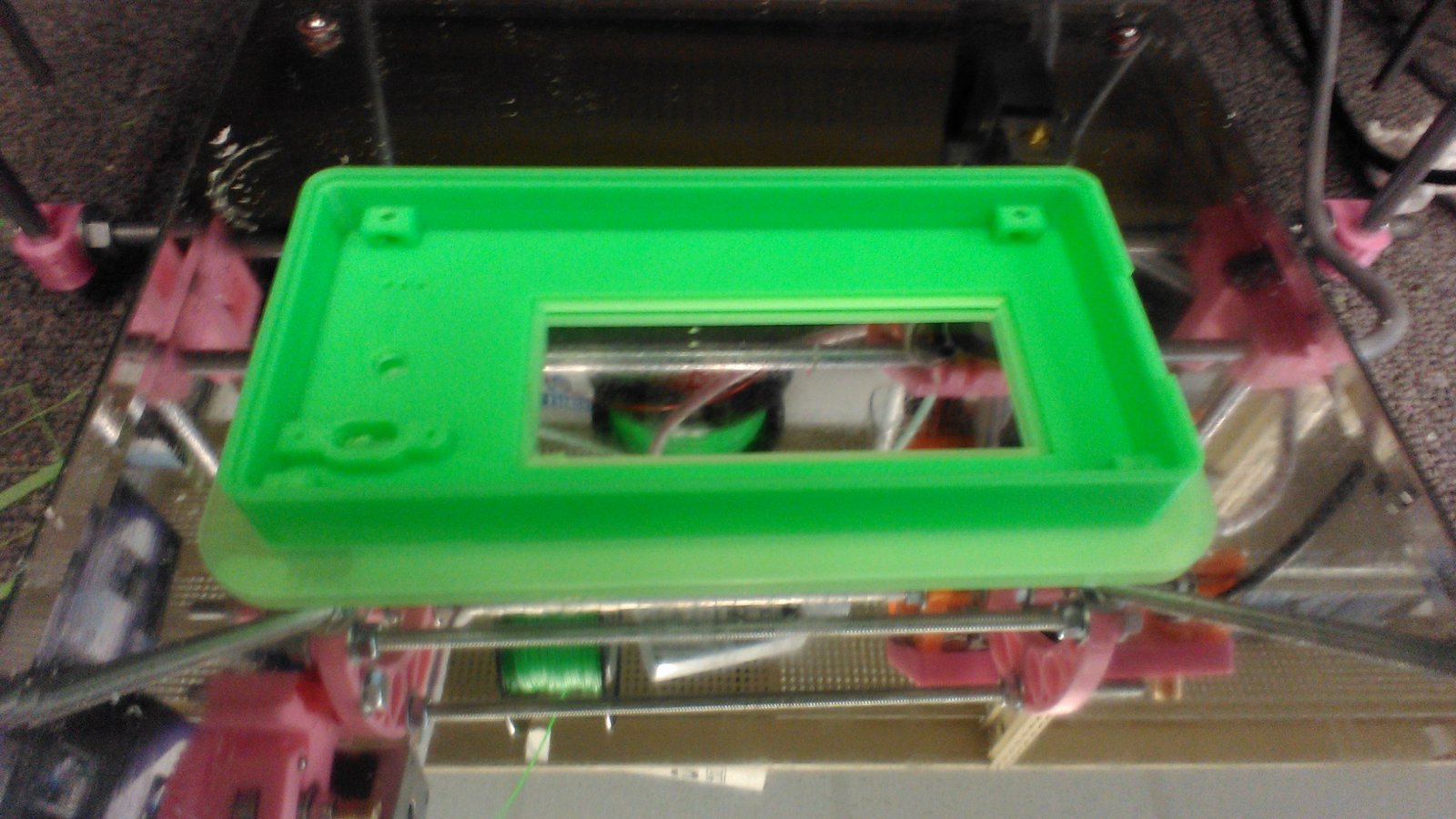

I’ve never worked with the blue pads that come with the FFCP now. Mine came with Kapton tape and I could never get the PLA to stick so I just ripped it off and used painters tape and a glue stick. Worked great. BUT I saw the same issue with warping and the reason for that is that the aluminium plate wraps some when heated, and overtime it seems only to get worse.
I eventually when with a quarter inch glass plate. It is nice and flat and doesn’t warp; it is easy to prep and clean (I still use a glue stick over hairspray, I get a better result); I can also remove is and work my prints off the plate with more room and less worry about damaging my printer. Keep in mind that with a glass bed you may need to run your heat on the bed a bit higher than normal. The glass bed is the single best upgrade I’ve made to my printer, an active cooling duct and fan is a close second.
