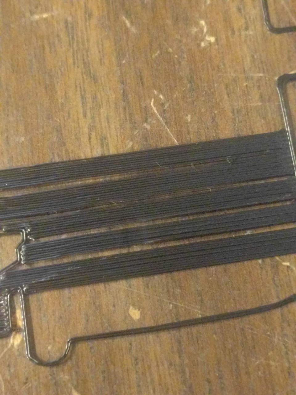

When I try to print with ABS, it seems to stop extruding mid print, then resume. It leaves holes and gaps in the layers where the plastic extrusion slows down and strings out, then starts coming out again. I have tried both ReplicatorG and Makerbot Desktop, slower print speeds, faster feed rates, and more. PLA prints perfectly and doesn’t exhibit these issues. Does anyone have any ideas as to what could be happening?

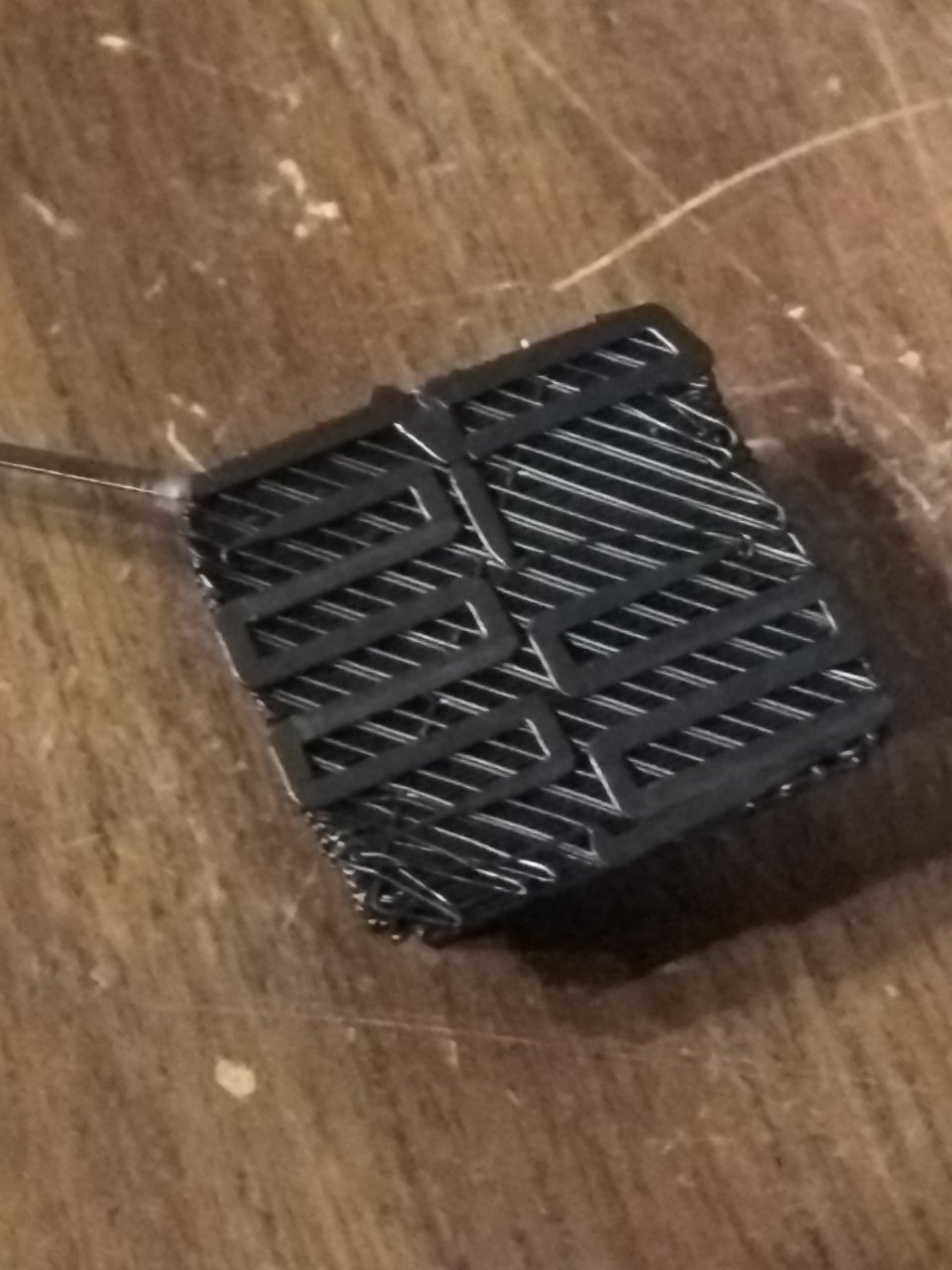

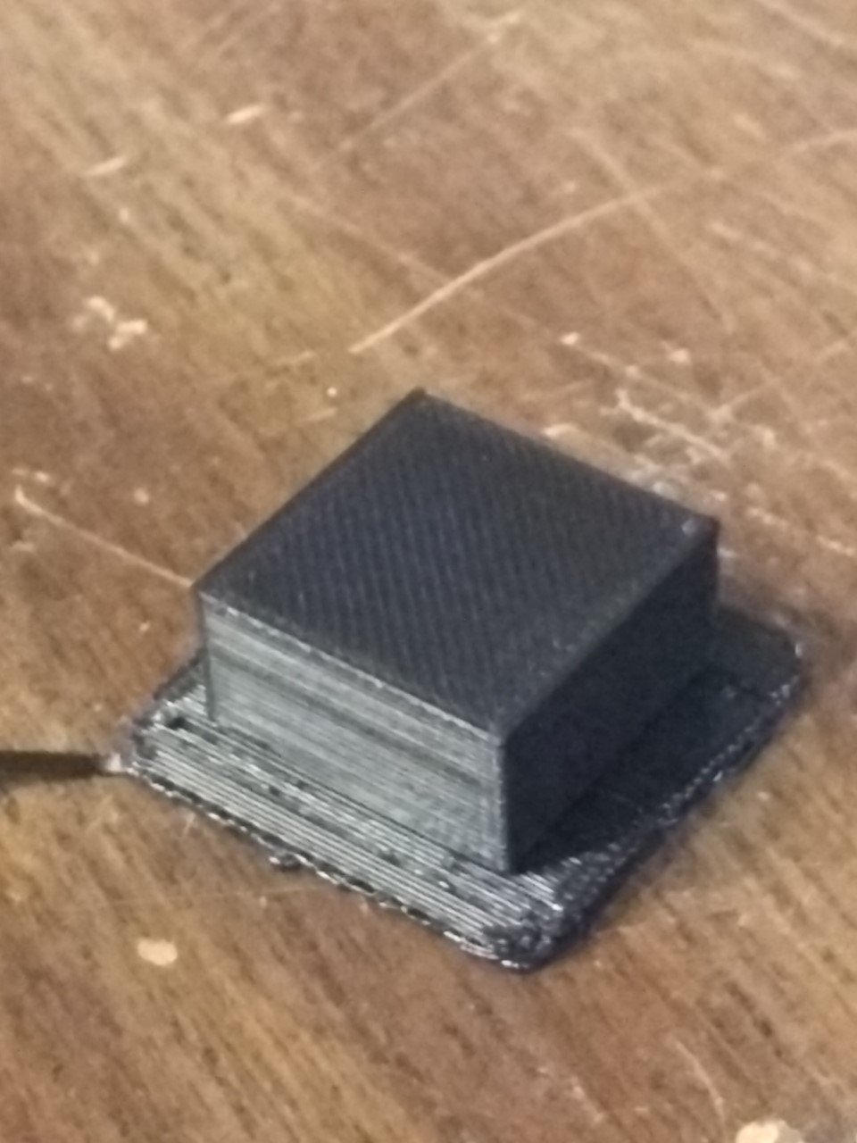

I just printed a test cube and you can see where it stopped extruding when it was building the raft a couple of times. First on the bottom, then again as it was about to start printing the cube. The cube itself printed well aside from some slump from poor support where the raft hadn’t been fully printed.
