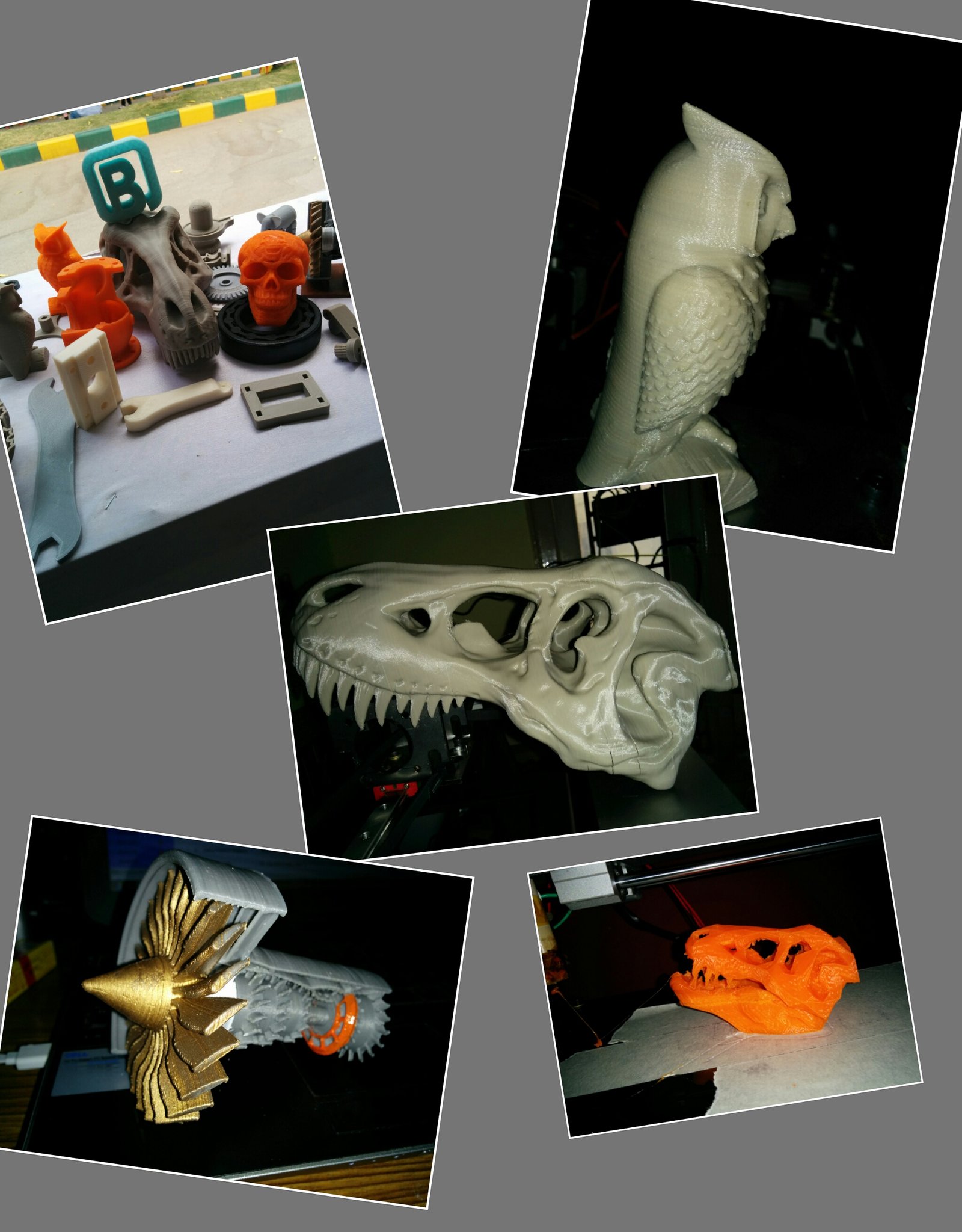

printbed @ 110 and extrusion temp at 235 with no fan, using a glue stick coat along with proper bed level shall for sure help.
attached few Eg here.
