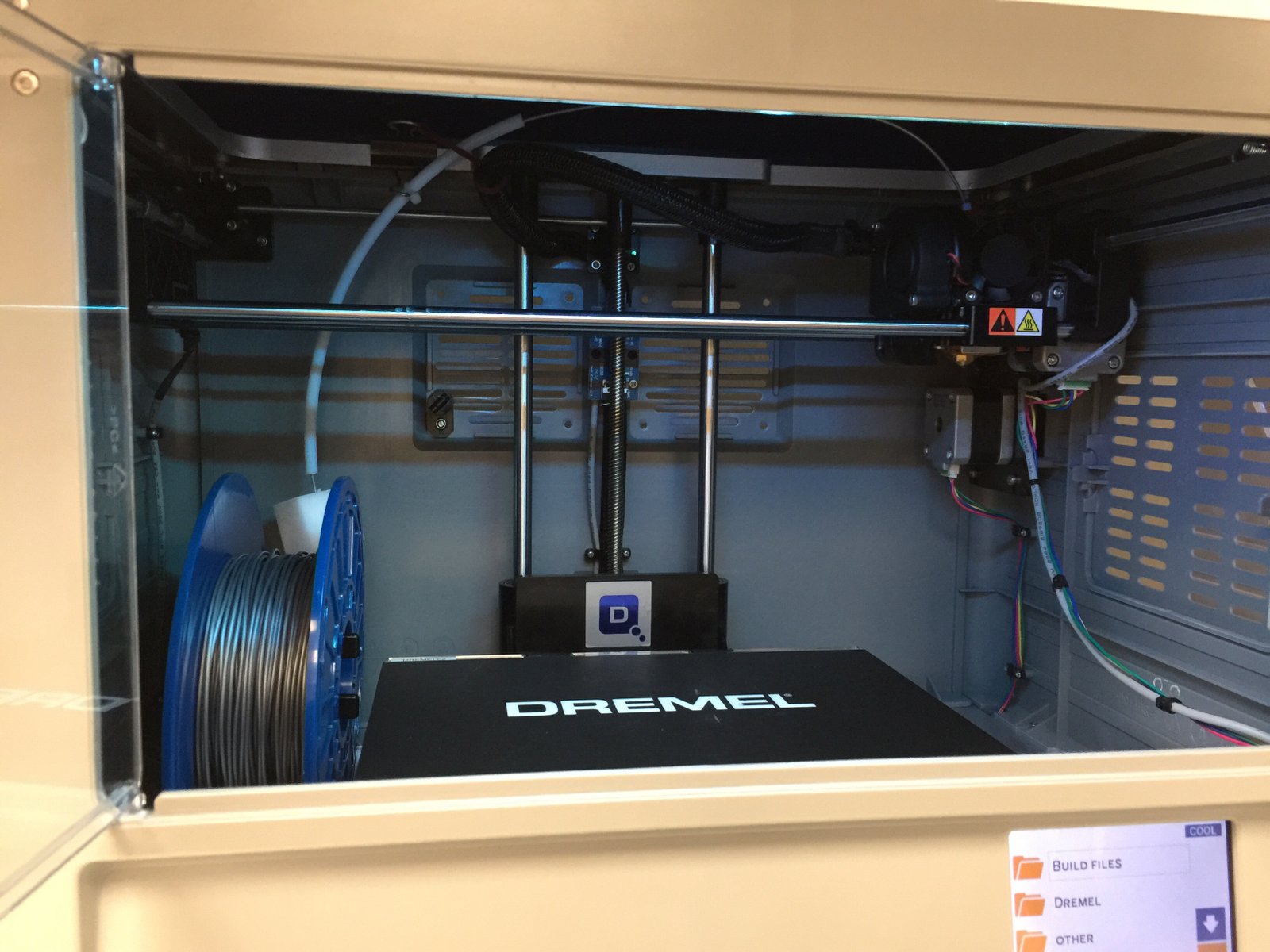

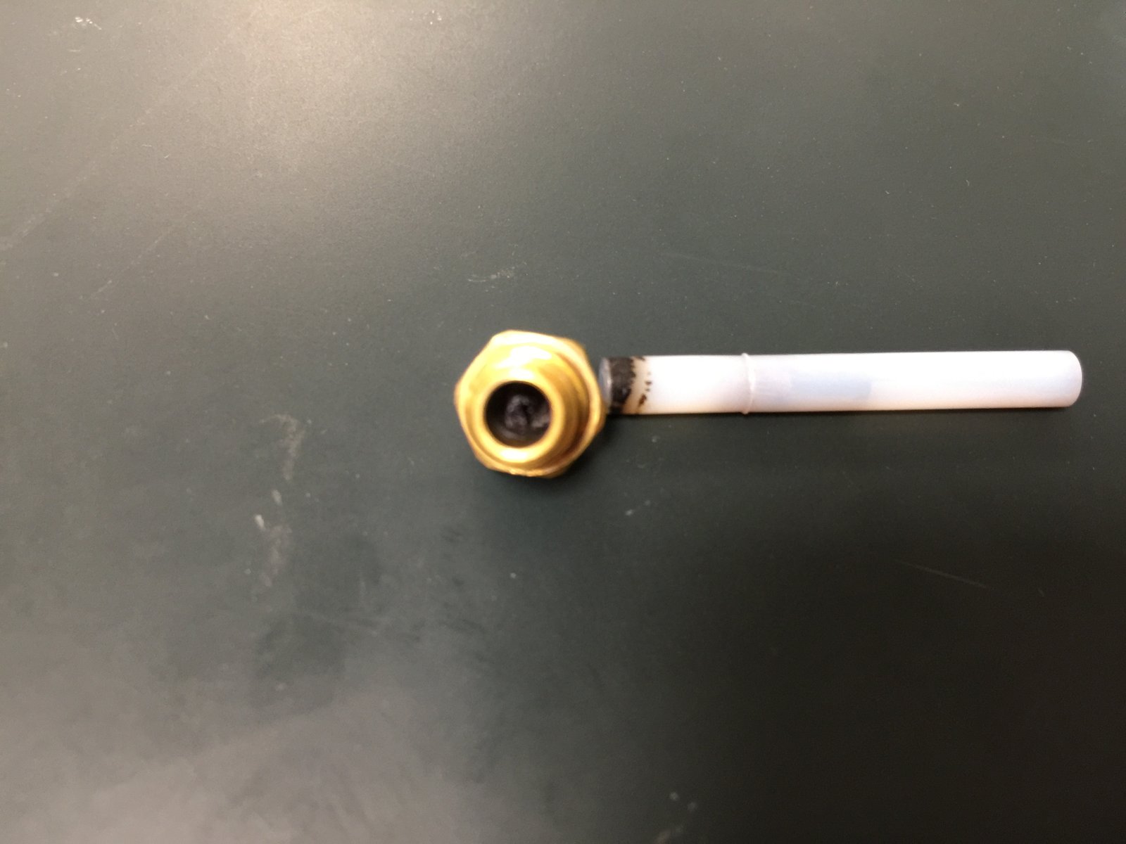

Try open the two screw at heatsink there and look inside extruded part maybe something blocking there. See picture. The second one maybe be ptfe tube meltdown in the nozzle. Just open the nozzle and check it out. Maybe it time to change new nozzle. Good Luck.

Yup. Simple design and upgrade. Save a lot of problem. Specially the dremel filament with rough that will grind the housing. I just cut the give ptfe tubing.
If your nozzle like the picture show. Just change them :slight_smile:

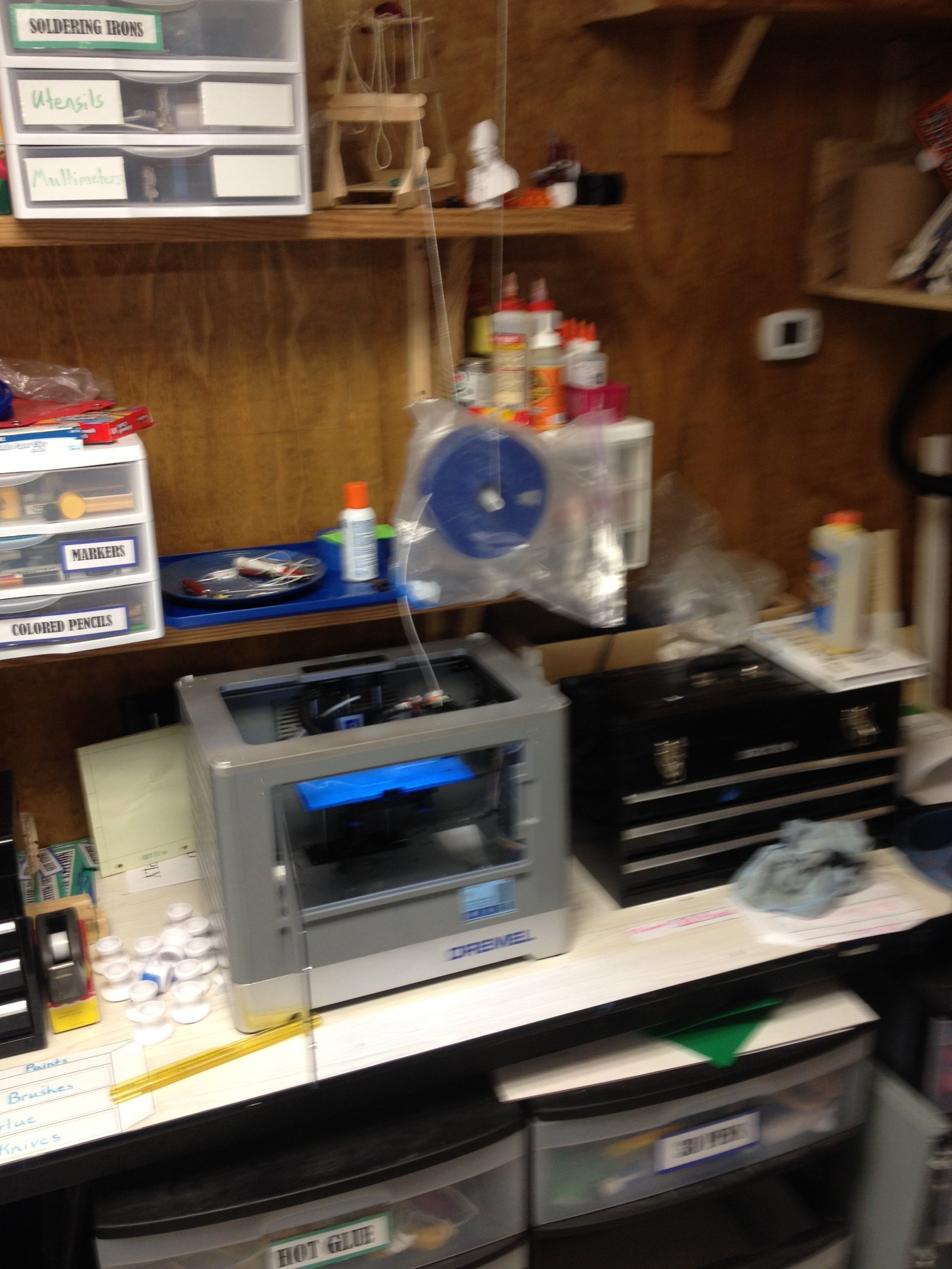

Cool! I may try that. I am also putting the filament out of te printer so that it doesn’t have to arc over and rub on everything. Going to hang the roll from the ceiling right over the machine.

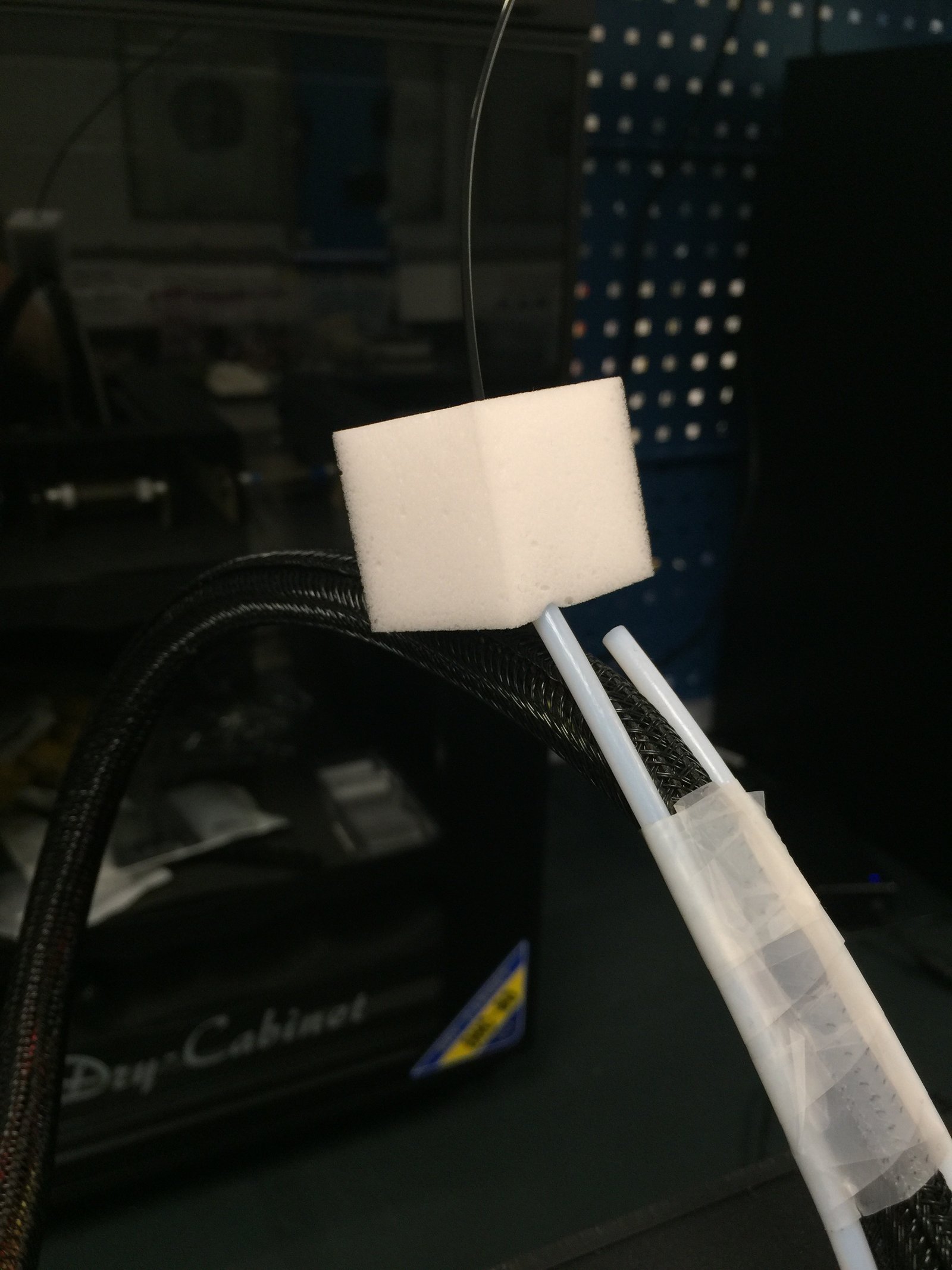

Then I will recommend using some sponge to clean the filament before enter machine. And big lock & lock box to keep filament dry.
Happy printing :slight_smile:
My motto has become Looks Bad Works Good- this alone has given me some success, tomorrow I’ll get the sponge on there. I think I shall actually design and print a hanging box.
