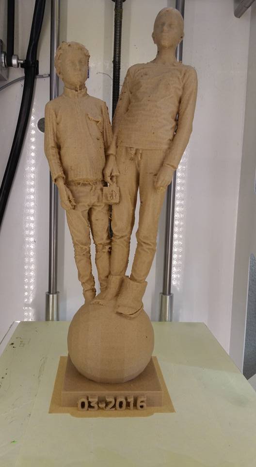

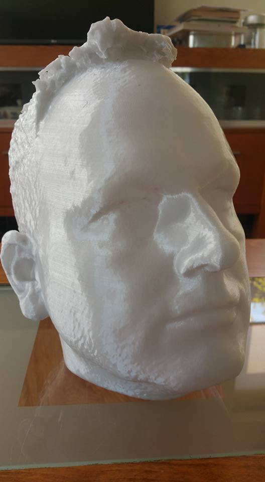

There is “reconstruct me”. I am using an Artec Eva . But this is to make precise custom fitted glasses. It is the best scanner available at the moment for this and it realy makes a precise copy in full scale. The Artec studio can work with sense scanners I think. Also multiple. Myself I am building a robotic scan rig for full body scans. It will have 4 axis with the rotating platform included and take little space. Find my full scale PET printed head attached. And my kids printed in wood.
