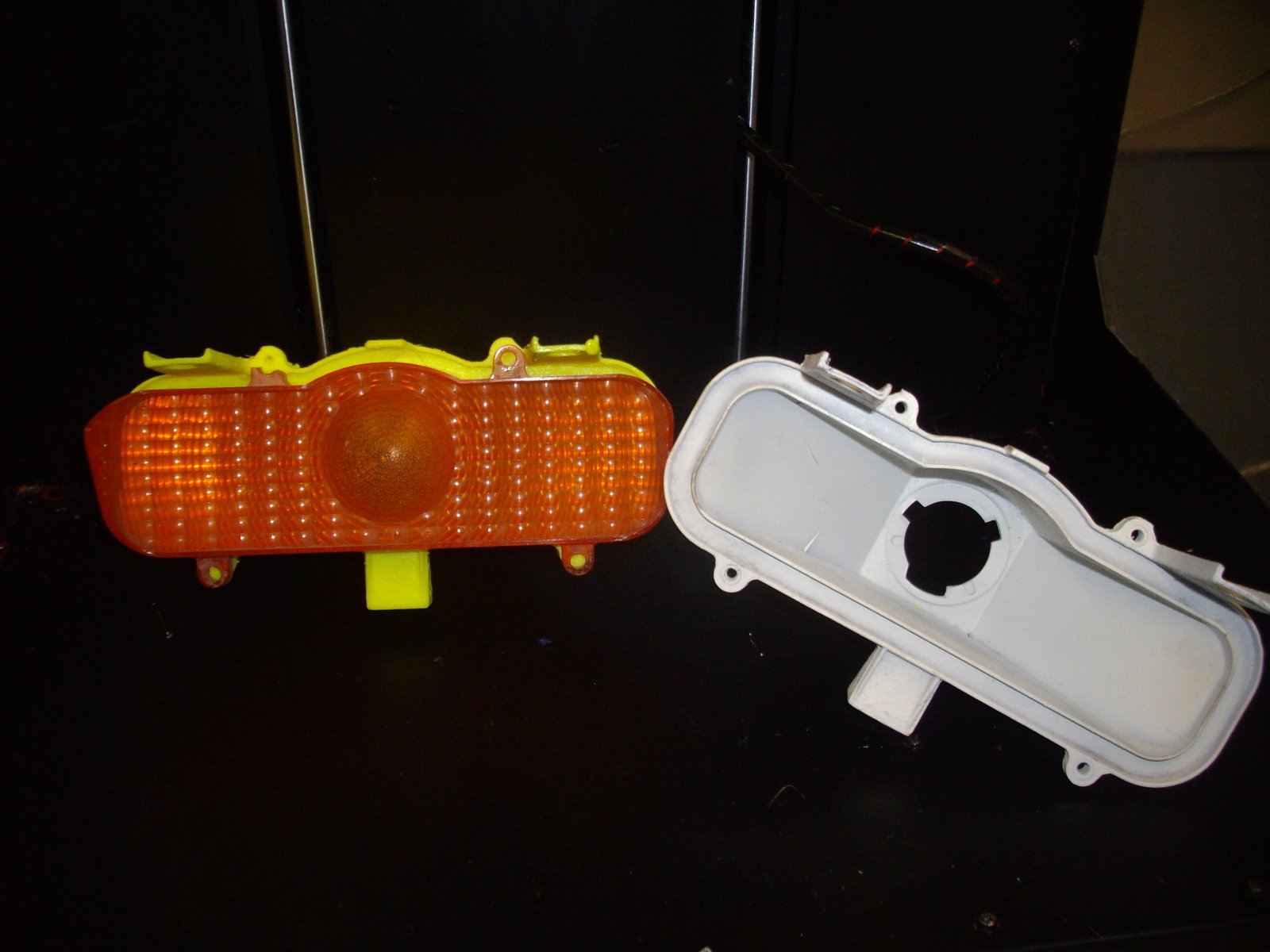

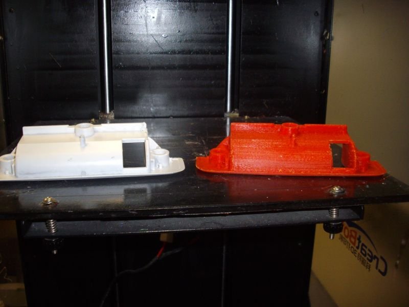

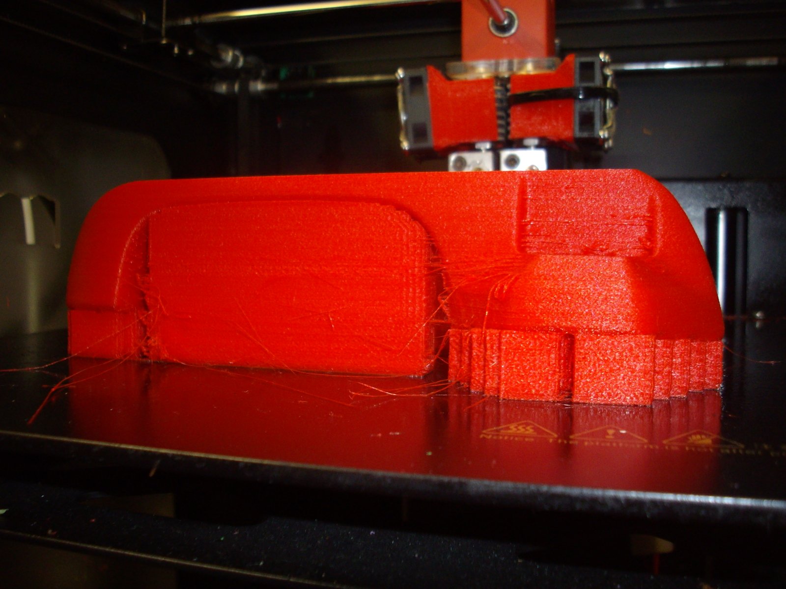

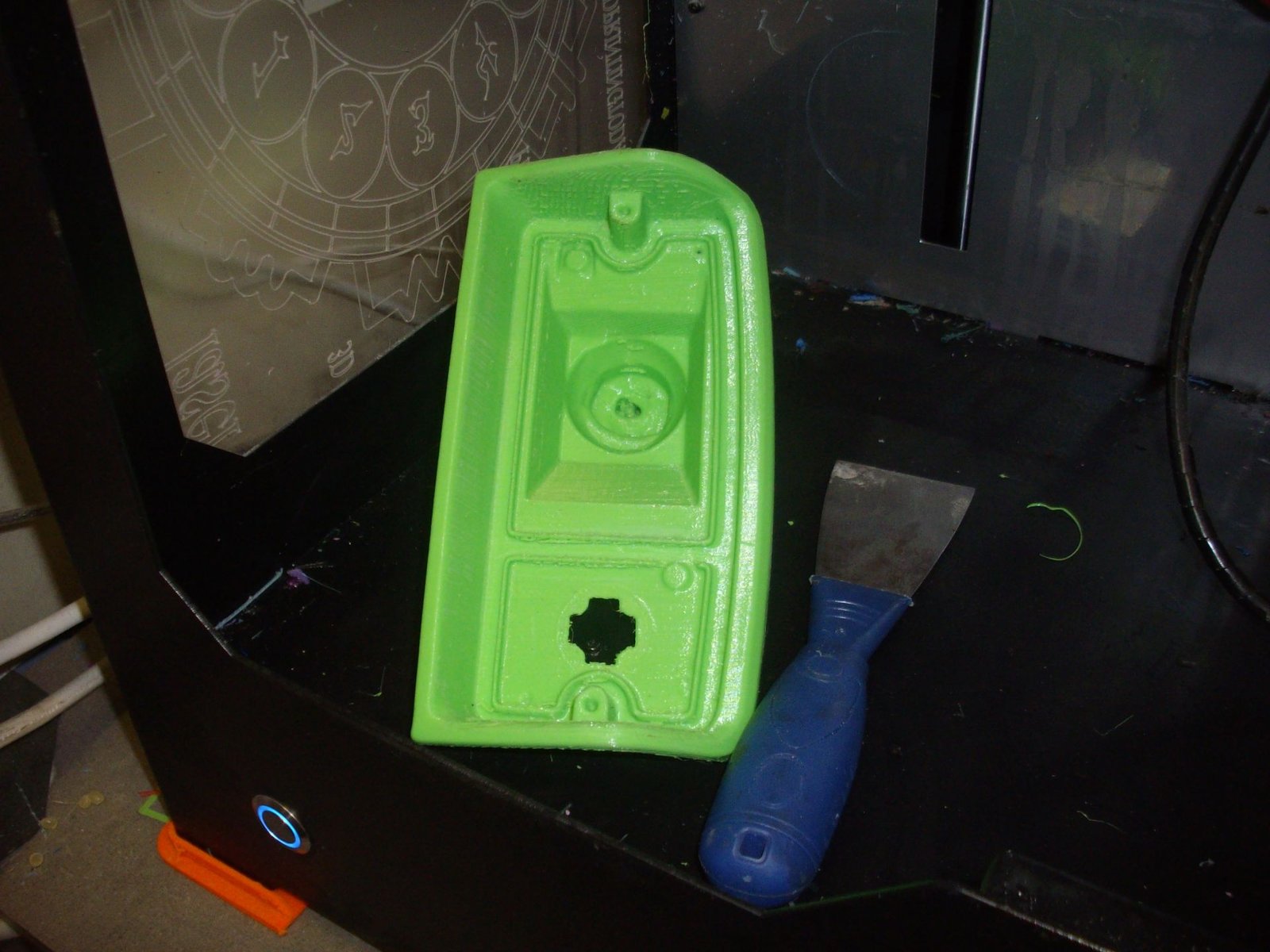

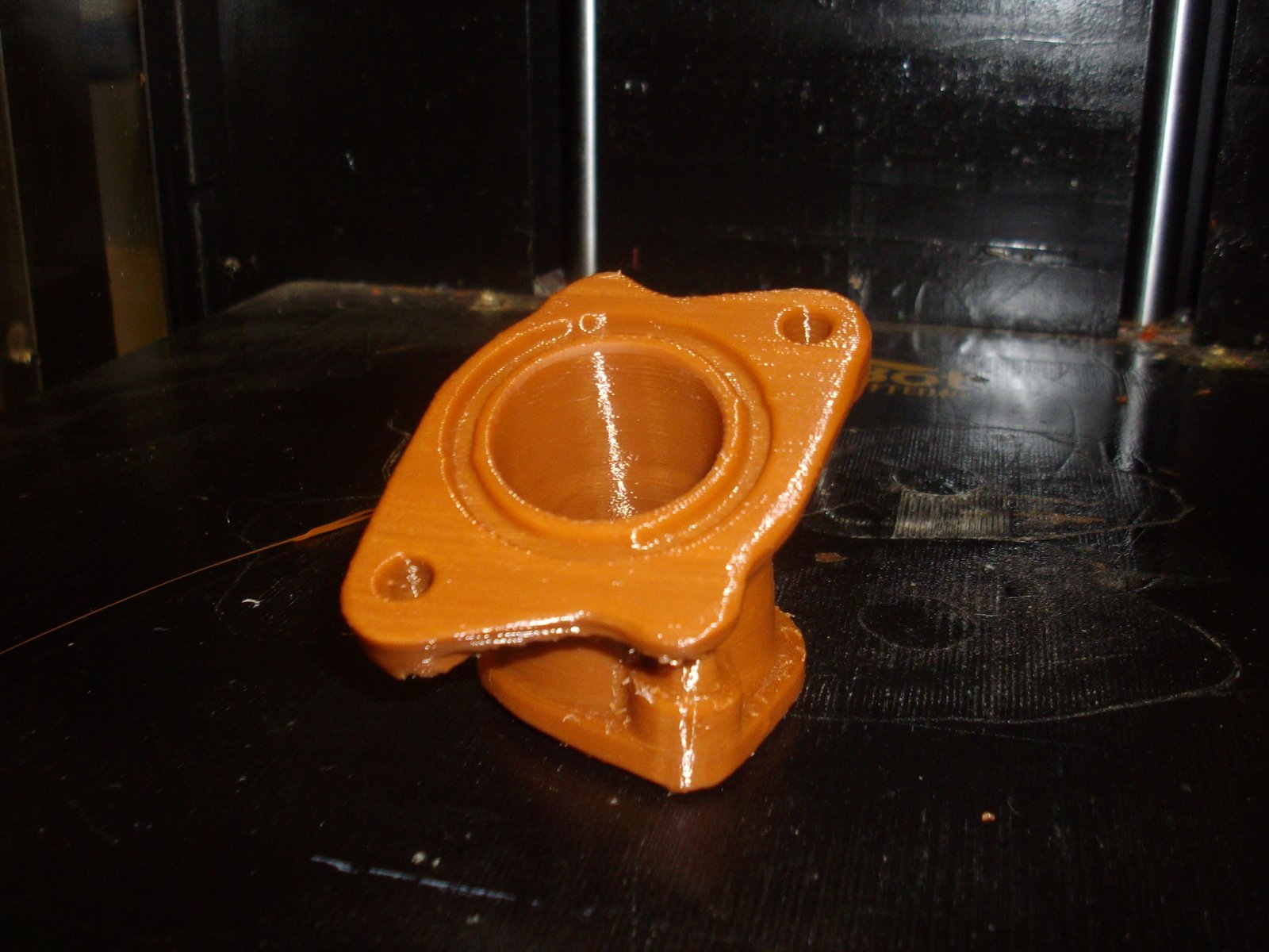

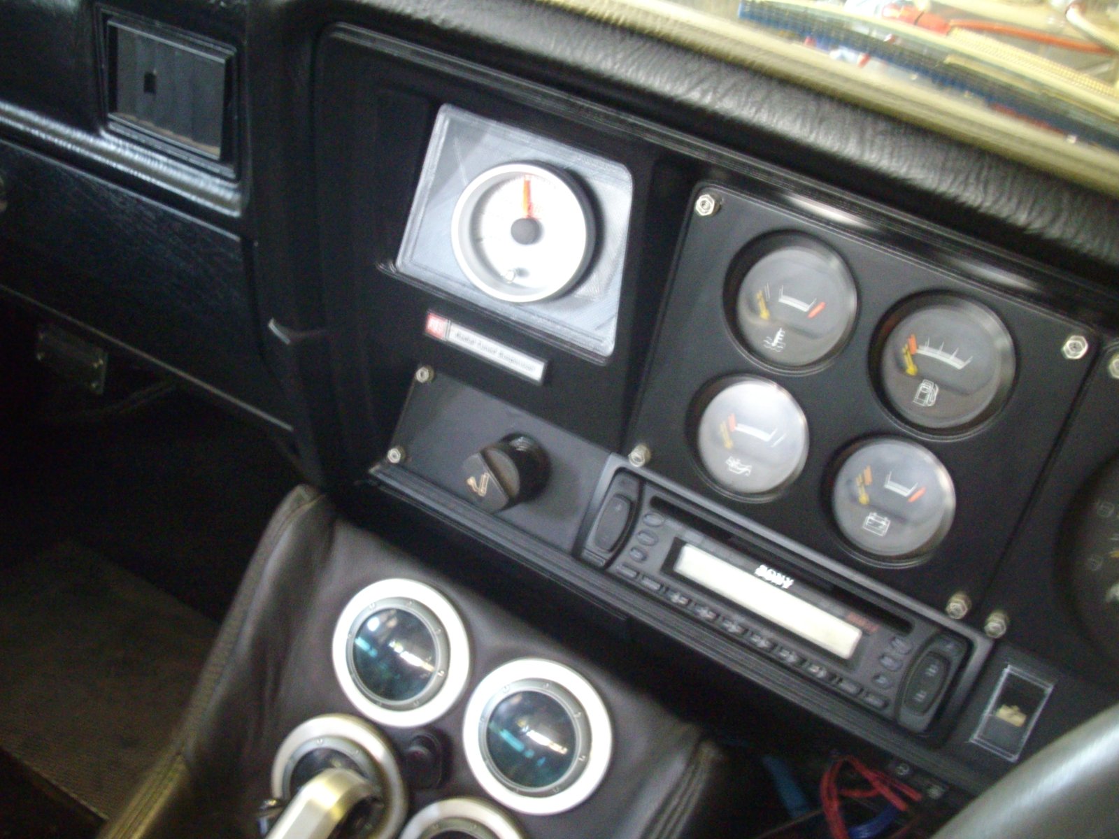

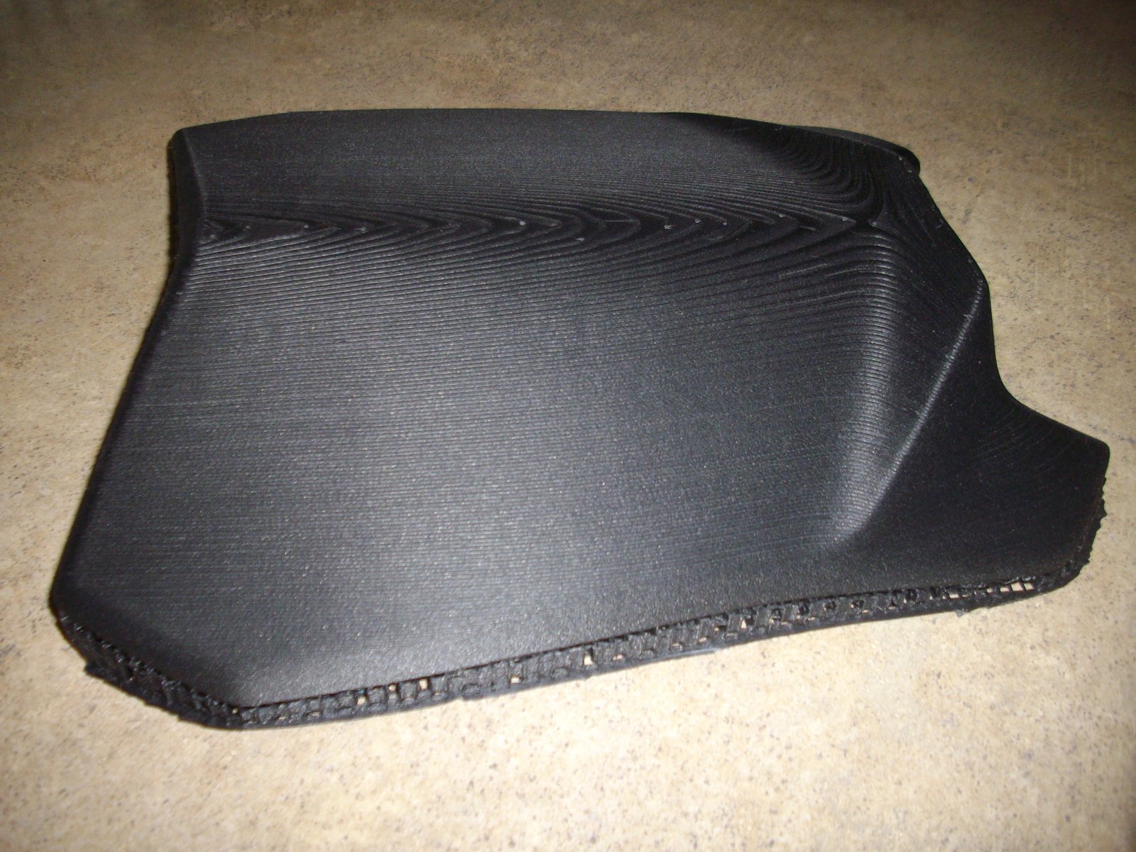

hi brandon 3dwise can offer you this service as we specialize in car part scanning and printing i have done some reproduction already i will include some jobs that i have scanned and printed with out to much clean up if the object has threads and deep cavitys that the scanner can not see i add them after the scan or i can draw it up from sample , i can offer you these parts in carbon fibre & t-glase , we also have paste extruder for silicon printing of objects this machine that does the paste extruding also does cnc male , female moulds for any metal pouring,this link will take you to my other website where you can see dozens of scanned car parts that we have printed , http://3dprintingtoday.com.au/member-2014.asp?MemberID=3886 the black object is a carbon fibre print for a race bike that we just done , if you need any more info please contact me rick 3dwise

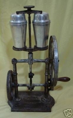

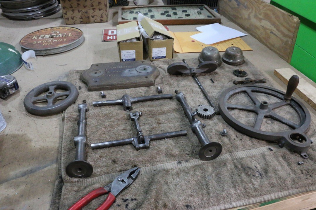

Wow !! everyone is VERY helpful. I have an antique manually operated machine that is 110 years old. It is very simple in nature, but very rare to find in reality. I’m considering reviving it from oblivion to ultimately have parts re-cast. The first step in this is to re-engineer from actual parts. I don’t need automotive level precision as these parts are far from that level of control. I will basically need the shapes externally measured (as there is no real interior or voids) in these original castings. A friend of mine and myself can refine the scans to reflect any post-casting machining. We’re just looking to have a good exterior solid object to start with.
It is made up of ~12-14 simple parts as seen in the images. One image is assembled, the other is of the broken down components. unit total steel weight is about 20 pounds and 18" tall. But as you can see the individual parts are not that big. I believe a DXF file would work best or iges. After we refine the solid model I may return to 3D forums (or the scanner) to make a print of all the parts for me to test assemble. At that point I have to move to a funding phase for evaluating casting.

Hi, thanks for responding and your insight. Parts are mechanical not organic. I posted images of them in the thread. Let me know. thanks.
afternoon ! I assume you’re in the Baltimore region from your link. I work in Hagerstown, so not far away. I posted images of the parts in the thread. Its mechanical and not organic so not sure scanning is ideal vs simply redrawing them in, say, ProE or some other 3D drawing package. thoughts? I’m thinking about modeling, then printing to prototype… then “maybe” casting.
Like a poster already commented…scanning is for organic or complex shapes and surfaces. The true and proper path is to bring the scan into a 3D model tool like SOLIDWORKS to convert it to editable geometry. Your parts that I see can be reverse engineered with verniers and a scale rather easily. I do that type of work all day long. What defines a complex shape or surface? A turbine blade would be a good example. Or perhaps a fender from a car. I think you get the point by now. Good luck and let us know how you make out here on 3D Hubs.
