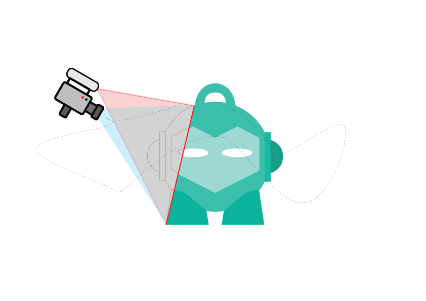

The Scanning Method
As you need to scan an object from all sides and angles, there’s basically 2 things you can do; you can either spin the object and take pictures from one standpoint, or walk around the object itself and take pictures from all sides.
When walking around with a camera - you need to make sure to take pictures of the whole object (for it not to have any unknown “gaps”). Be careful not to cast shadows on it as well. Try to keep a constant distance between your camera and the object to scan. Another tip, discard all blurry photos, the post processing software won’t be able to correctly stitch them.
If you have a portable laser scanner, the best method is to apply a wave motion - going up and down with the scanner, to capture the whole body, especially the top and the complicated places like under the chin (when scanning a person). Applying the wave motion gives you a good spectrum of reflection which gives you a better image result. Move slowly.
