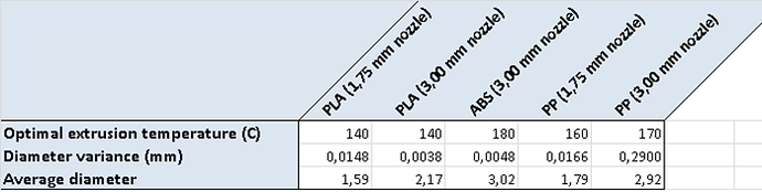

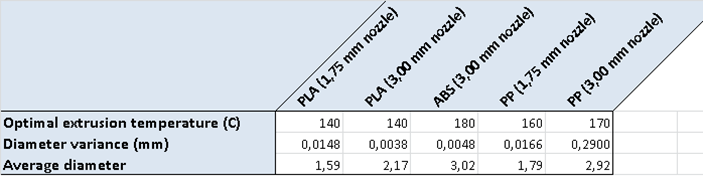

I used Colorfabb’s PLA pellets and this went quite well. Last time I didn’t manage to get the diameter of the extruded filament the correct size. This time I did however get very acceptable results for extruding at 140 Celsius.
Then the PP:
Last week I was only able to print a small part of the PP filament because most of it was too thick. So this week I set out to improve the diameter accuracy and consistency of the filament. Although I haven’t been able to test it on our printers yet, I am quite confident to say that with an average diameter of 1,79 mm and 2,92 mm I did quite well.
All of the results so far are listed in the table shown below.

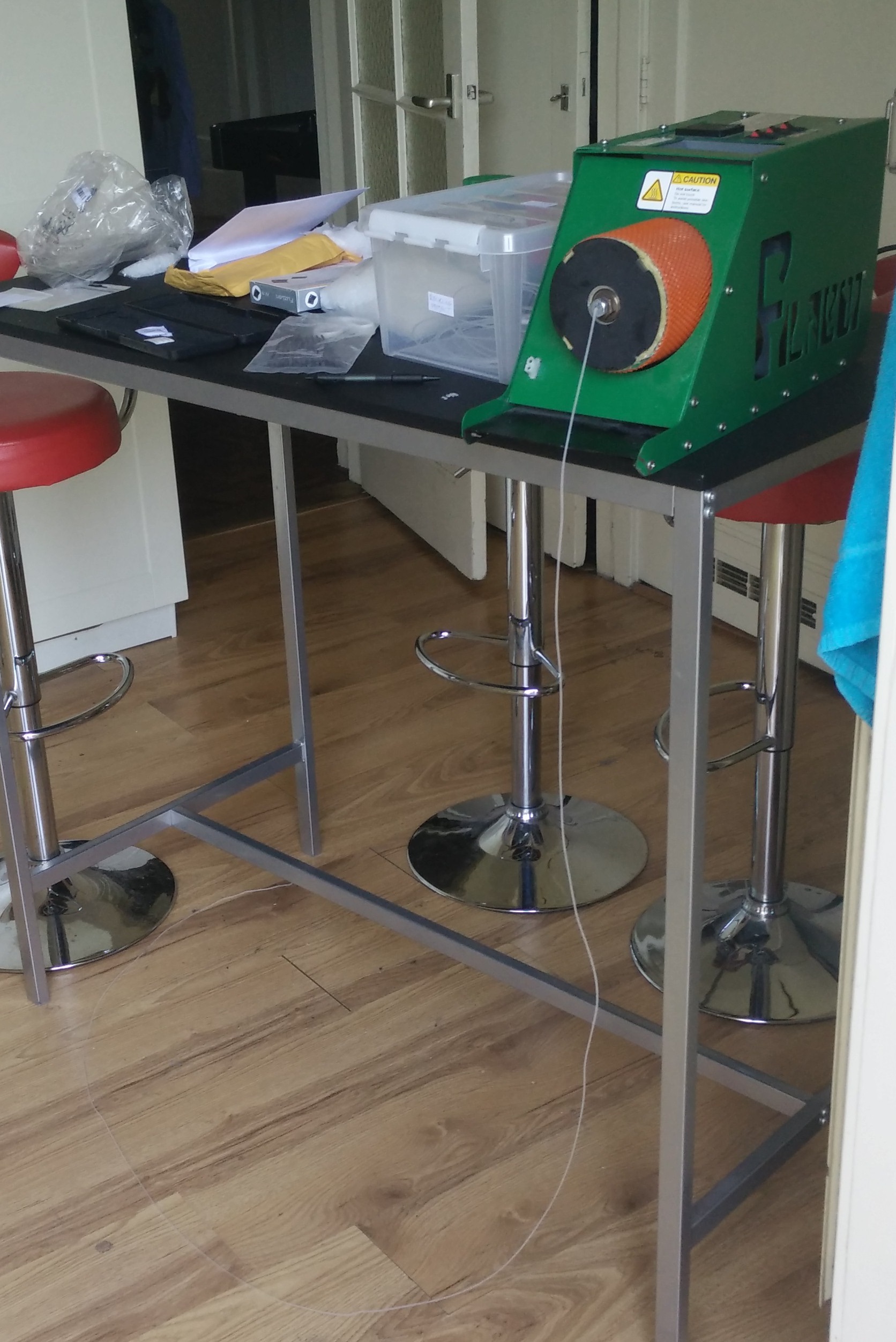

  • Using a Filabot original
  • Let filament drop to the ground from 1,20m
  • In a ventilated room
A point that needs to be made is that in this setup by letting the filament drop the filament stretches based on the amount of pull from the already extruded filament. This influences the diameter variance so one thing we will be looking at soon is how to minimize this effect.

Would something like just placing a bowl right next to the Filabot extruder help to solve the issue? So that the filament simply rolls up in the bowl instead of pulling and stretching it? Or is it too hot in there?
