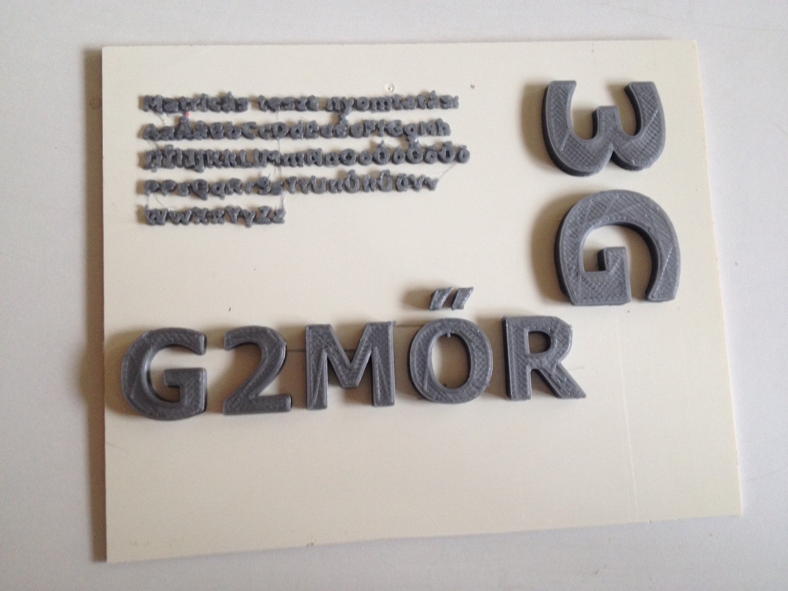

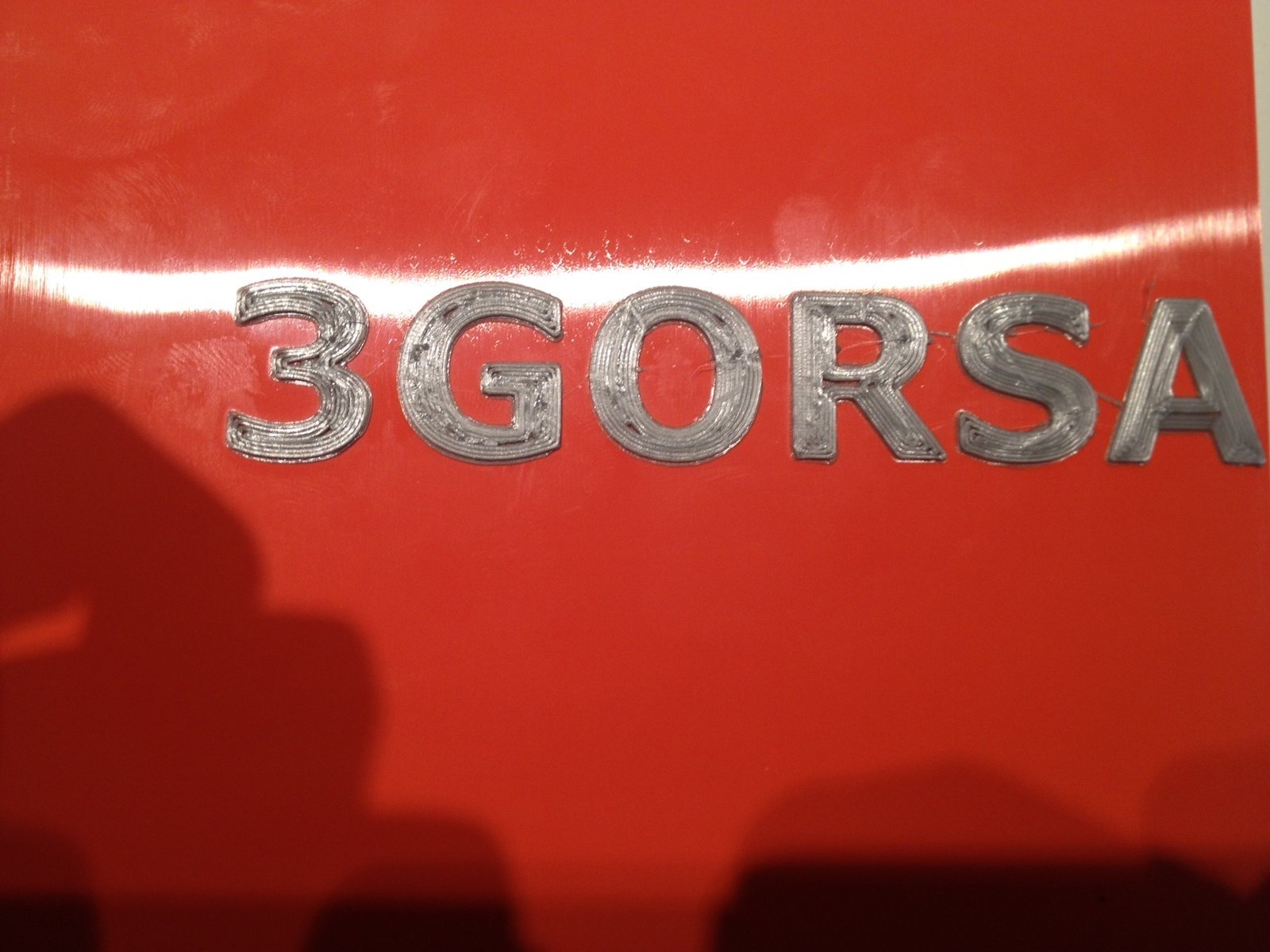

I made some tests 2.5 years ago for a company with ABS and PLA to a sample PP sheet and worked great. You had to really flex the sheet to remove the letters from it. PLA worked better, it stick much better to the PP sheet. The first layer height is critical you have to push in the head to the sheet a little bit (carve it basically) for the best adhesion.
PP is Polypropylene. The company whom I was making these tests are making signs. They provided the test material.
I would suggest to search a company with similar profile in your area and ask them if they have some left over sheets.
(The good thing is even your print come off for any reason from the sheet, you can glue it back as the print leave a mark on it)
