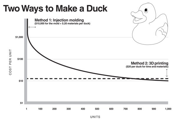

That is a good question. I can tell you right off the bat that 5000 units is not practical to produce using 3D printing. I have attached a popular graph (source: 3dprinting.com) that customers like to look at when asking this question. The difference here is that the calculation assumes you have both an injection moulding machine and a 3D printer already at hand and you are comparing both processes. Injection moulding requires a mould which you amortise by producing large amounts. Hence price per unit goes down. 3D printing is tool-less so the price per unit is always the same.
The intersection of the two graphs is the magic number where 3D printing would make sense if it is under that volume. In this example, 750 ducks is the intersection point. Which means if I were to produce 600 ducks it would be cheaper to 3D print, of course, a longer production time is usually the problem here. There is, of course, the option to outsource the printing to different hubs but it will be costly for large amounts.
